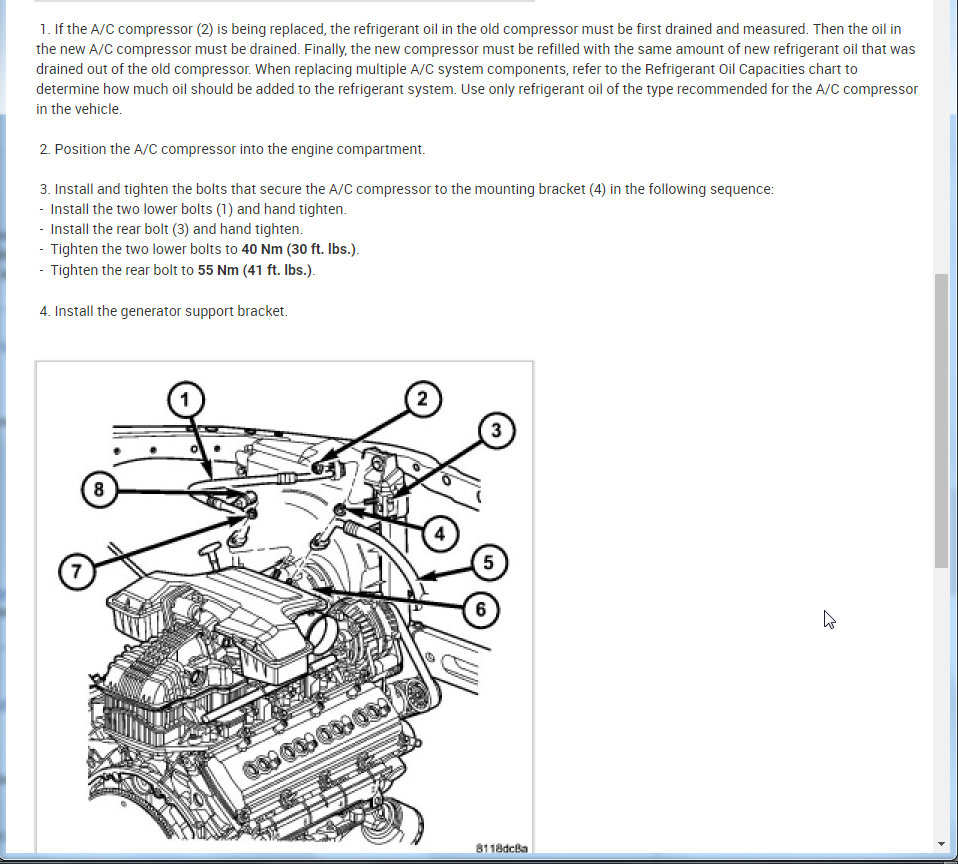

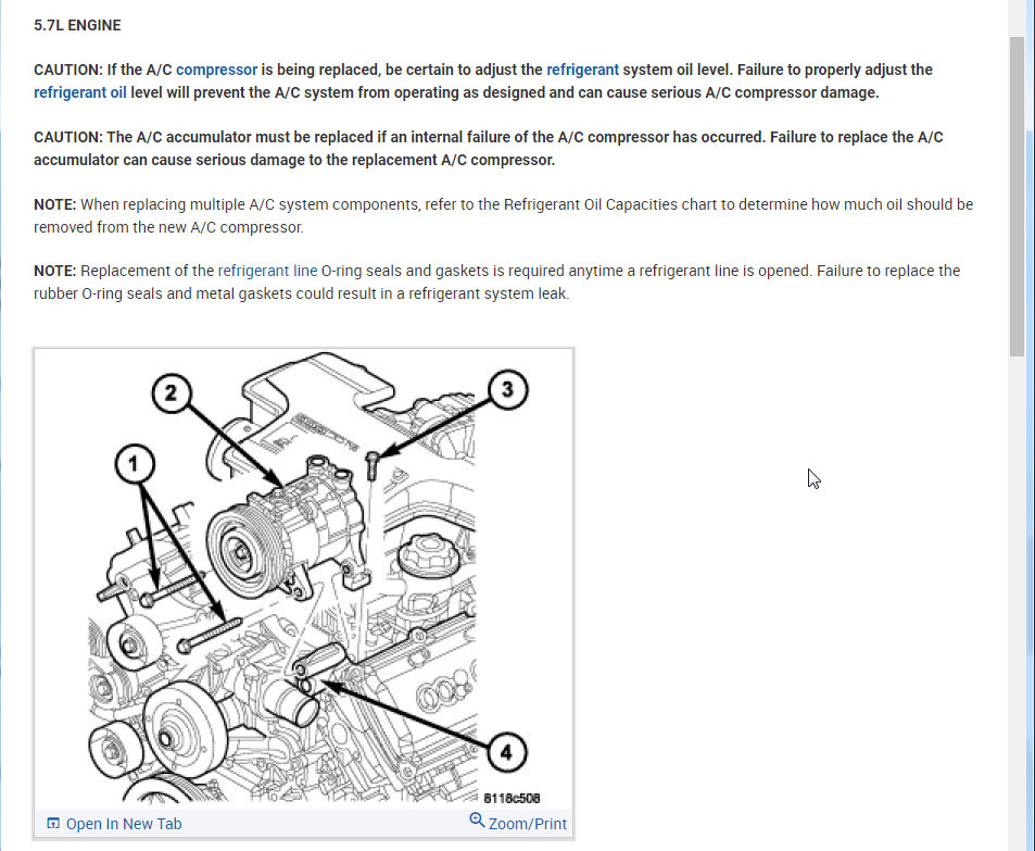

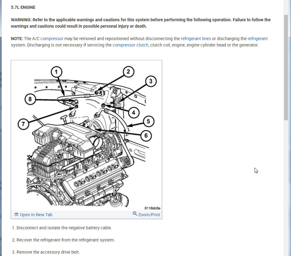

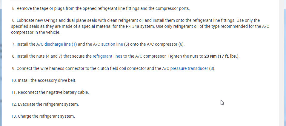

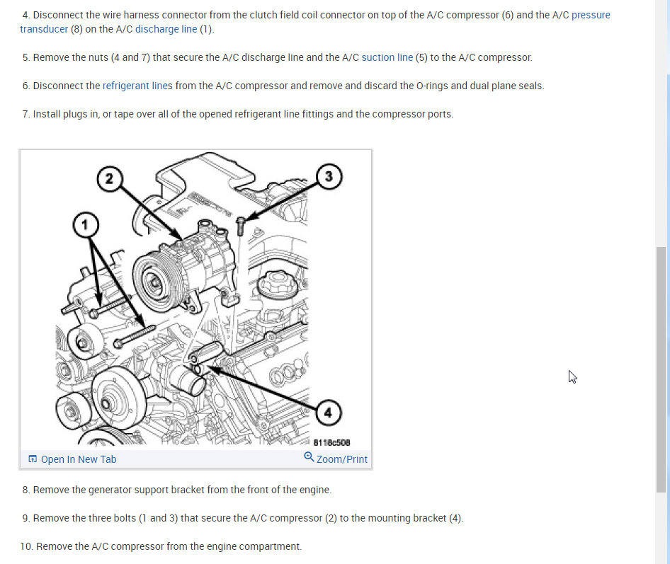

He could be correct but the way to find out for sure let's run through this information. If we have other items that point to the compressor then that will just be more proof.
https://www.2carpros.com/articles/replace-air-conditioner-compressor
I suspect you will find the pressures low or not correct and the added vibration will indicate you either have a clutch that is slipping on the compressor or the compressor has become unbalanced.
Unfortunately he should have gone to this first but again he is most likely correct.
I attached the info below on how to replace the compressor. Let us know if you have questions. Thanks
