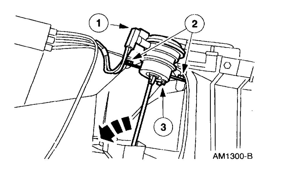

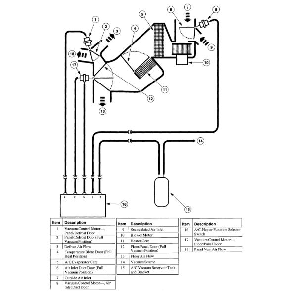

A/C will blow cool air for about ten minutes then the vent will close for about five minutes. I changed the vacuum pump and it still does it.
Jun 22, 2018 at 11:36 AM
Good morning.
Do any of the other doors close when this door closes?
I attached a vacuum chart for you. It may be the vacuum motor itself.
The motor is behind the glove box. Make sure it has vacuum to it to work.
