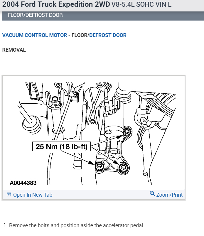

A/C doesn't blow out air on dashboard vents.
Jul 21, 2019 at 3:23 AM
  • 55,732 POSTS

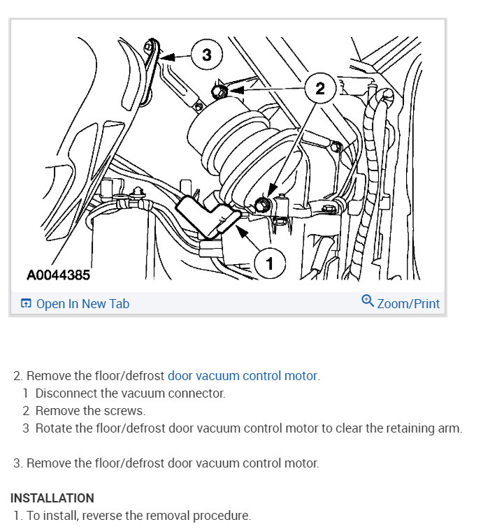

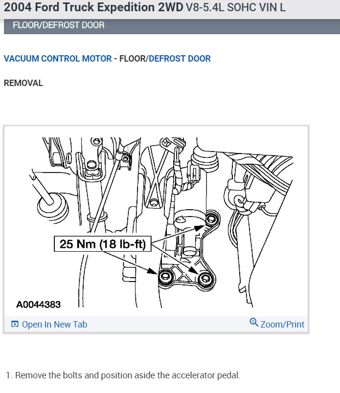

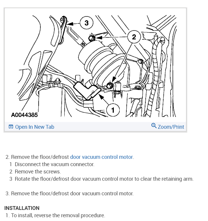

This sounds like you have a mode blend door actuator that is not working due to lack of vacuum probably a broken vacuum line here is a guide to walk you through the repair with diagrams and instructions to show you how on your car below.
https://www.2carpros.com/articles/air-vents-stay-in-the-defrost-position
Check out the diagrams (Below). Please let us know what you find. We are interested to see what it is.
