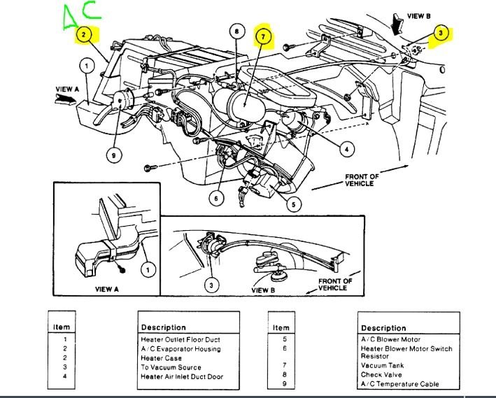

I'm near Pittsburgh, so I have no contacts there. I'm sorry. However, in my mind, I can't see how anything would freeze up and cause the airflow to change directions. I attached a pic below. I wrote AC next to where the evaporator housing is located. That is where the cold air comes from. I can't see where something would cause this by freezing.
Also, I do have some other questions. The system is operated from engine vacuum. Do you ever notice a change when the engine is under a load as far as air flow direction? Also, do you run the AC on recirculate all the time?
In addition, I highlighted a couple other things. The vacuum supply hose and the vacuum tank. If enough vacuum isn't provided because of a leak, that can cause air flow to change. If you are in the middle of two different settings, you will notice a decrease in flow.
