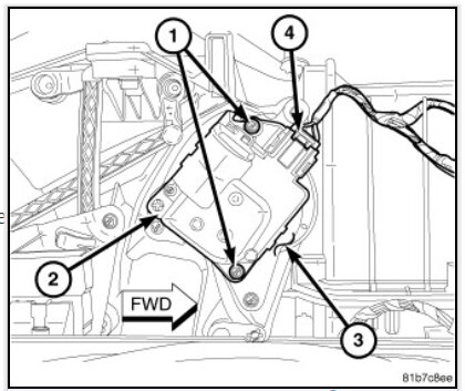

The AC only blows cold on the driver's side. The pushing of buttons to do a reset proved no help.
Jun 6, 2026 at 1:05 PM
  • 55,694 POSTS

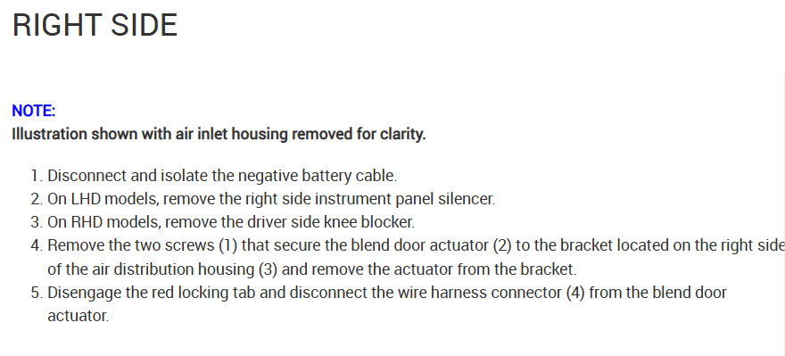

Yep, you can try a HVAC reboot but most of the time the blend door actuator on the passengers side will be bad and needs replacement. Here is a guide to help you reset the system and the location of the actuator as well.
https://www.2carpros.com/articles/step-by-step-guide-to-reset-your-cars-hvac-system-an-essential-for-every/
Check out the images (below). Please let me know what happens.
