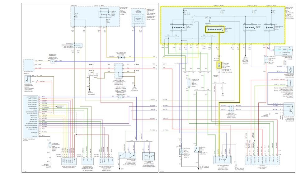

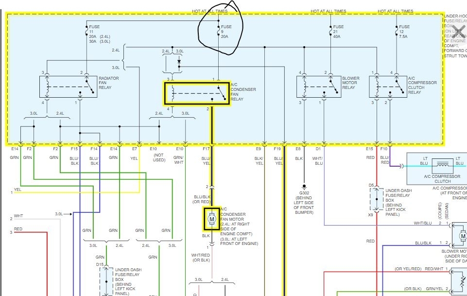

My uncle had overcharged the system and now failed. I had vacuumed, replaced the low/high pressure sensor, relays and recharged. compressor does not engage. I have no power going through the cable to the compressor. I ran a jump wire from battery to the cable to compressor and didn't seem to click. Not sure what else i could try. It ran awesome before until it was overcharged. I checked the DTC self check on the radio control panel and came up with K and O problems also.
Aug 31, 2019 at 2:24 AM
Good morning,
Even with it overcharged, there are safety features built into the system from damaging the components.
How much voltage is at the wire to the compressor with it on?
I will attach a wiring diagram for you to follow for the system.

I checked it out with a light tester. i dont have a voltage meter. I did try to jump it from direct battery and no click sound. Am i supposed to add a ground also to the compressor? all i did was use a power wire.
Aug 25, 2020 at 6:20 AM
Is it a 2 wire connector or 1 wire?
If it is 1 wire, no ground needed.

it is a 1 wire. i put the light tester to it. but nothing. i got a get a voltage meter. all fans come on when A/C button is pressed.
Aug 25, 2020 at 6:21 AM
Check the fuse I circled in the diagram for power on both sides with the key on.

All fuses, relays are good.
NPOLCHES82
  • 6 POSTS
When I hit the A/C button. Cars rpm's dropped a little like it wants to engage. But nothing.
So the compressor did not engage when you jumped it? If that is true then you have a failed compressor.
NPOLCHES82
  • 6 POSTS
Yes, I took a power cable from battery to the wire from compressor and nothing.
Okay, you have a failed compressor.

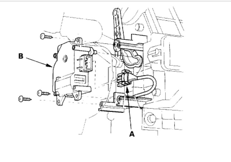

KHLOW2008
  • 41,814 POSTS
Hi don-harriet,

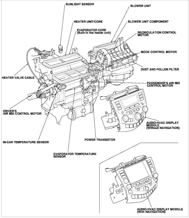

It sounds like one of the blend door actuators is not closing completely.
Here is a guide that will show you what you are in for when replacing them and testing the air door operation:
After going through the data provided, I suspect the air mix door to be stuck in driver side or is leaking.
Here are the blend door locations: Mix, Mode and recirculation.
Cheers
Dec 17, 2020 at 2:21 AM (Merged)

KHLOW2008
  • 41,814 POSTS
Yes, the motor controls the air mix door.
There are sponges to act as seals and this could be worn causing the cool air to be heated up when travelling to the air vent.

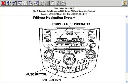

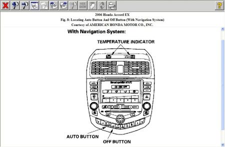

Honda has a self diagnostic built in the climate control system but I do not know if it works for your model
1. Turn ignition switch on.
2. Turn AC on in Auto mode.
3. Wait for 1 minute on temp display at 18 degrees.
4. Push AUTO and OFF together.
5. If any indicator lights are showing on the control panel, something is wrong, let me know what it is and I will try to get the answer.

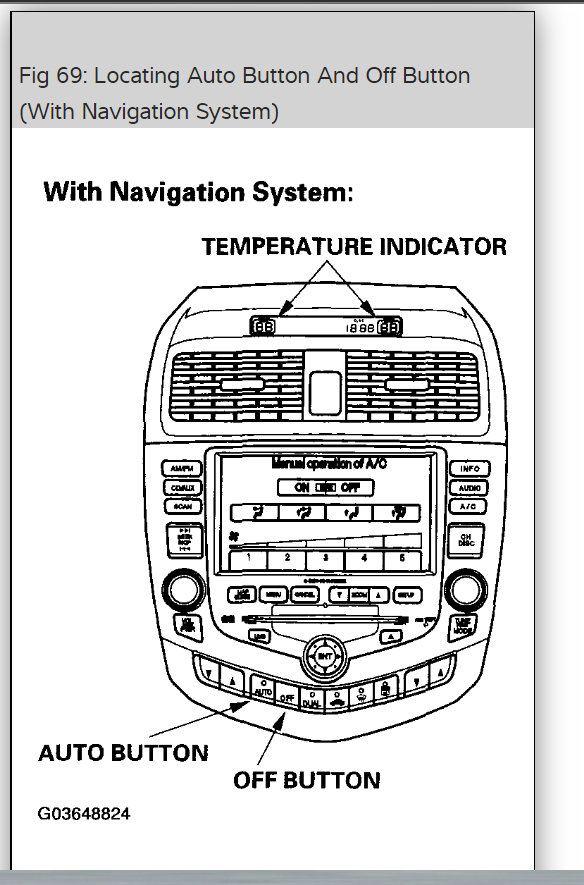

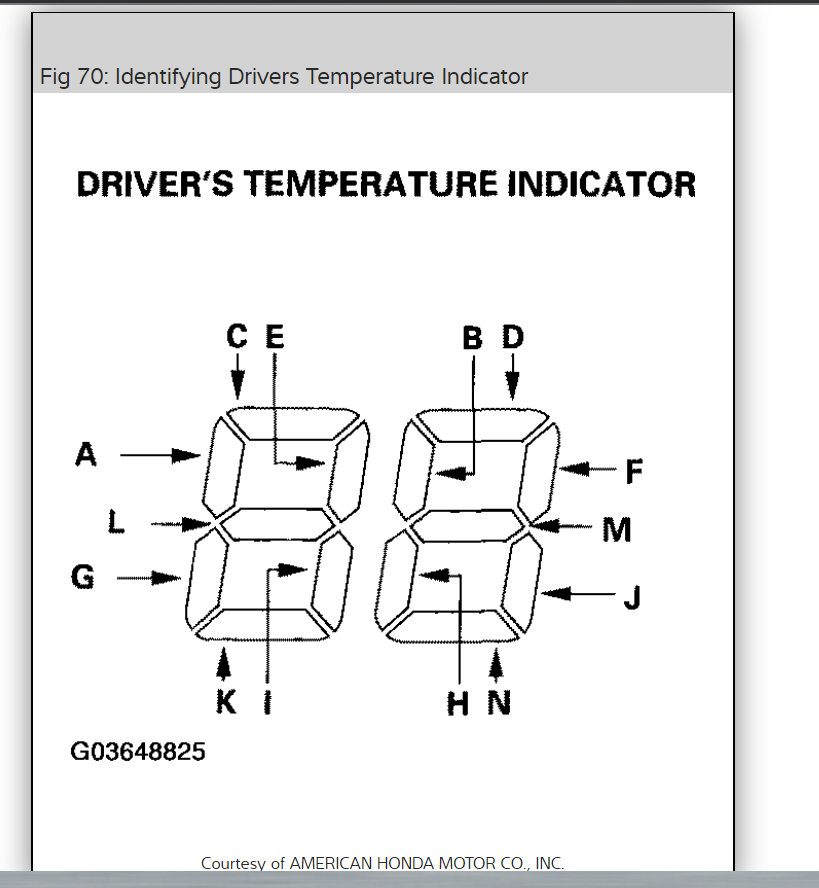

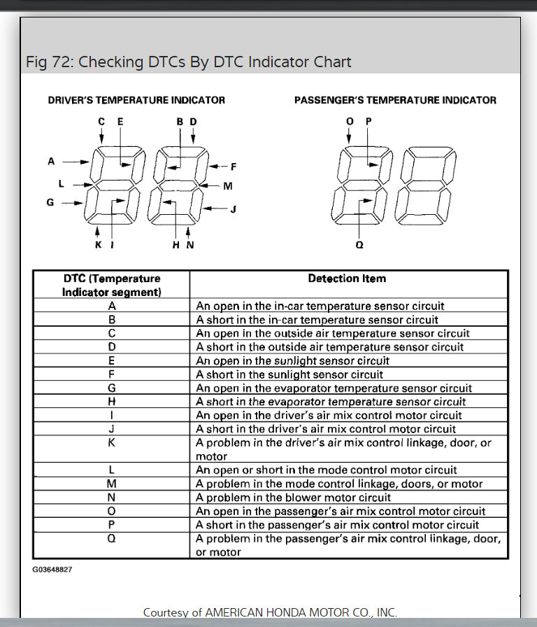

KHLOW2008
  • 41,814 POSTS

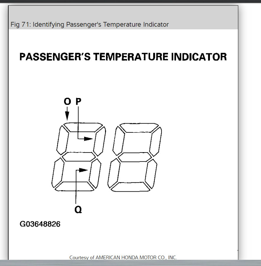

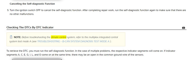

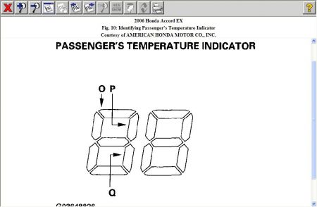

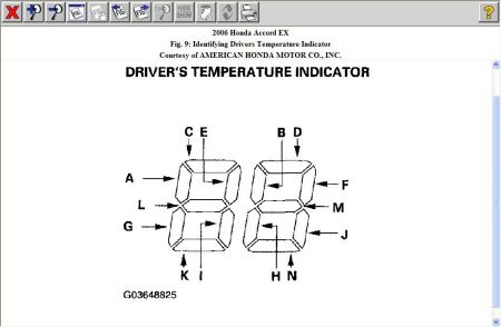

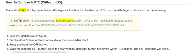

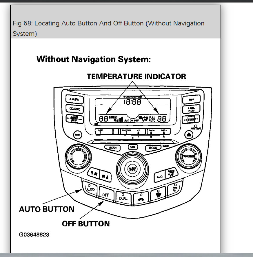

Hi don-harriet, Try disconnecting the battery negative terminal for ten seconds and try again. If it did not work, try this and see if there is anything on record. How to retrieve a dtc (without hds): The audio-HVAC display panel has a self-diagnosis function for climate control. To run the self- diagnosis function, do the following: 1. Turn the ignition switch ON (II). 2. Set the driver's temperature control dial or button on MAX Cool. 3. Press and hold the OFF button. 4. While holding the OFF button, press the rear window defogger button five times within 10 seconds. The self-diagnosis will begin. Locating Auto Button And Off Button (Without Navigation System) Courtesy of AMERICAN HONDA MOTOR CO., INC.
https://images.2carpros.com/forum/automotive_pictures/192750_HVACButton06Accord_1.jpg
Locating Auto Button And Off Button (With Navigation System) Courtesy of AMERICAN HONDA MOTOR CO., INC.
https://images.2carpros.com/forum/automotive_pictures/192750_HVACButton06Accord02_1.jpg

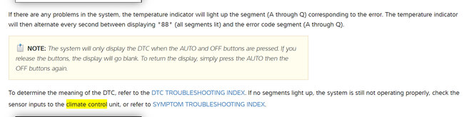

If there are any problems in the system, the temperature indicator will light up the segment (A through Q) corresponding to the error. The temperature indicator will then alternate every second between displaying "88" (all segments lit) and the error code segment (A through Q). NOTE: The system will only display the DTC when the AUTO and OFF buttons are pressed. If you release the buttons, the display will go blank. To return the display, simply press the AUTO then the OFF buttons again. If no segments light up, the system is still not operating properly, check the sensor inputs to the climate control unit, or refer to SYMPTOM TROUBLESHOOTING INDEX . Fig. 9: Identifying Drivers Temperature Indicator Courtesy of AMERICAN HONDA MOTOR CO., INC. Fig.
https://images.2carpros.com/forum/automotive_pictures/192750_HVACButton06Accord03_1.jpg
10: Identifying Passenger's Temperature Indicator Courtesy of AMERICAN HONDA MOTOR CO., INC.
https://images.2carpros.com/forum/automotive_pictures/192750_HVACButton06Accord04_1.jpg
Cancelling the Self-diagnostic Function 5. Turn the ignition switch OFF to cancel the self-diagnostic function. After completing repair work, run the self-diagnostic function again to make sure that there are no other malfunctions. Page 1 of 1 CLIMATE CONTROL (EXCEPT HYBRID & V6) -2006 Honda Accord EX 9/5/2008

DON-HARRIET
  • 5 POSTS
I got no DTC error codes following your instructions.
I disconnected the battery needed to enter the security code and reset the clock, but no change in the A/C.
I re-ran the DTC test - no errors again.
KHLOW2008
  • 41,814 POSTS
Hi again,
Looks like you have to check the control unit or the internal linkages for fault.

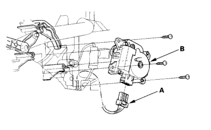

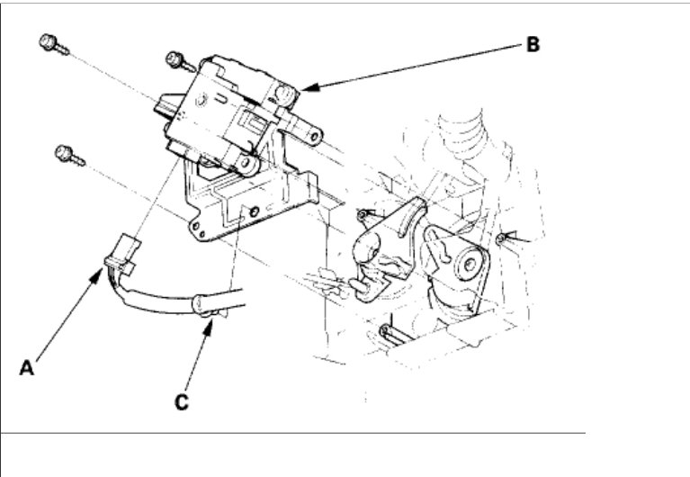

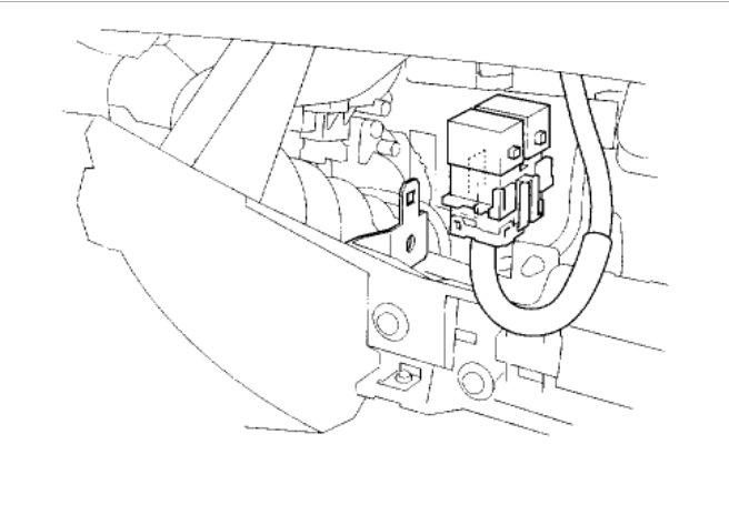

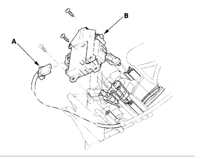

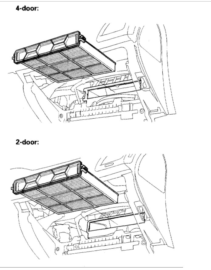

OLUSHOLA
Hello All. I guess this reply may be late. Nonetheless, I still want to give it all the same. I experienced the same problem with my 2006 Honda Accord EX-L four cylinder. When the AC was on, the passenger output was cold while the driver's side was hot. I confirmed that the air mix control motor was working correctly. Then, I removed the cabin filter under the glove box and I found it very dirty. I cleaned this filter and topped up the refrigerant. Now the problem is solved. In case you have this same problem, you may wish to try this simple solution. Thanks.
  • 55,224 POSTS
Great addition to this thread! Please feel free to help out whenever you are on the site :)
Here is the way to change the cabin air filter, this will give you an idea:
https://www.2carpros.com/articles/how-to-change-an-air-cabin-filter
This is how it is done on your car (below).

SCGRANTURISMO
  • 4,897 POSTS
Have you checked your climate control display for any Heating Ventilation Air Conditioning (HVAC) Direct Trouble Codes (DTC)(s) yet? I have included the directions for pulling them up in the diagrams down below. Please go through the guide and get back to us with what you are able to find out.
