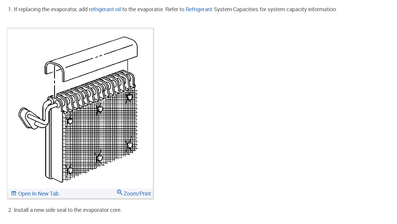

How to replace my Evaporator and Thermal Expansion Valve?

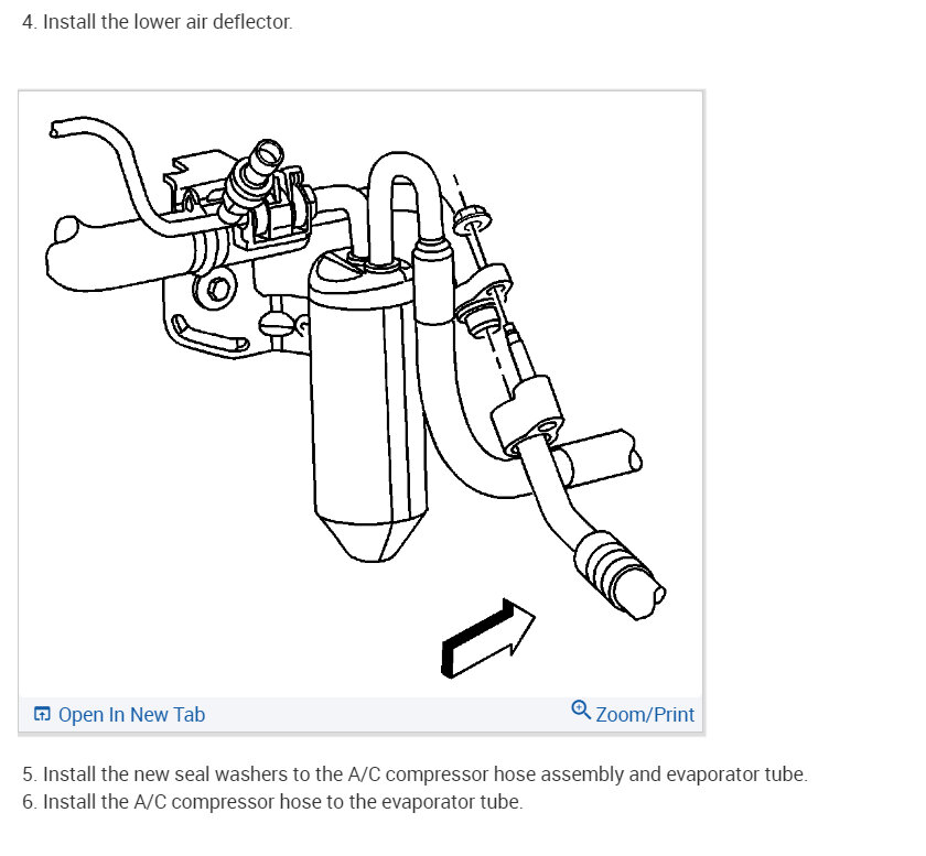

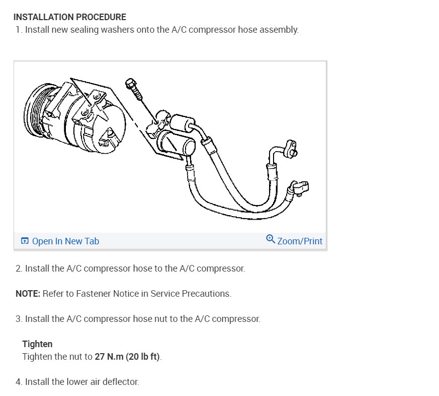

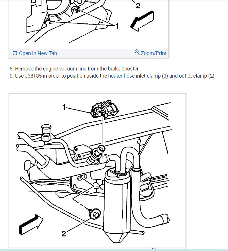

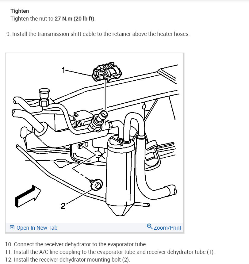

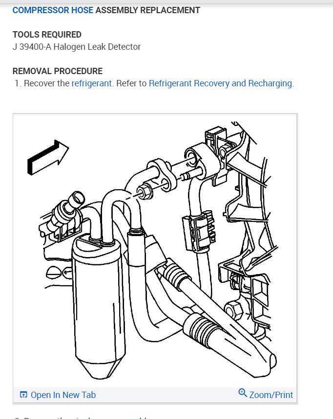

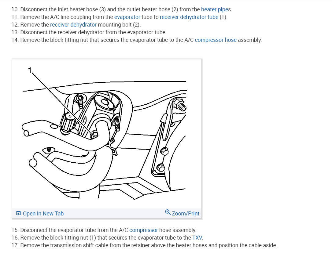

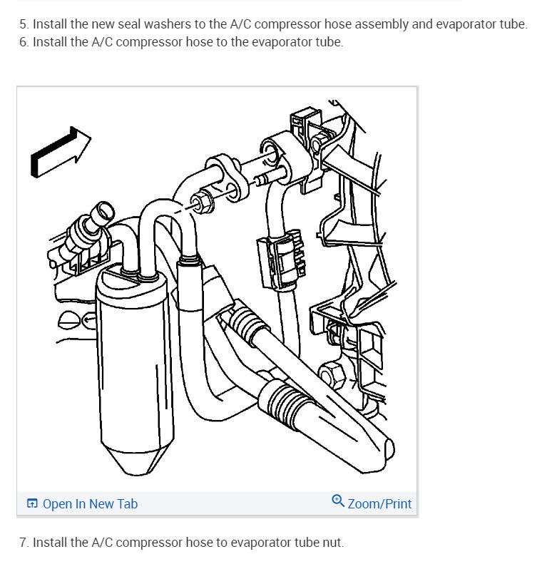

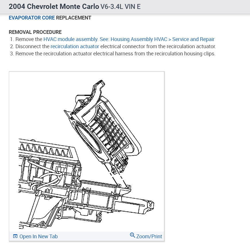

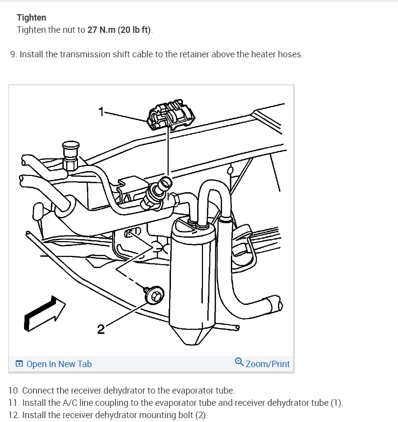

The car listed above is an LS? Also, how to replace the entire A/C Hose assembly?
Jan 5, 2023 at 11:50 AM
  • 55,707 POSTS

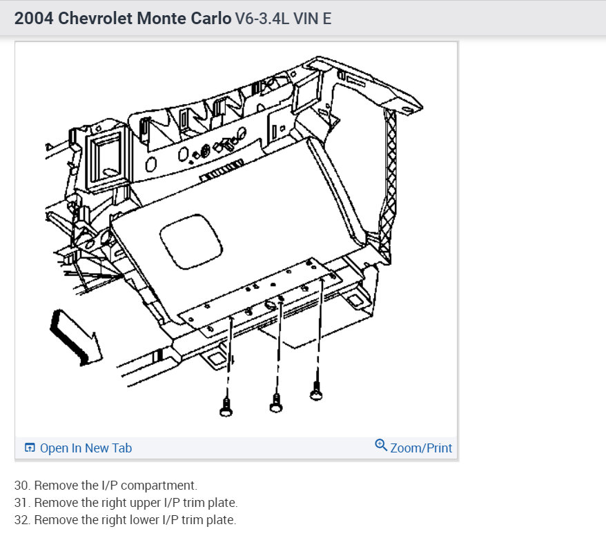

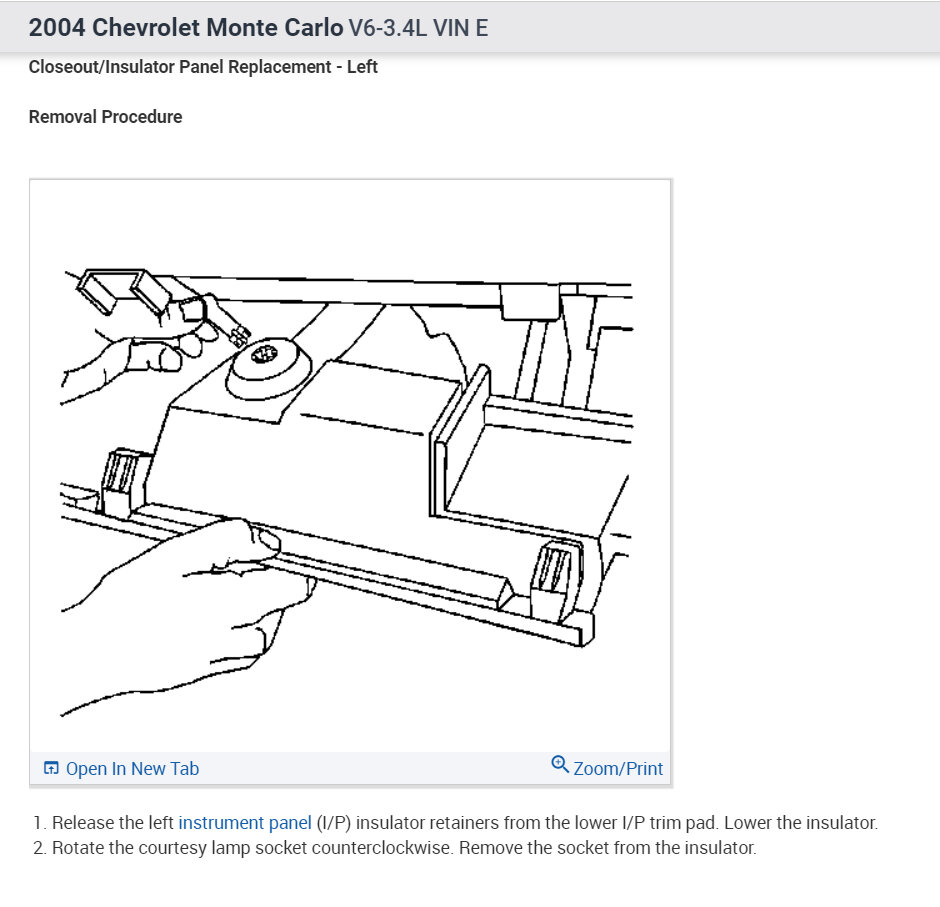

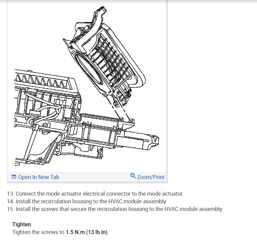

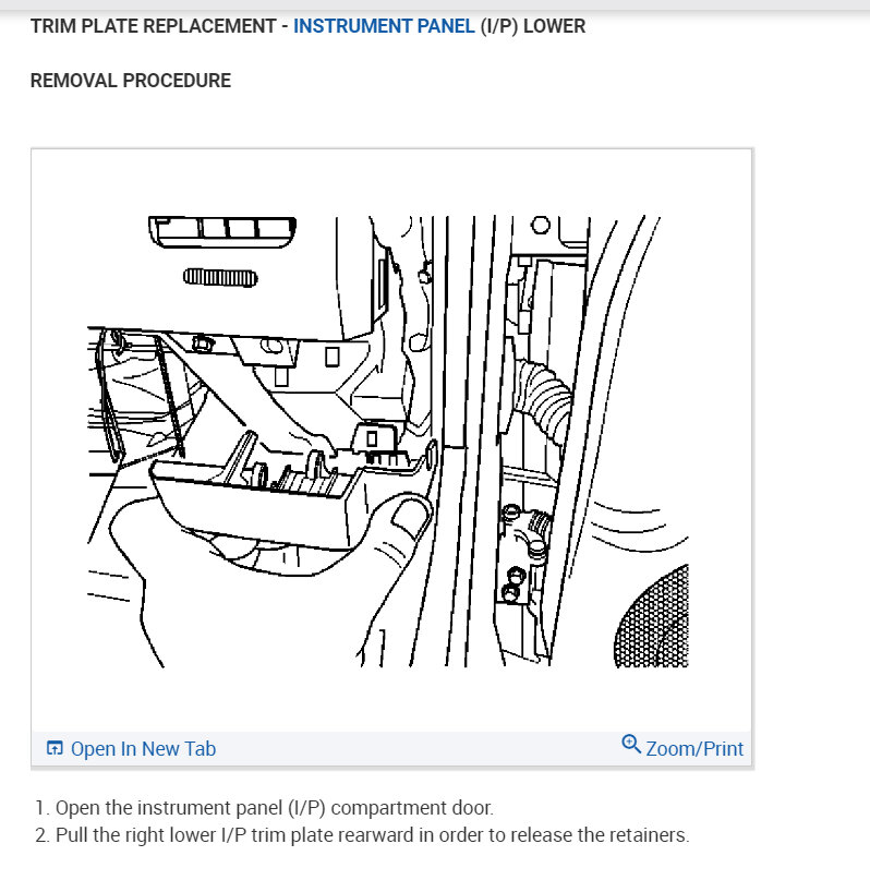

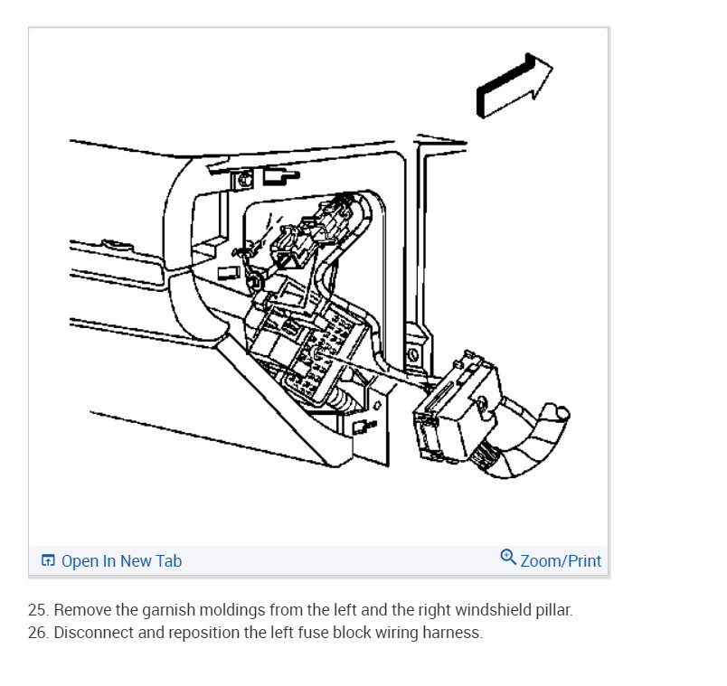

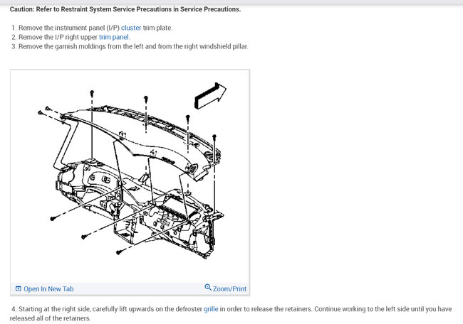

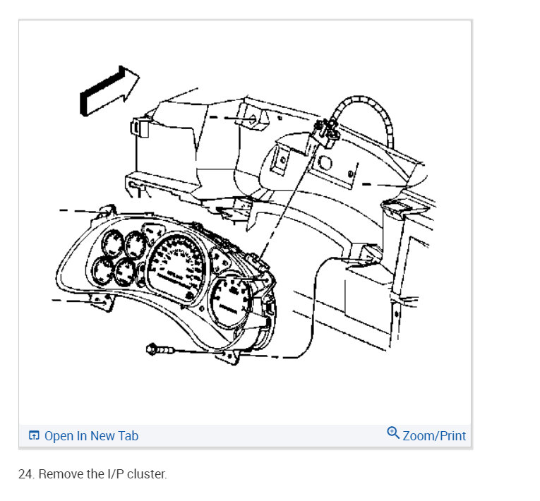

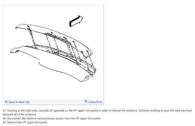

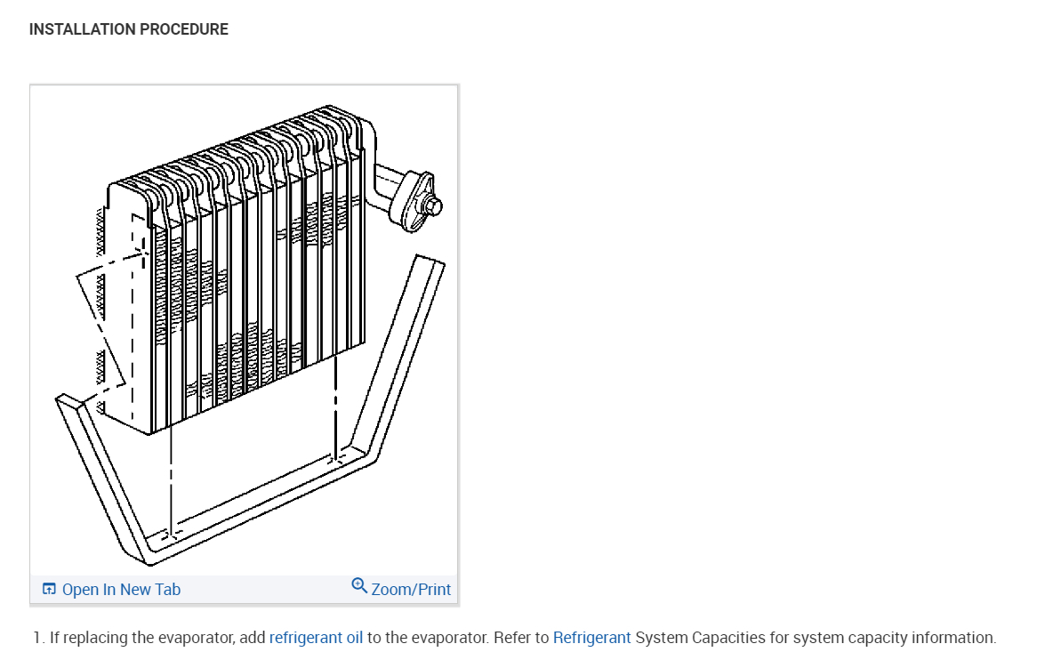

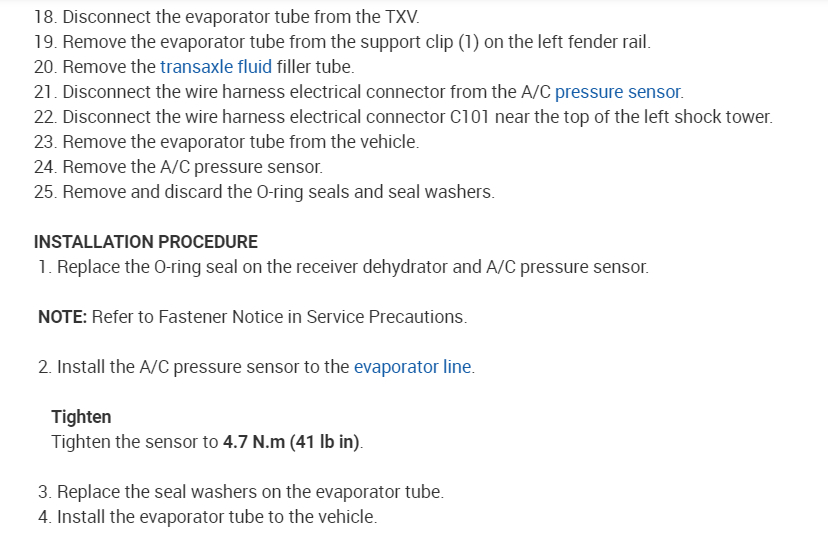

The first thing you need to do is vacuum down the system which this video will show you how to do. Next you will need to remove the dashboard which sounds harder than it is, I will include the instructions for that in the post below this one because it will be too long in one post.
https://youtu.be/4EqdrBVb0sY

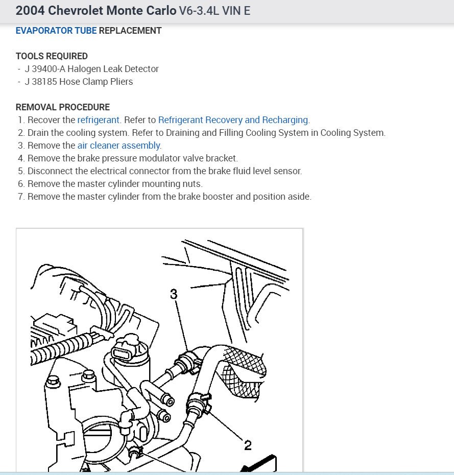

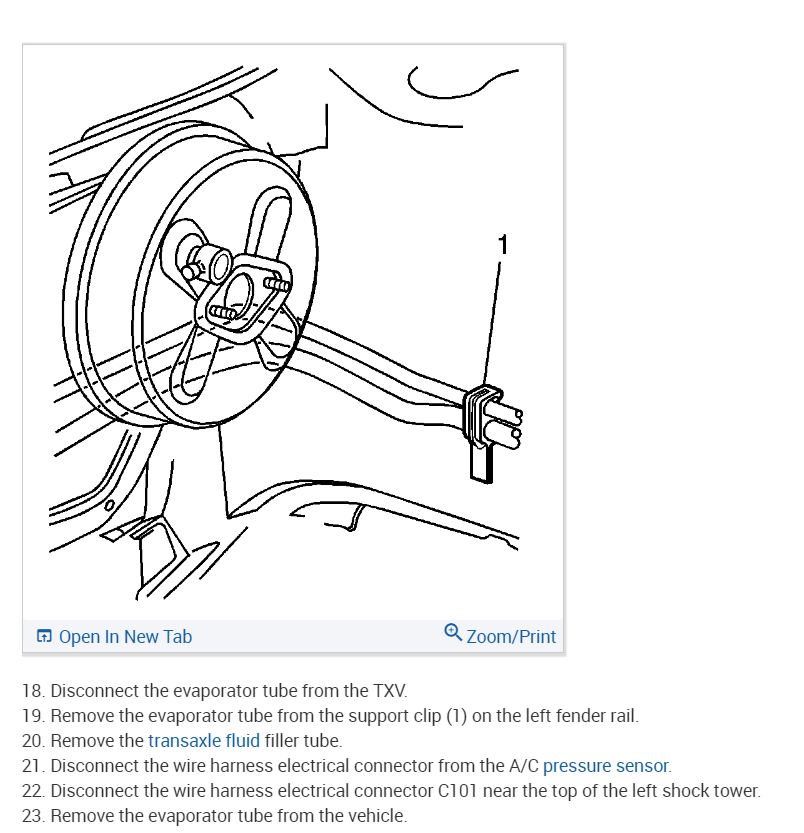

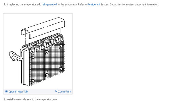

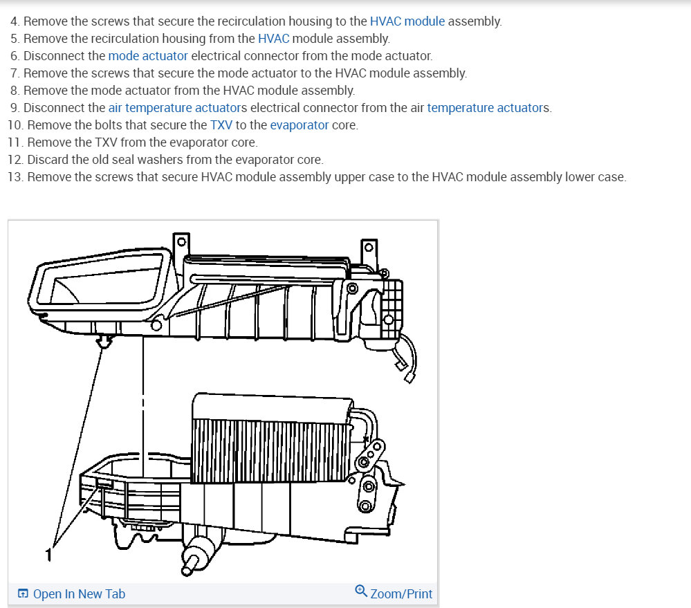

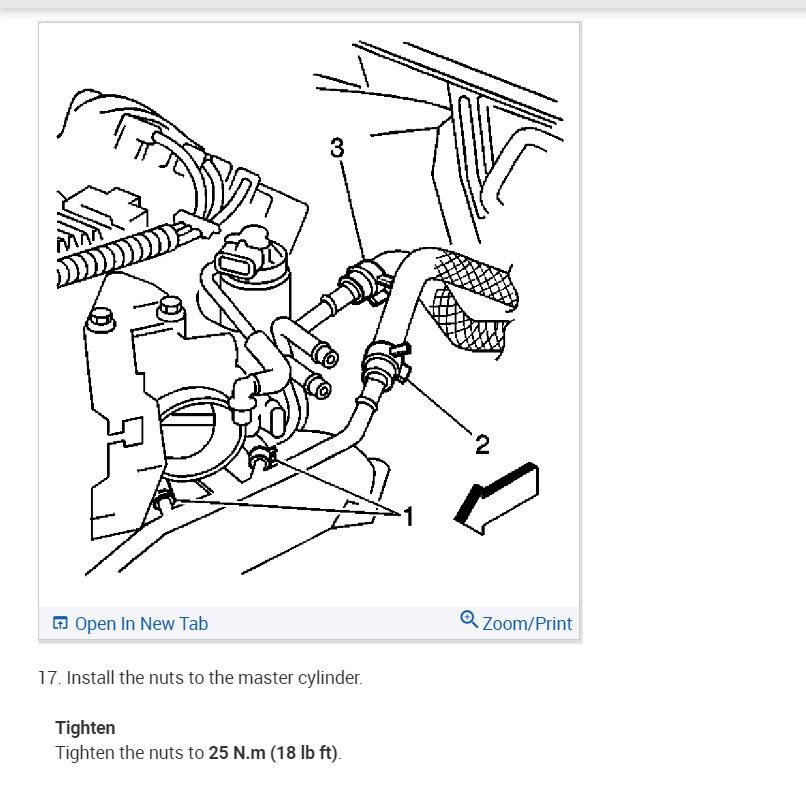

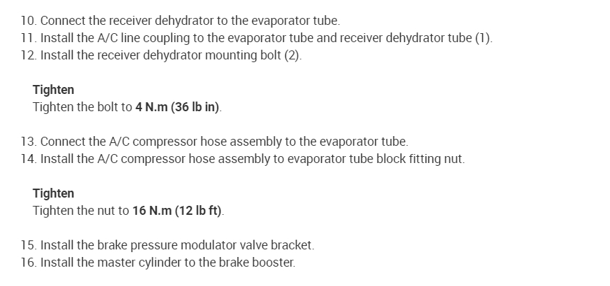

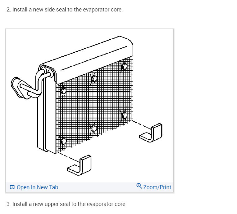

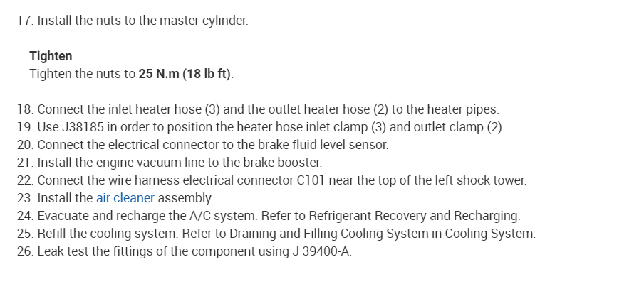

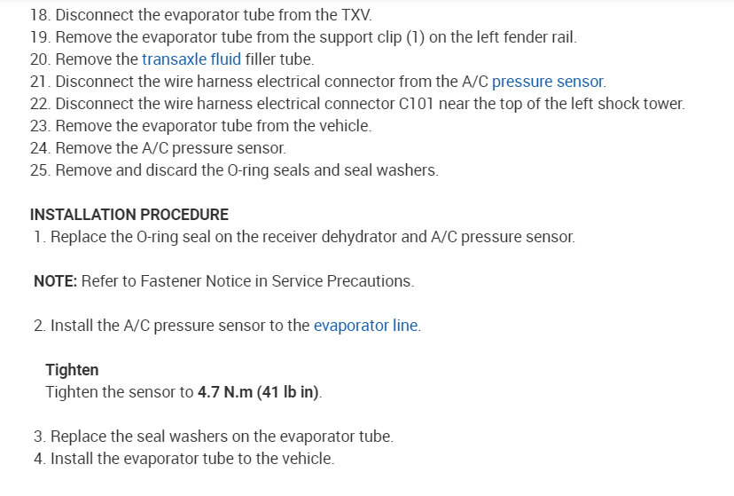

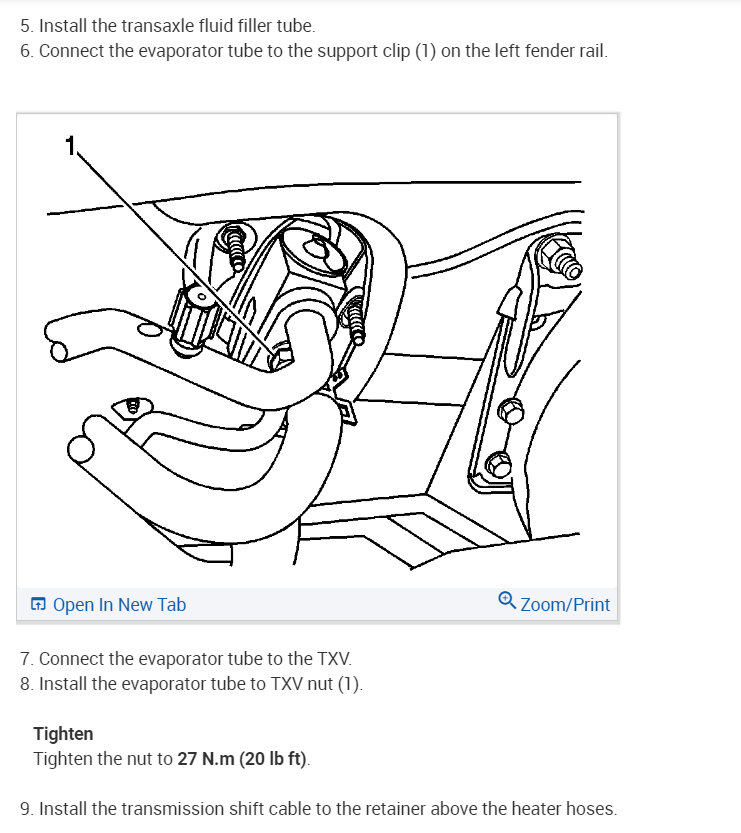

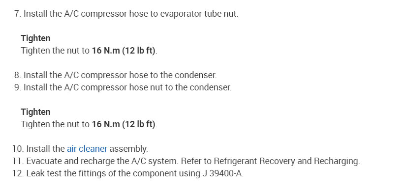

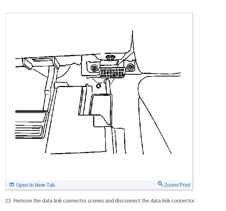

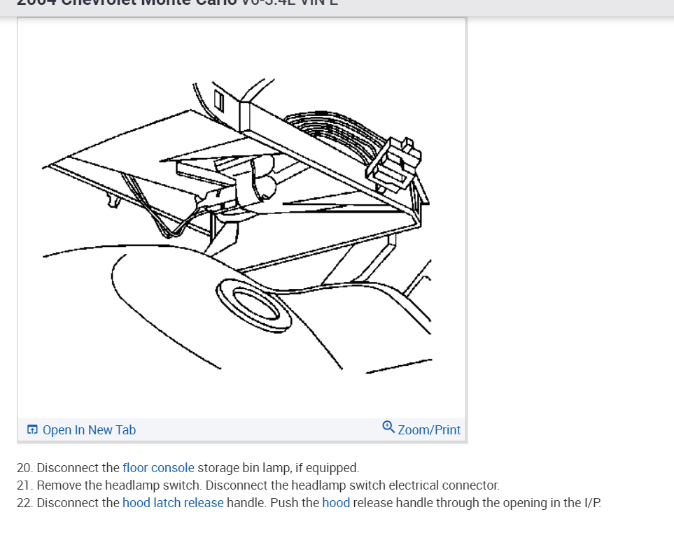

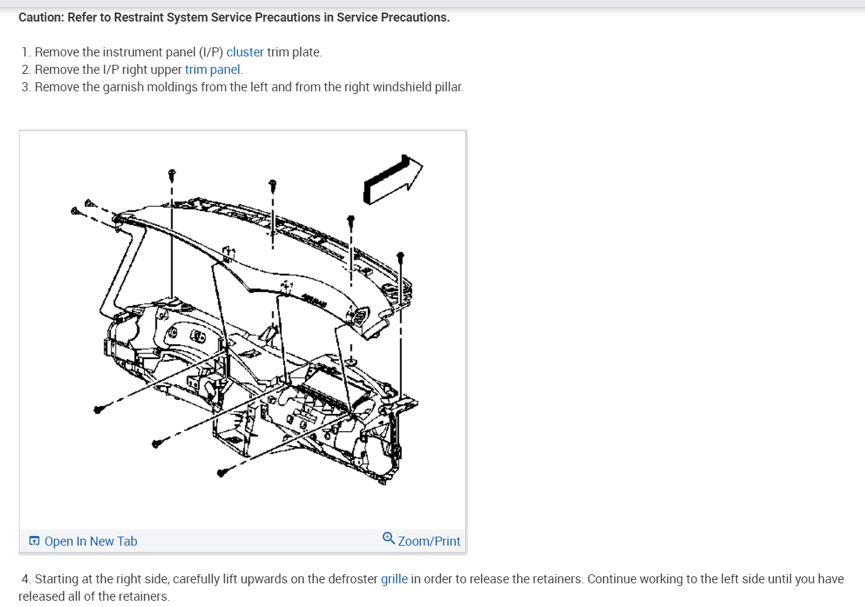

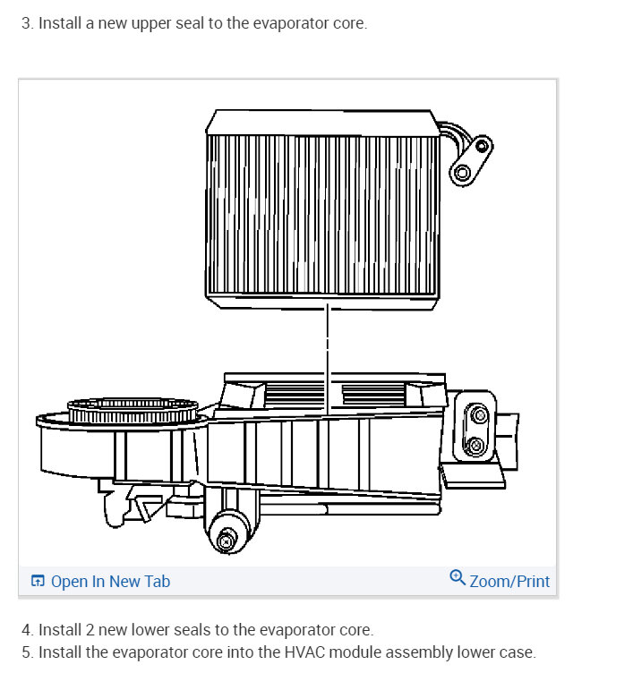

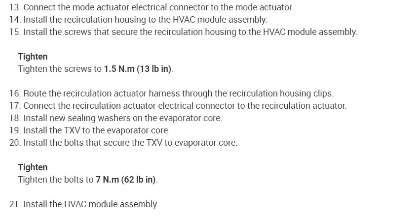

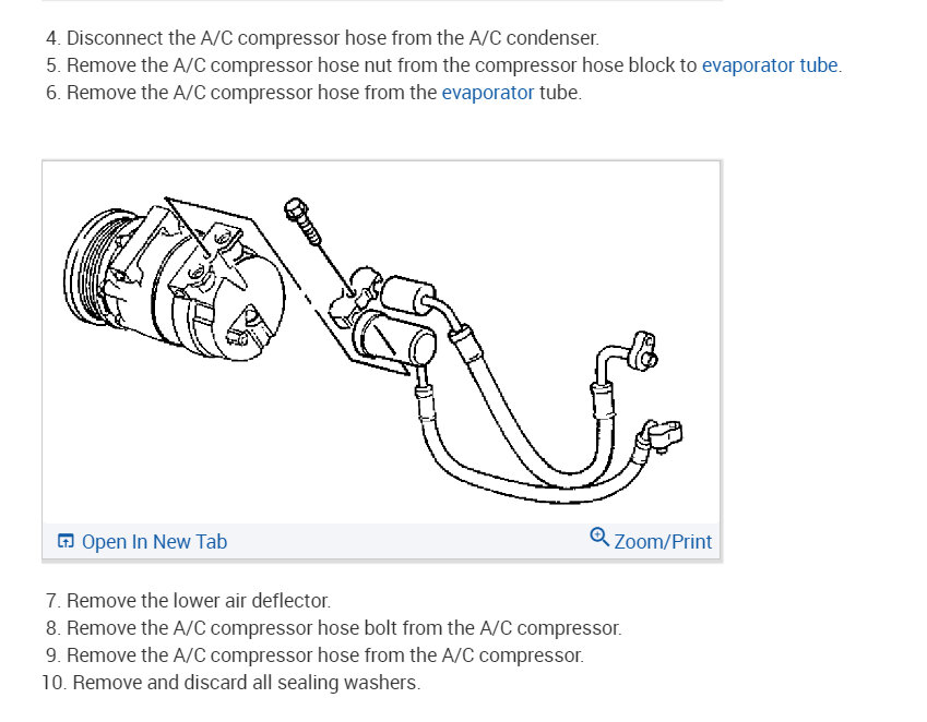

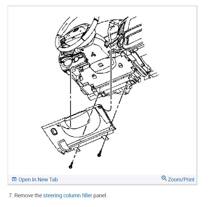

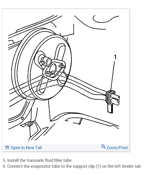

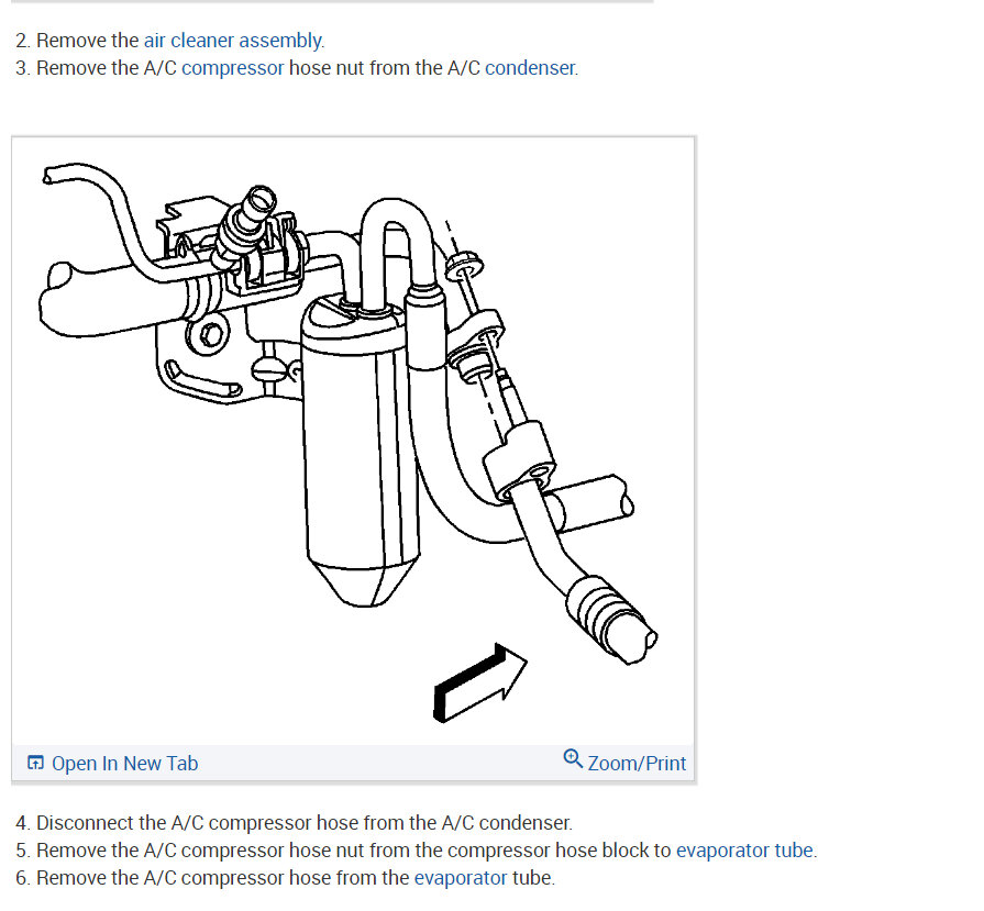

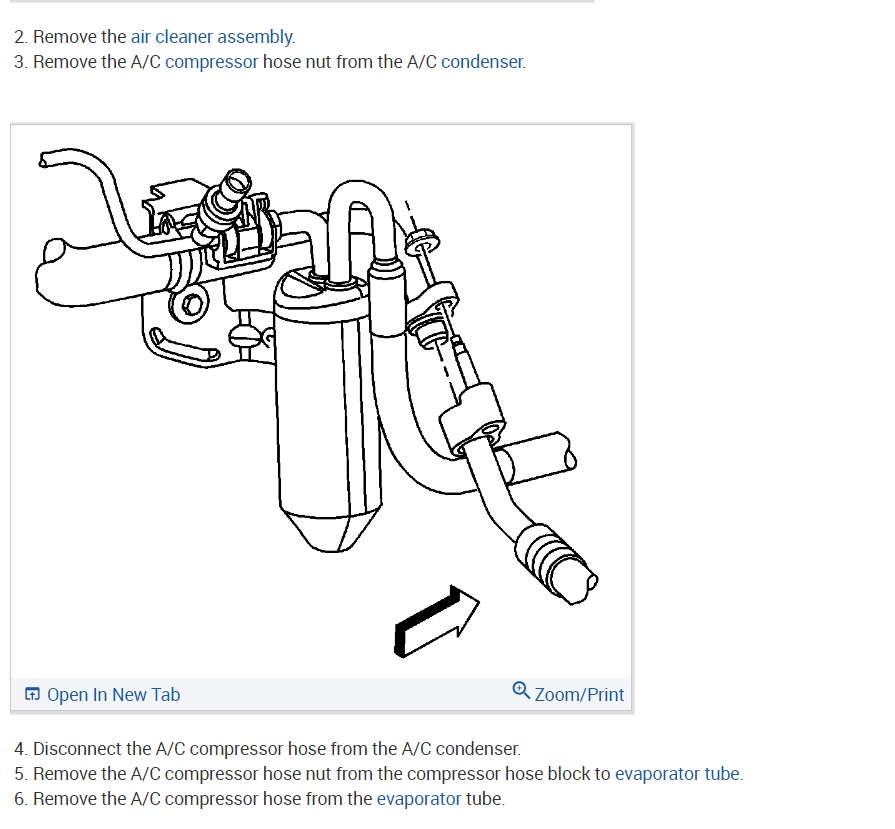

Next here are the instructions for the hose and evaporator replacement in the images below. Check out the images (below). Please let us know if you need anything else to get the problem fixed.
Jan 6, 2023 at 4:00 AM
  • 55,707 POSTS

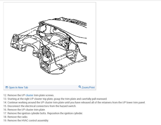

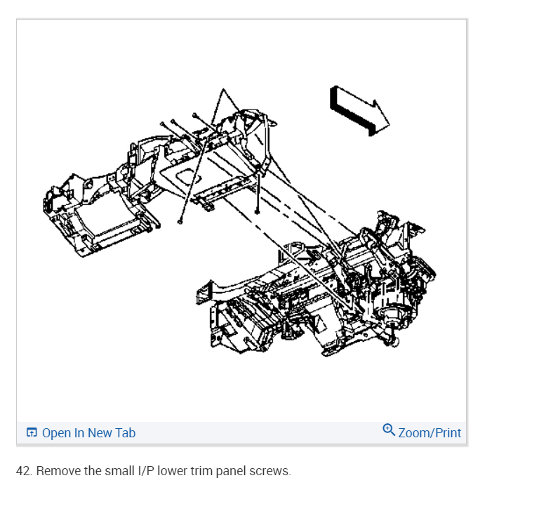

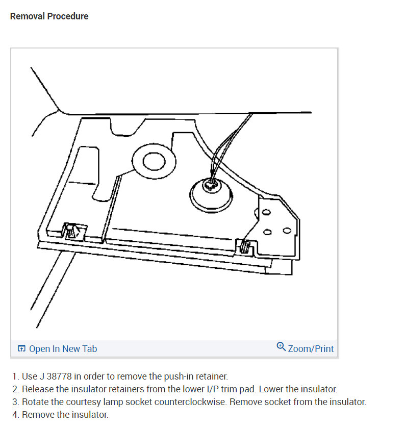

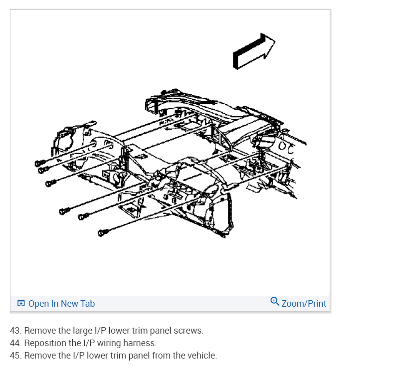

You will need to disconnect the battery before you begin. Check out the images below to show you how to remove the dashboard. Check out the images (below). Let us know what happens and please upload pictures or videos of the problem.

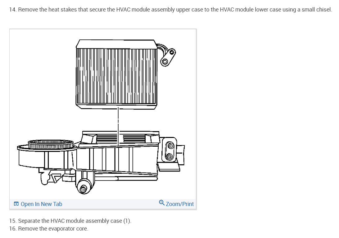

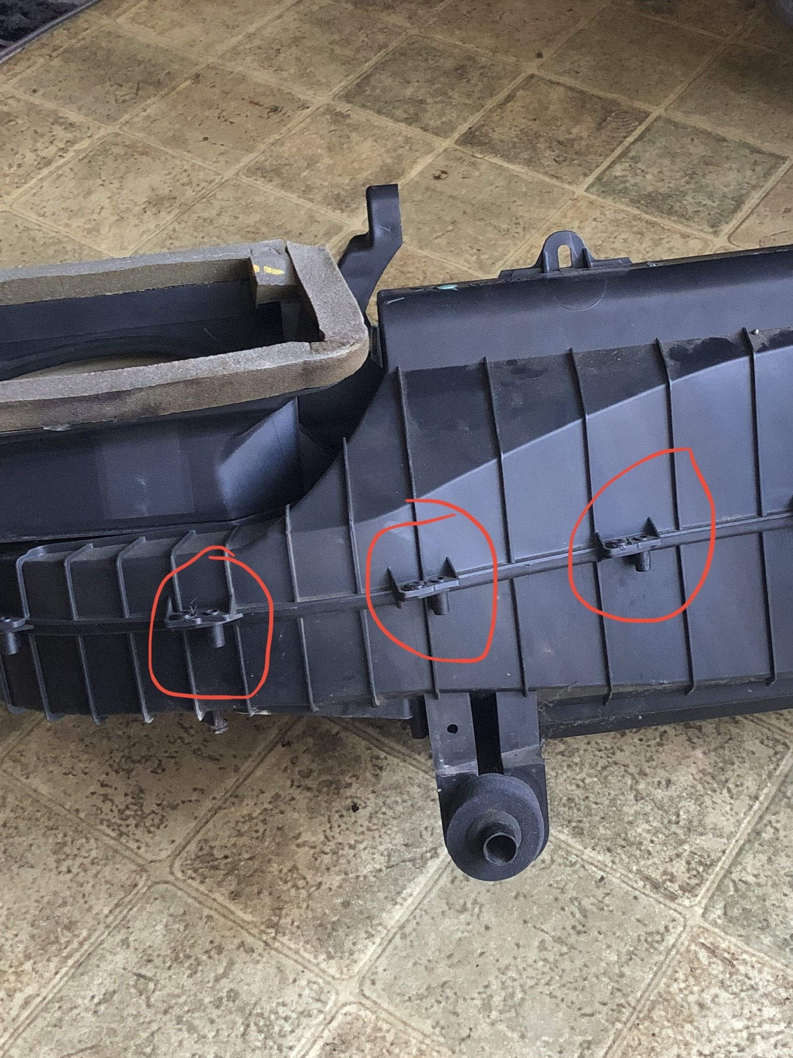

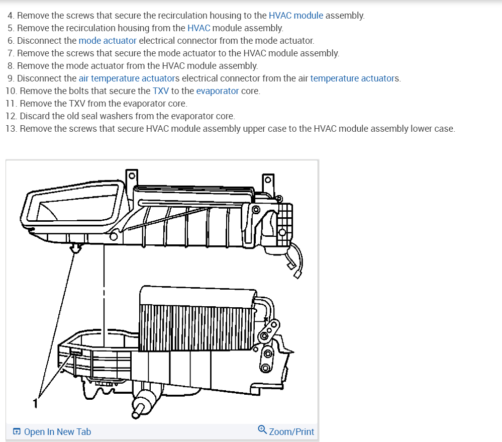

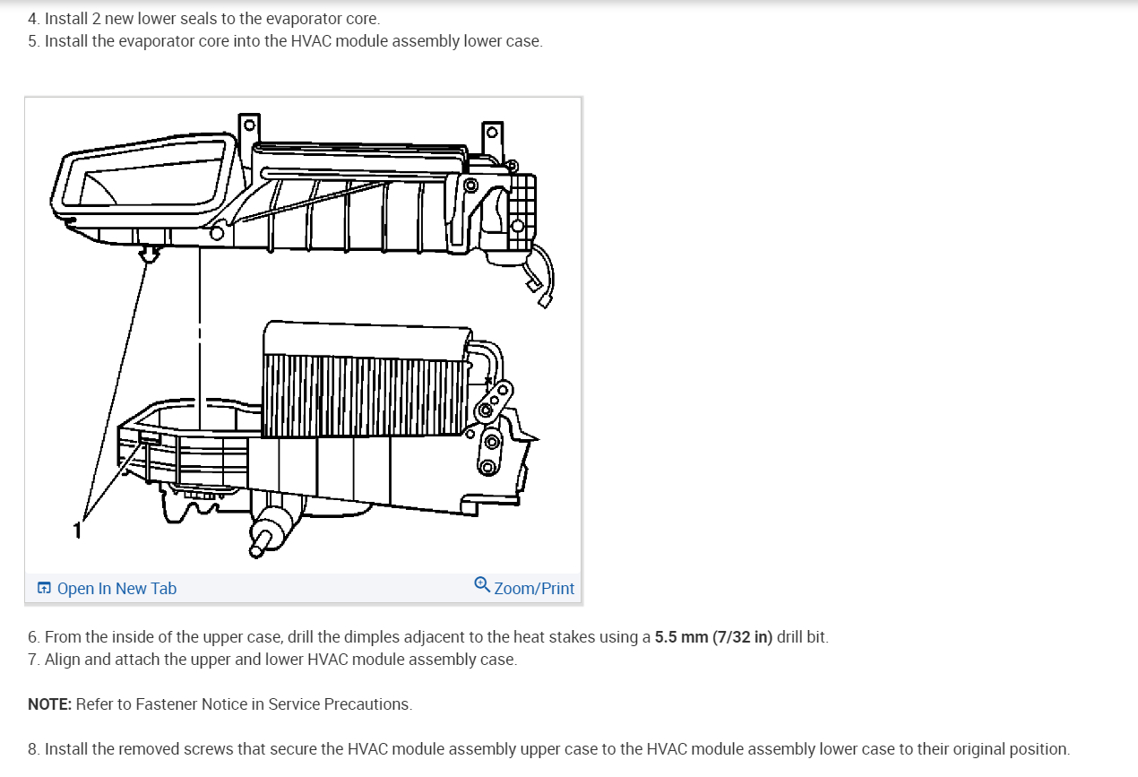

How do I remove the Heat Stakes from the HVAC Module Assembly?
Mar 11, 2023 at 5:53 PM
  • 55,707 POSTS
Heat Stakes? can you upload an image please?
Mar 13, 2023 at 5:05 AM
RODJAMES
  • 25 POSTS

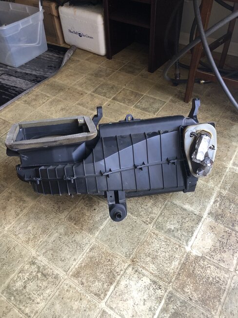

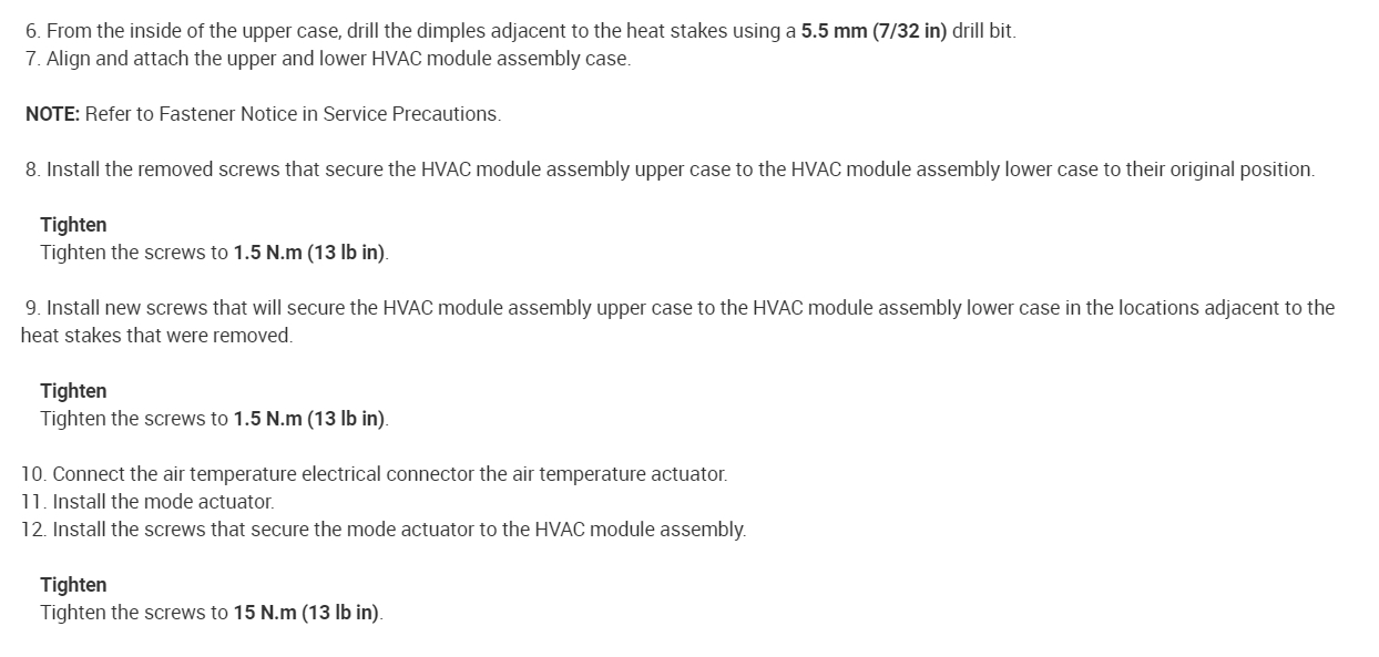

Here’s my HVAC unit case where my evaporator and heater core reside. I’m trying to separate the upper and lower case so I can replace them. The red circles I drew are supposedly called heat stakes. How do I take apart this case? The instructions say use a small chisel but I’m wondering if there’s another way.
Mar 15, 2023 at 8:30 PM
  • 55,707 POSTS
Thanks for the images, boy they didn't make that to come apart did they? I would try to drill them out so you can use a nut bolt fastener to reassemble it.
