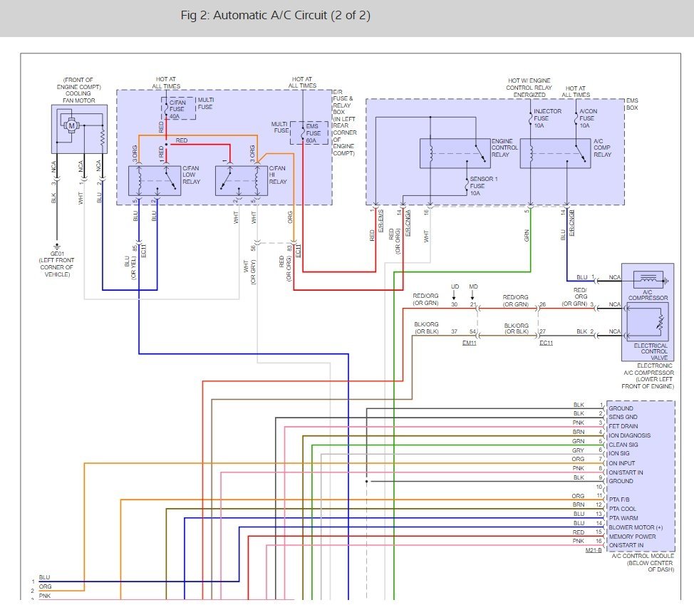

It can be anything in the system that when it get warm it quits, but lets start at the most popular reasons, of course all testing can only be done when the system is not working. Using a test light
Check for power at the compressor. If power exists the compressor is bad and it needs to be replaced.
https://www.2carpros.com/articles/replace-air-conditioner-compressor

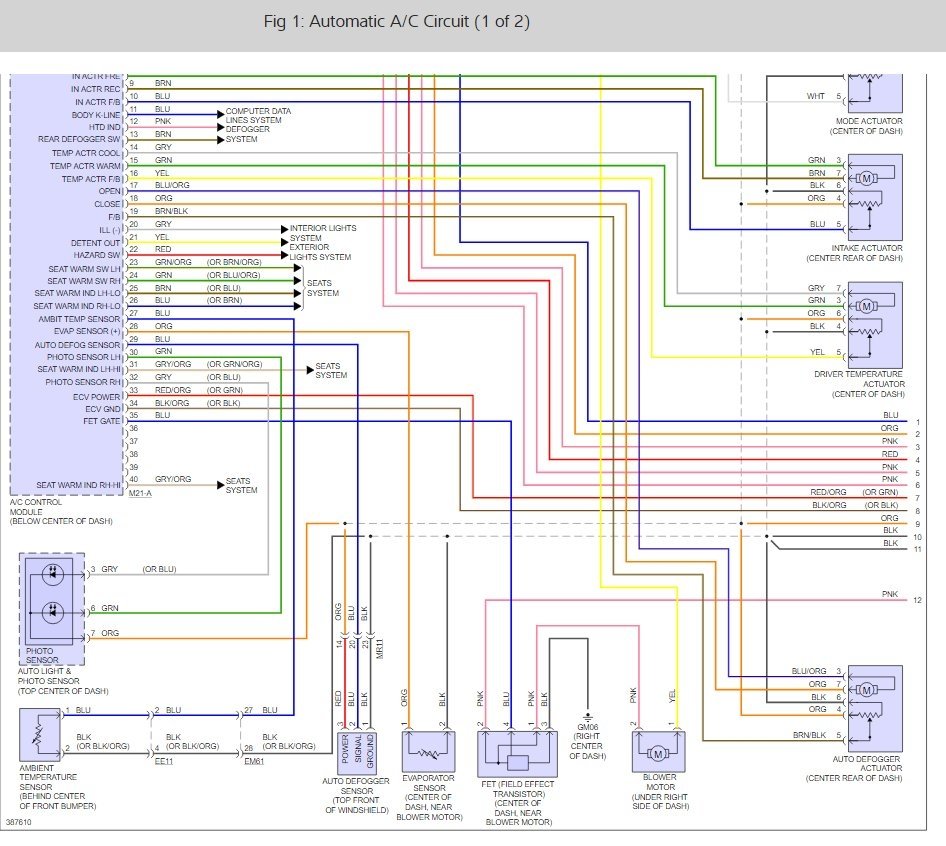

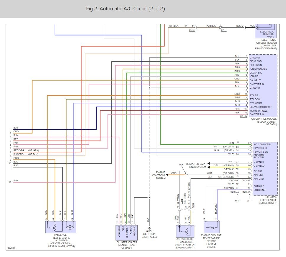

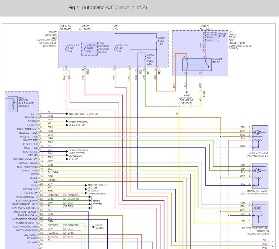

Here are the wiring diagrams (below) to help test the rest of the system (below)
