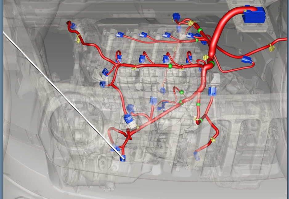

A//C compressor solenoid location
2016 JEEP PATRIOT
37,000 MILES • 2.0L • 4 CYL • 2WD • MANUAL
LARRY SMITH4
Car sold new without A/C.
Installed A/C components.
cannot find the A//C compressor solenoid.
Aug 29, 2019 at 10:58 AM
Hi Larry,
The compressor solenoid is part of the compressor. The arrow on this attachment is pointing to the connector for this control solenoid.
I assume that you are having an issue getting the compressor to come on? If this is the case, have you had the sales codes added and then performed a vehicle reconfigure? Basically, this is telling the vehicle computers that it now has A/C and it will operate assuming you got all the components installed.
Let me know and we can go from there. Thanks
