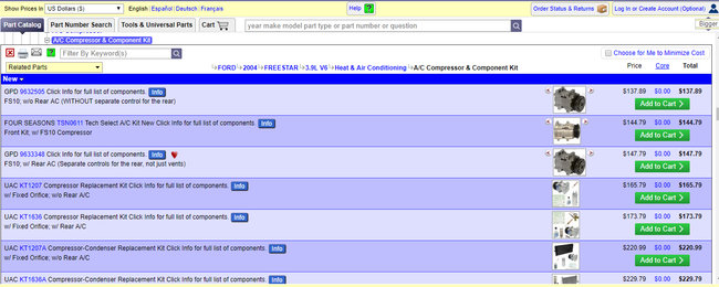

Hi, we have a the vehicle listed above that we bought on craigslist. Everything worked great when we got it, including the air conditioning. About a week after we got the van, the A/C stopped working. We took it to a mechanic who said there was an A/C leak and the guy who sold it to us must have just put in a can of R134A right before he sold it to us. The mechanic said there was a leak in an A/C line going to the condenser, which we had replaced. After that, the mechanic said the compressor was bad? I don't know how it could have worked perfectly (including the compressor) a few days earlier and then have the compressor be bad? My wife and I are seniors on a very fixed income and we can't afford to have a mechanic fix it so the car has gone without A/C for over a year. However, our summers get over 100 degrees each year and we need to get it fixed. My son is pretty handy and said he would come over and change out the compressor if we buy the parts. We were thinking of doing that until one of our neighbors said that if an A/C system hasn't been used in over six months, that it is best to change out everything. Is this true? I thought we could just replace the compressor, vacuum out the system, replace the R134A, and have out A/C working again. What is the truth about what needs to be done?

With it sitting for that long and even it was a week, the compressor, dryer and expansion valve are the pieces to replace.
Rockauto has a kit for about $200.00 that includes the compressor, dryer and expansion valve.

Should we think about changing the condenser as well? We also have a 2001 F150 where the A/C was cooling less and less over a few months and eventually quit altogether. That was six months ago and we haven't had the money to do anything about it. Wonder if we should change out the same components on the F150 as we do on the Freestar?
Mar 30, 2019 at 5:15 AM
Yes, to the same components for the F150 and no to the condenser unless you have bad pressure issues.

I would have someone check the pressure on the A/C system before replacing that compressor. It's possible the technician may have been trying to make a sell that was unnecessary. The only way to be sure though is to have the system charged and have the pressure on the low and high side checked. If the compressor has failed because of the internals locking up then I would recommend replacing all of the components and replacing the condenser because the shards of metal can be reduced to power like substance and believe me, is impossible to clean out fully.
Apr 1, 2019 at 8:18 AM
System has been open for a period of time already.
