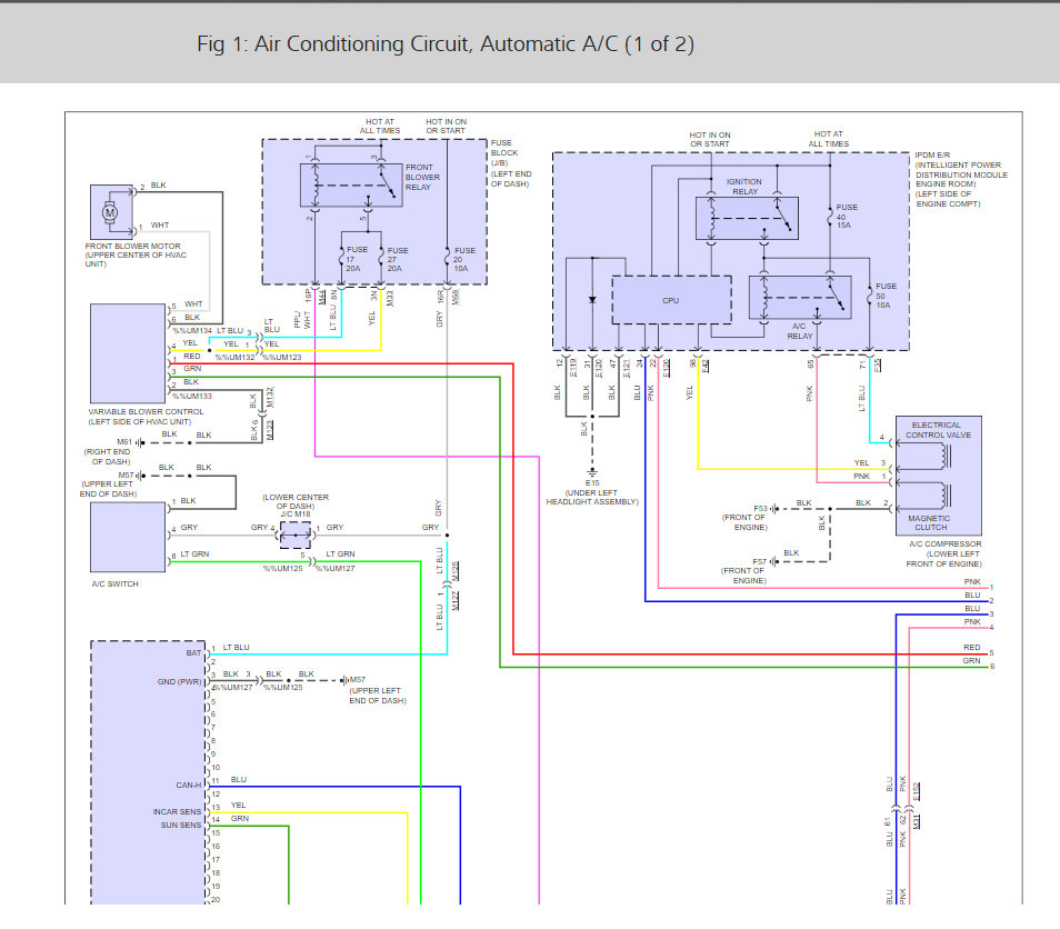

The A/C switch from recycle air to outside air by itself, in turn cause the air to heat up inside the car. I have to put the control back to recycle my self.
Jun 18, 2018 at 6:39 AM
  • 55,224 POSTS

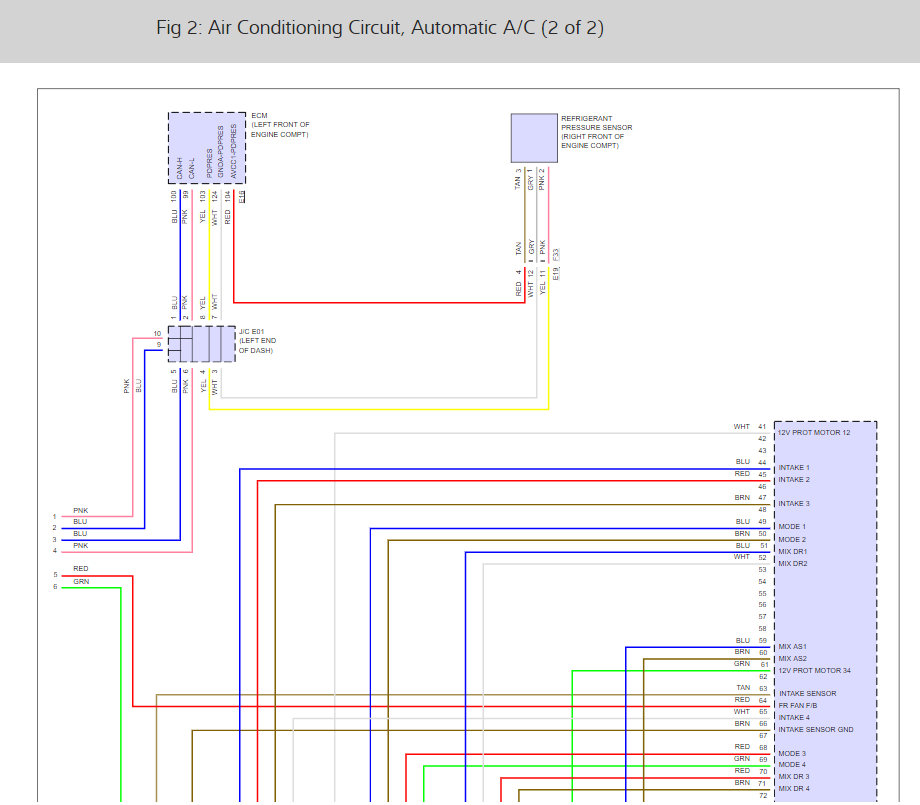

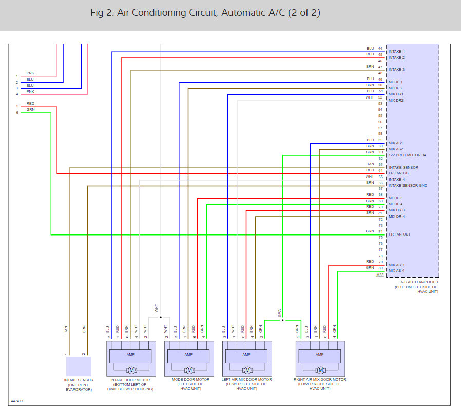

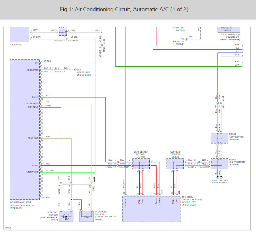

This sounds like you have a blend door actuator that is not working right or the AC amplifier has gone out but to be sure here is the wiring diagrams and fuses that needs to be checked for power:
Fuse # 17, 27, 20, 40 and 50
and
Here are the wiring diagrams so you can see how the system works and the component locations.
Please run down these guides and diagrams and report back.
