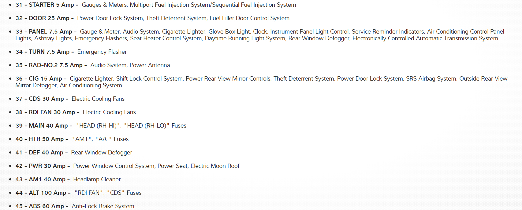

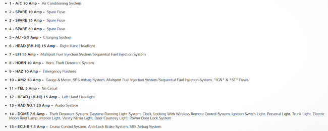

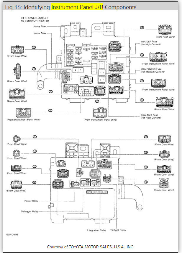

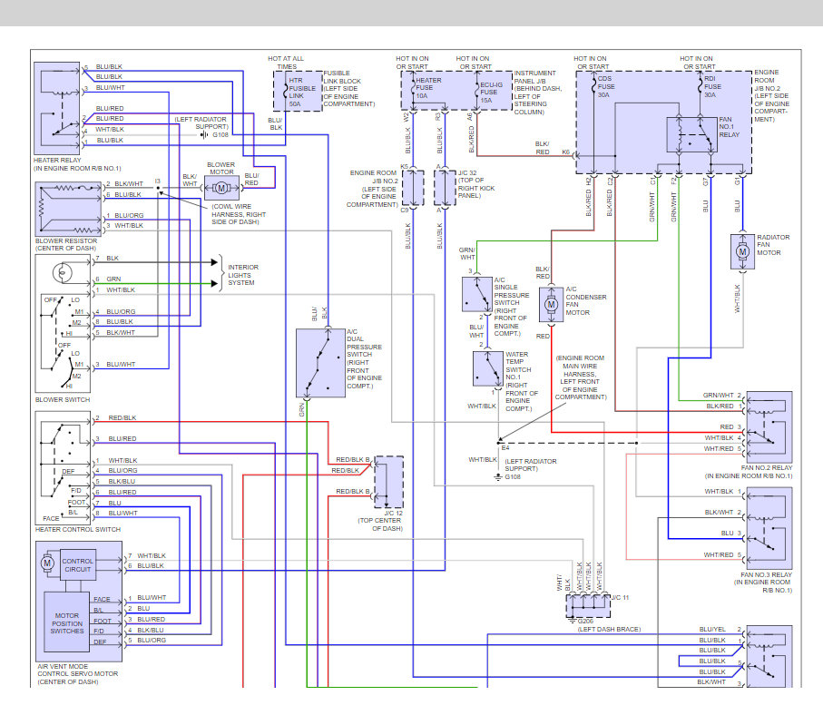

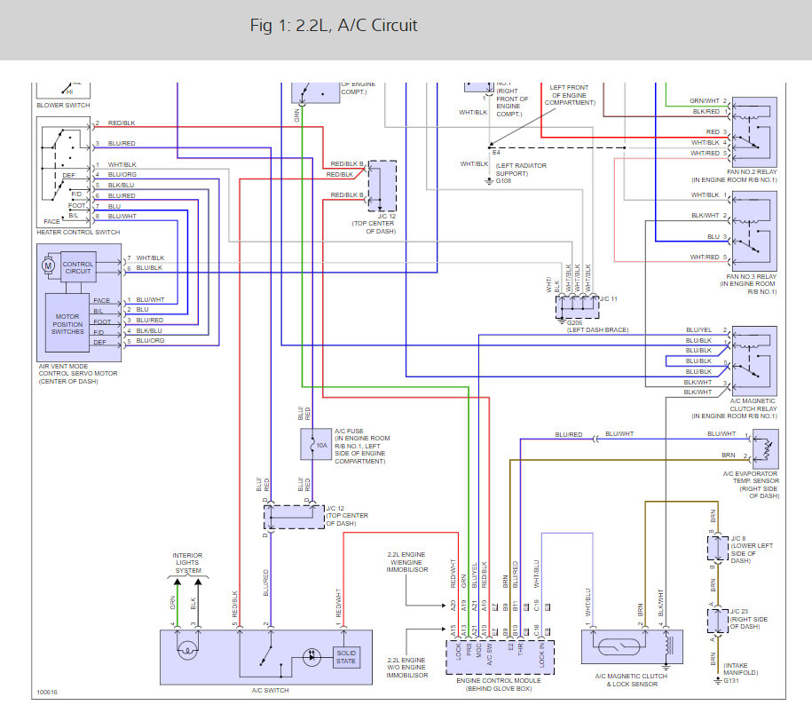

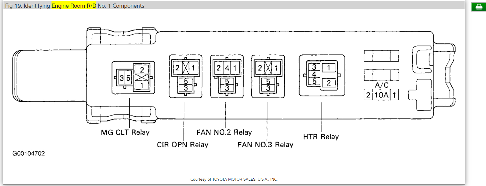

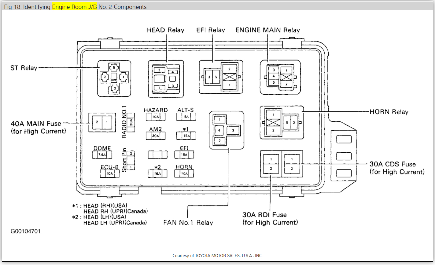

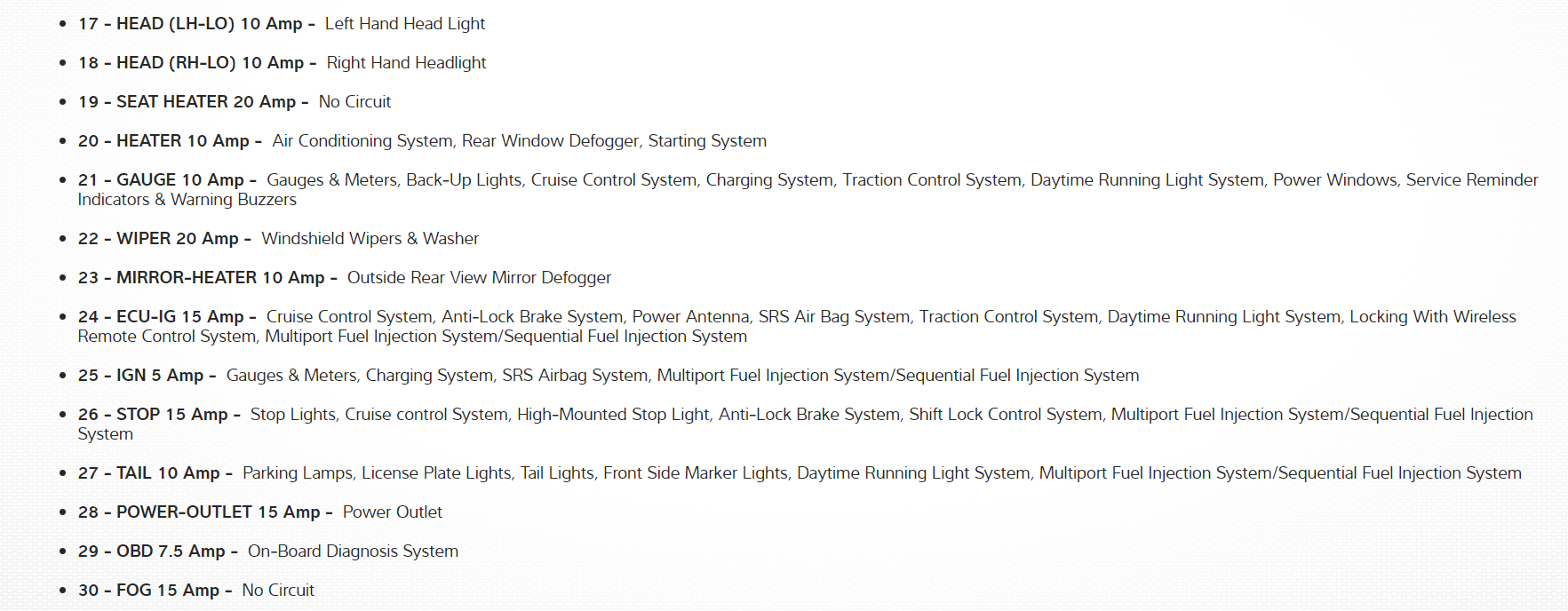

No MGC operating. Air conditioner not working
Feb 21, 2019 at 6:52 PM
Experienced Mechanic
55,616 POSTS

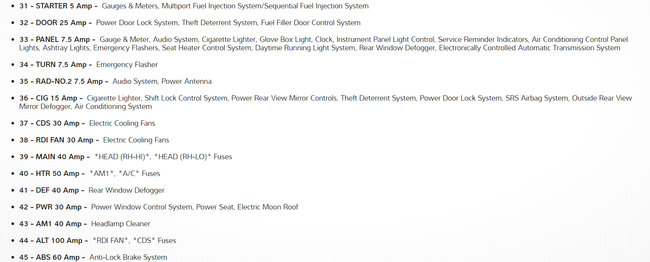

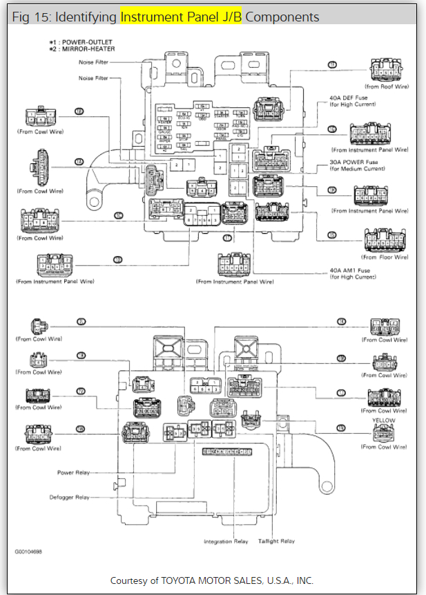

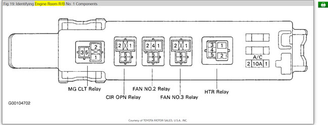

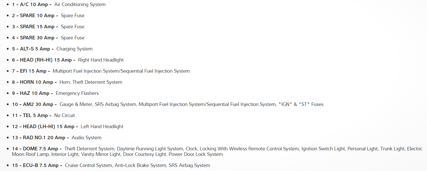

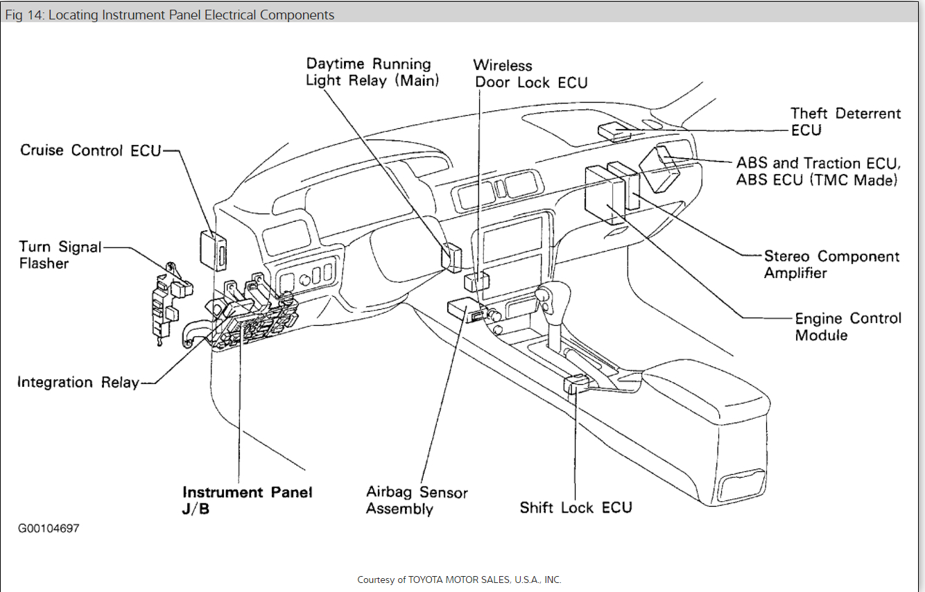

This can be because a fuse is blown. Here is a guide to help check for power and the air conditioner wiring diagrams so you can see how the system works and what fuses to check:
Check out the diagrams (below). Please let us know what you find.
