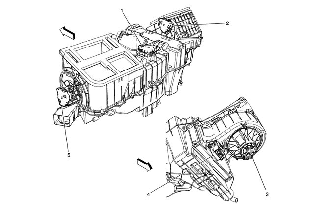

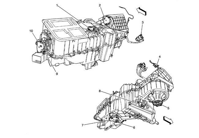

Hoping to find actuator to replace in hope's to repair, but no idea where it's located or how to find it.
Mar 28, 2020 at 5:36 AM
SCGRANTURISMO
  • 4,897 POSTS

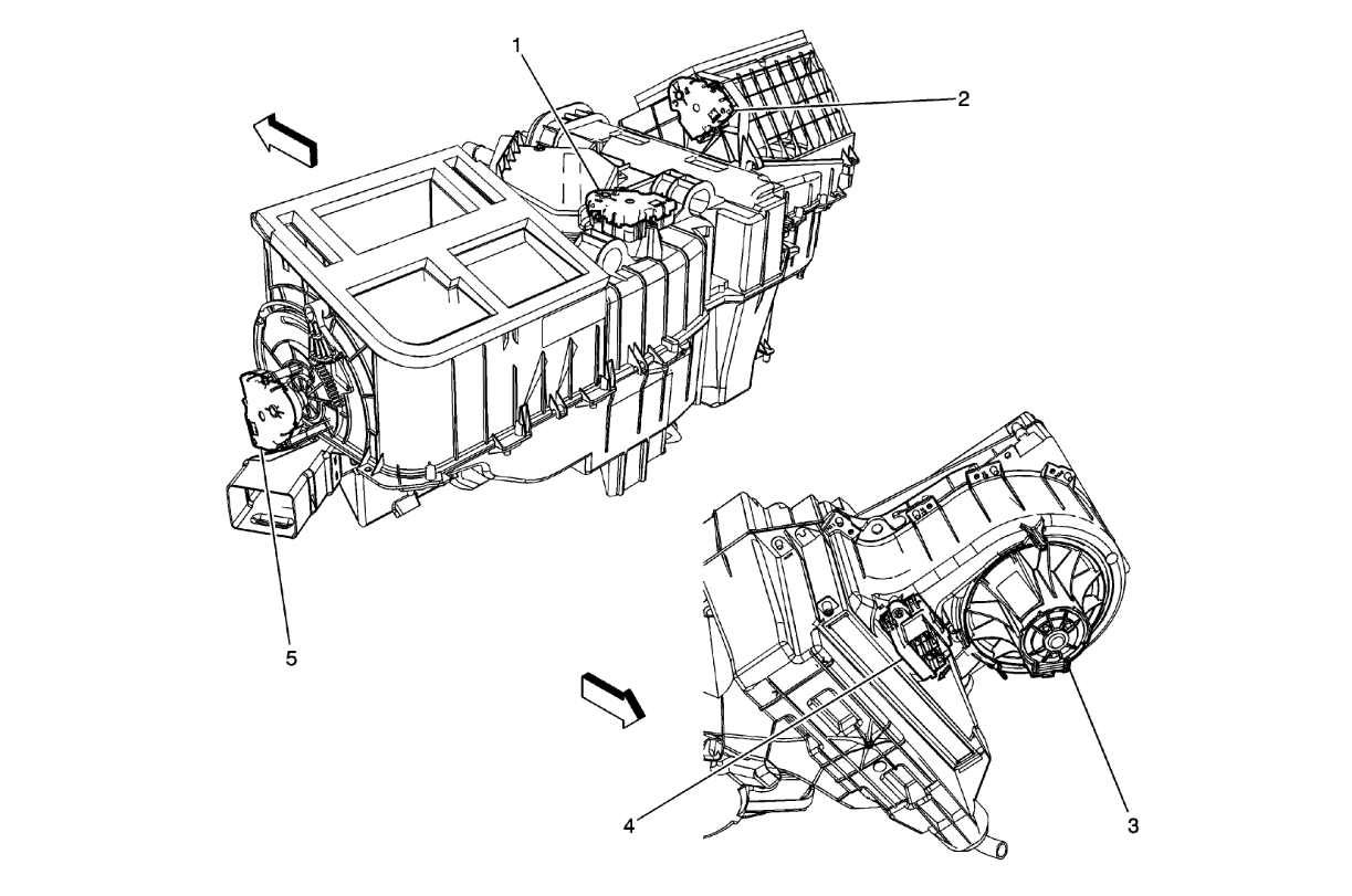

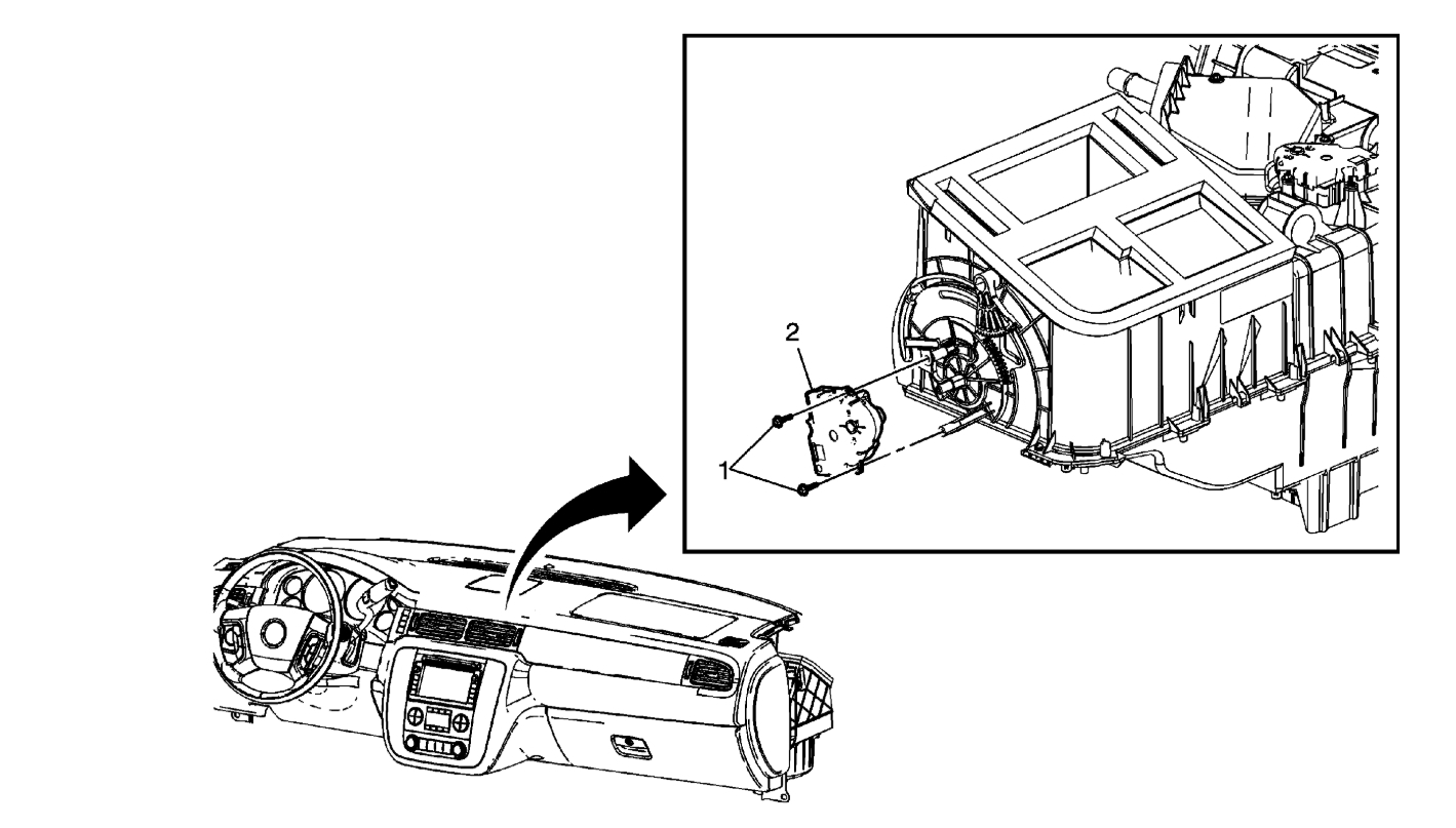

I have included in the diagrams and this guide down below the locations of the Heating Ventilation and Air Conditioning actuators for your vehicle as well as the instructions for the removal and installation of the Mode Actuator for your vehicle. Here is a link to a generic guide for you as well:
Please go through these guides and get back to us with how everything turns out.
