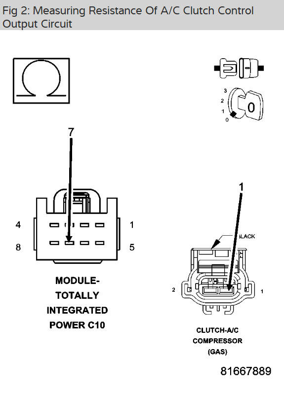

1274 is an open circuit to the a/c that is probably why it's not working. test this so he can turn on ac in pcm with scanner to find short in system. you can check wires in pic if it's got 5.0 ohmsor below it's ok .

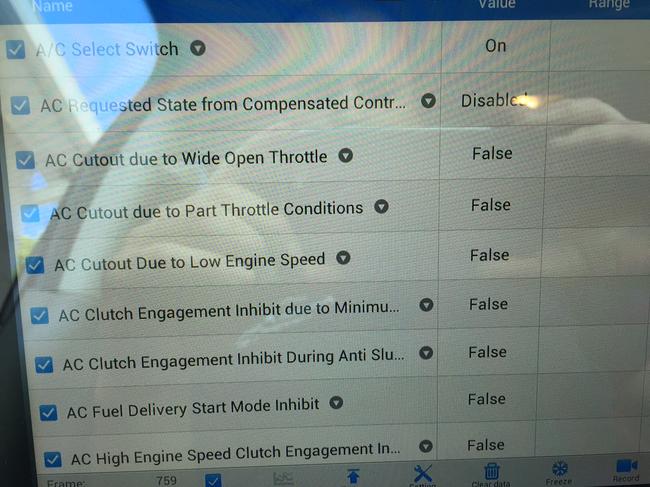

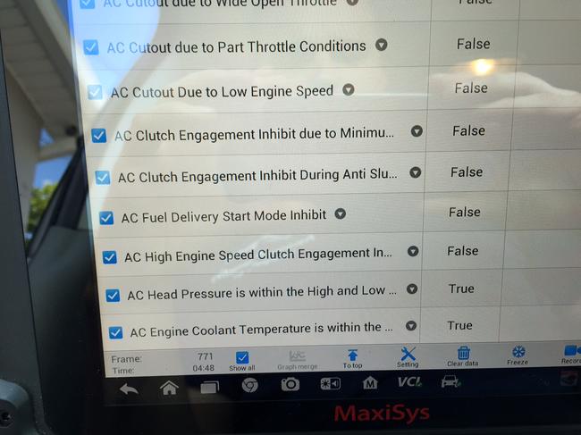

Ok Here are a few more pieces to the puzzle. lol I brought the car to a mechanic that has a scanner. he couldnt figure out the problem either. After the car ran for awhile and sat so the compressor wouldnt turn on. if the car was running he could not manually activate the clutch with the scanner. the scanner said all the conditions were not met. but if he just turn the key on with engine off, the clutch would activate but as soon as you start the car is would shut off. very weird. I then drove the car about 15 minutes and the compressor finally turned back on, engine bay cooled down or something maybe? and then when i stopped and let the car sit running, it shut back off and wont turn back on probably until it cools down for a few hours. Weirdest part is... the first time i run the car from cold temp, i can run the car for hours and the ac will never shut off, but once the car sits off for 20 or so minutes it wont turn back on. I will attach screen shots of the live data he took of all the a/c data. this was with the car running after it sat and the a/c would not engage. the button in the car was light up to show i have it turned on but the clutch would not engage.

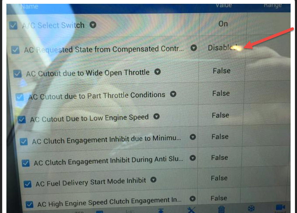

Jul 23, 2015 at 7:40 AM
J02WS6TRANSAM
  • 34 POSTS
that is the second screenshot.

like I said in very first reply I bet it's the tpim module which is under the fuse box have him scan for those codes.it may be getting hot and causing the problem. the screen shot I'm returning has ared arrow pointed to it if that isn't enabled it's not going to work
