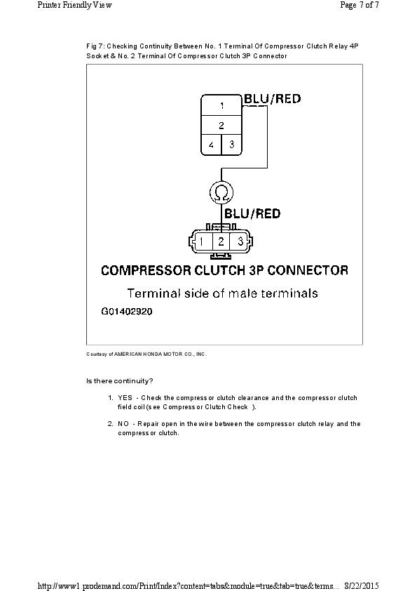

Hi my 2002 Honda Civic LX 2DR A/C stops blowing cold air after 20 minutes, If I turn it off for a few minutes it will works fine again. Sometimes it will go out again after 20 minutes and sometimes it will work fine for an hour + ride. I had the A/C system evacuated and charged with Freon, It wasn't low we recovered 1lb 2oz and put back in the same amount.Where do I go from here? What do you think it could be? Thanks for your time and have a great day. Neil

Hi yes I use it often it can turn off in traffic or driving on the highway can you give me the ohms range for the electromagnet and the gap for the clutch thanks for your help it is greatly appreciated Neil

Try this.

Hii did continuity test it was good but a/c was working at the time does it have to be not working when I check it? Do I go to the next step clutch gap/clearance? If so what is the clearance gap?
Aug 24, 2015 at 10:34 AM
RIVERMIKERAT
  • 6,106 POSTS
Yes. When it conks out. Also check to see if the relays are passing power.
.02 +/- .006 in according to my reference.
.5 +/- .15 mm

Stooped working twice ,by the time I hooked up the meter less then 10 minutes it checked good my gut feeling is the magnetic coil ii s going bad what is the ohms reading in it? Its hard to figure out when it is so intermittent
Sep 1, 2015 at 12:56 AM
RIVERMIKERAT
  • 6,106 POSTS
It's not listed in the diagnostic steps I sent?

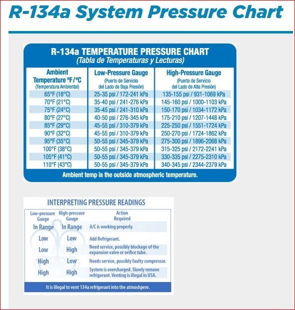

Just to jump in on this as I want to offer what I suspect the issue is or at least the way to find the solution.
I see you checked the pressure when you filled it, but we need to monitor the pressure when this is operating and then when it cuts off.
If the pressure is going high or low, or if the compressor just shuts off, we will know what the issue is.
If the pressure goes high, then we know the compressor is building too much pressure.
If it doesn't and just shuts off points directly to a compressor or clutch as you suspect.
I am attaching a chart below that will help with this but let us know what happens with the pressures when this is happening and that will tell us what is going on. Thanks

Although an old post. I will let all know it was just the removal of a shim under the clutch. Works great ever since. 10-minute fix and $0 cost. So many techs today won't take the time to troubleshoot. Just replace it until they get it right. Thanks always for your help. You are all great!
