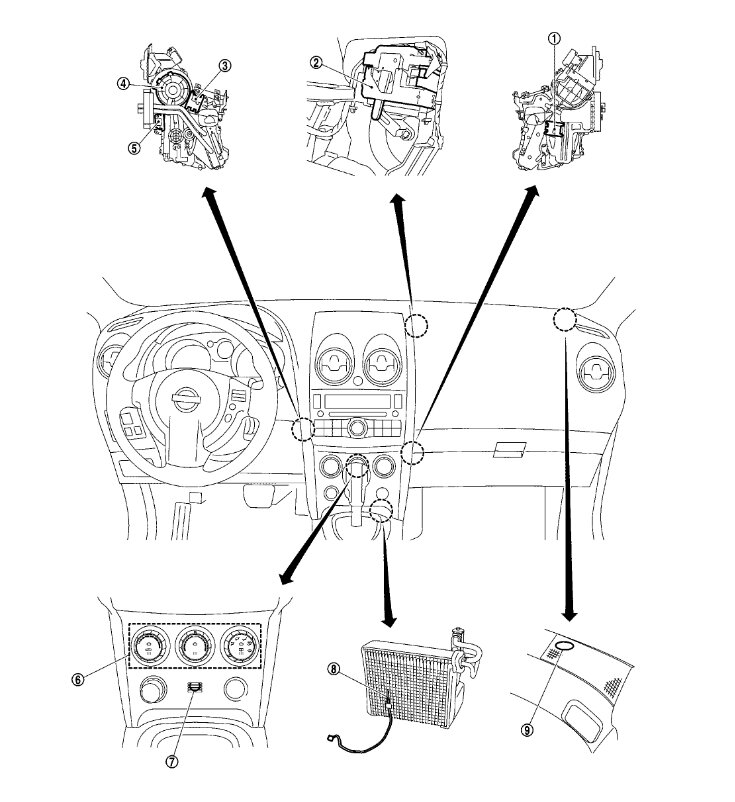

I was driving and my air just suddenly stopped blowing cold. We checked the refrigerant and it's charged. Fans are blowing but compressors are not kicking on when air is turned on.
Jun 1, 2023 at 11:57 PM
  • 55,433 POSTS

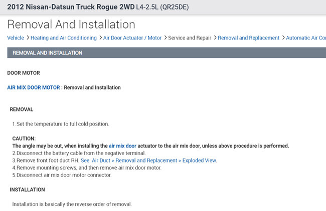

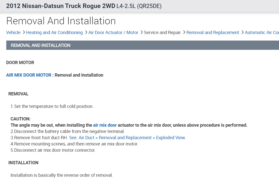

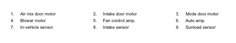

I Would check the outgoing A/C tube from the firewall (larger of the two) and if that is cold it sounds like the temperature blend door actuator is not working here is a guide to help and the actuator location in the images below:
Here is a guide to help you step by step with instructions for your car in the images below.
