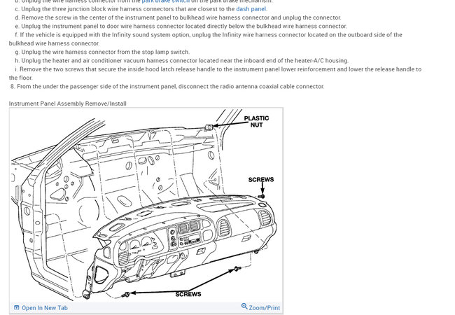

Hoping it's not a leak behind the dash.

Me too, that's the worst place. Thats why i'd have them call you first, the bill for that might be too much. I'll take a look and see what needs to come out if the evaporator is leaking,
What size engine is in this, and is this a pickup or van? Dodge has listed a Ram Van and Ram Wagon as well.
Anyway, it looks like the whole dash has to come out to get the HVAC box/housing out. It's a big job.
