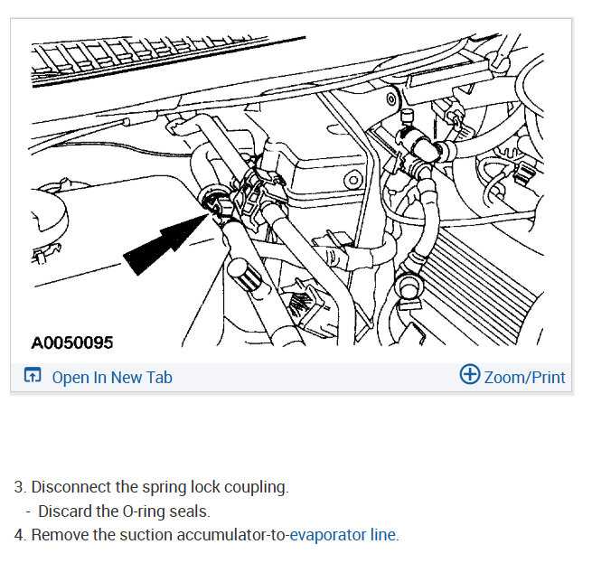

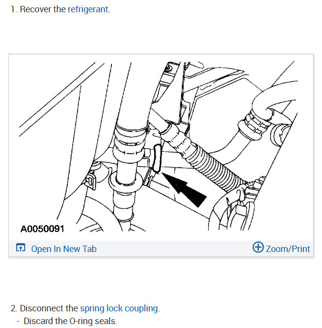

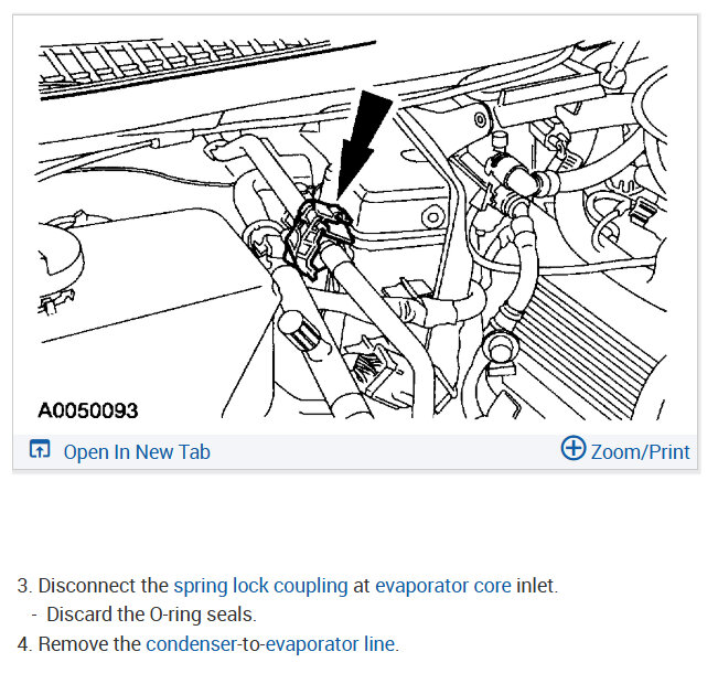

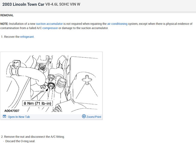

How do I replace these A/C parts?
hose assy /discharge suc (#55111)
Condenser (#NC4011A)
and Accumulator (#218630)
Jun 5, 2025 at 2:25 PM
  • 55,766 POSTS
Please start new threads for the Condenser and Accumulator. Here is how to swap out the hose set. use this video to help vacuum down and recharge the system.
https://www.youtube.com/watch?v=4EqdrBVb0sY
Check out the images (below). Let us know if you need anything else.
