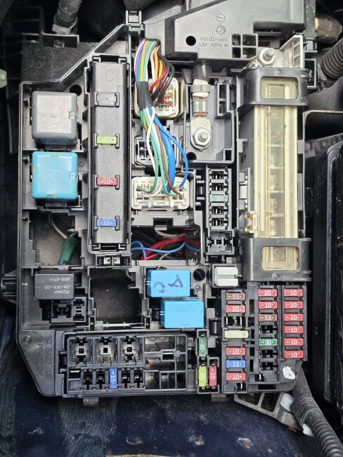

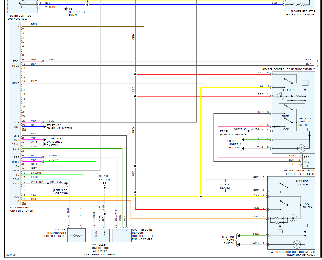

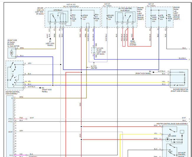

I have a 2009 Toyota Maxtrix S 2.4L manual. I do not have cool air so I am
looking for the AC relay switch. Once I took the cover
off under the hood I see in the cover it does show the location of the HTR
50A switch but looking at the switches/fuses there is nothing there.
I've included pictures. Can you tell me where I can find this switch?
Also, once i can locate the relay switch what terminal do I jump o the relay to
make the compressor clutch engge.
Jul 20, 2026 at 2:44 PM
  • 55,688 POSTS

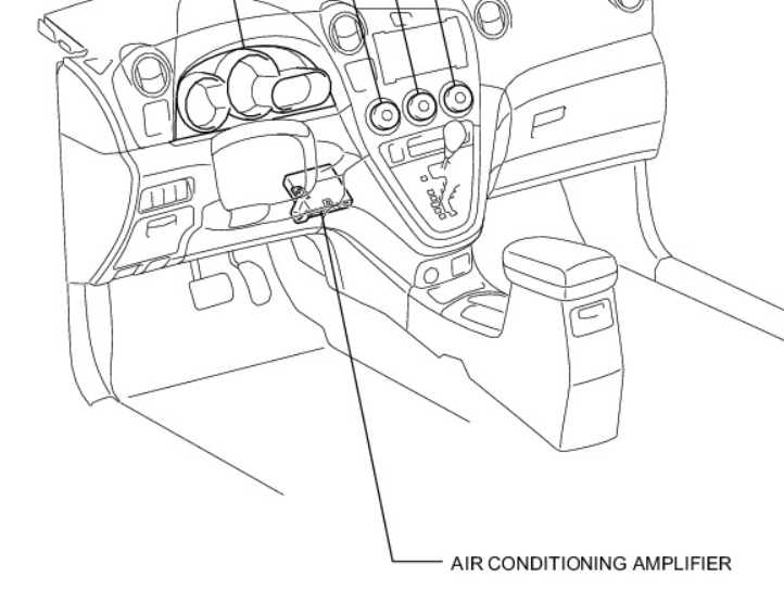

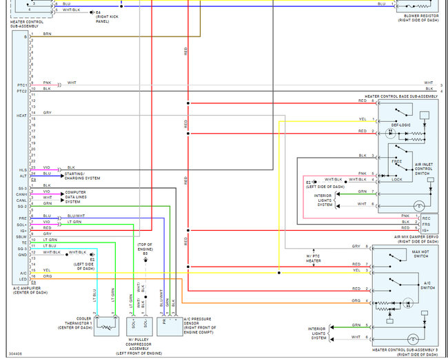

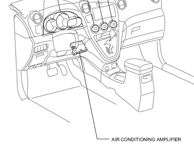

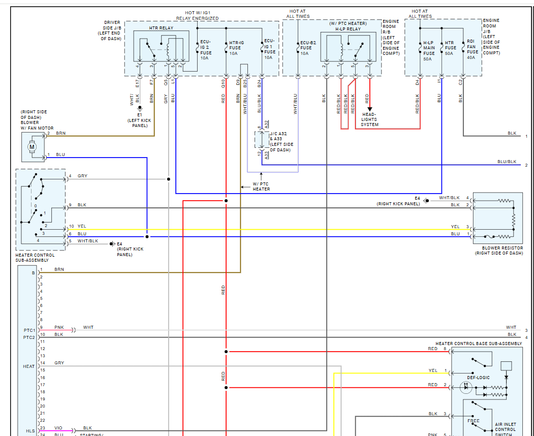

Hello, I can help you, there is no compressor clutch relay like on some cars, this is controlled by the AC amplifier which have a history of going out. Here is the wiring diagrams so you can see how the system works and the location of the amplifier as well. Check out the images (below). Please let me know what happens.

Hi so I found the location of the a/c amplifier and I'm in the process of getting a new one. I will let you know how this all works out. Just wanted to give you an update.
