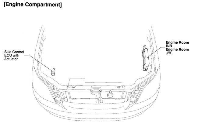

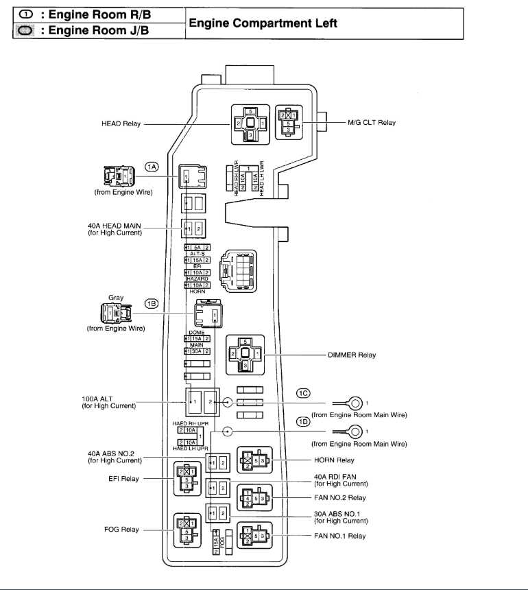

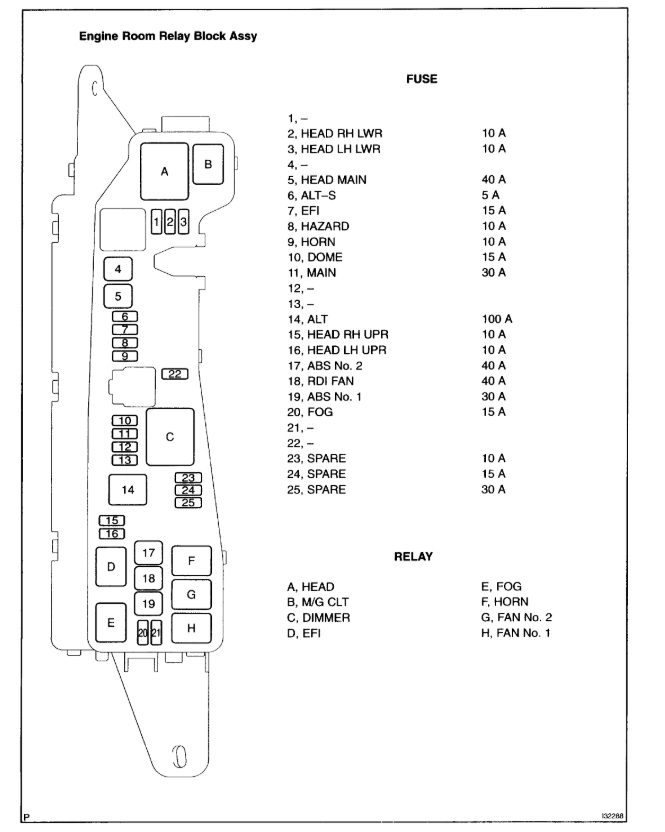

need to know location of A/C relay.
Apr 13, 2017 at 4:29 PM
HMAC300
  • 48,601 POSTS

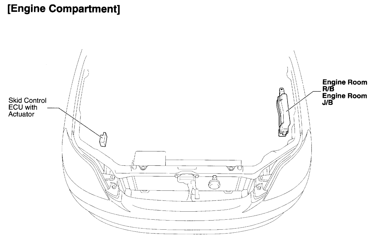

the air conditioner compressor relay is called a M/G CLT relay under the hood here is a guide to help test it with the location of the fuses and relays below.
