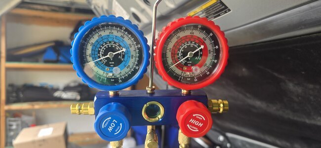

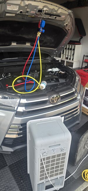

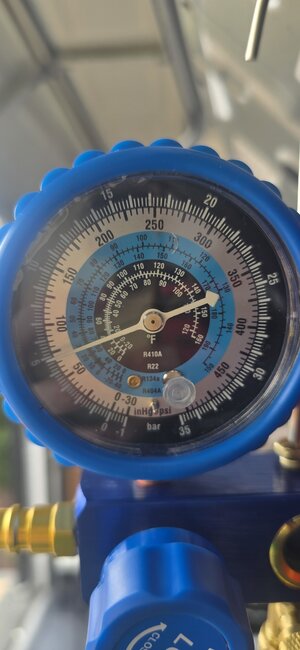

I had a rock impact on my a/c condenser. I replaced the condenser. I have evacuated, vacuumed the system, and verified no leaks.i have 12 oz cans of refrigerant. Yes it is the proper refrigerant. I have both the high and low manifold ports closed and both hose to car lines open. I connect the can and open the flow. I then open ONLY the low pressure manifold and the low pressure gauge appears to equalize with the can. I cant seem to get enough refrigerant in the system to trigger the compressor to pull the rest of the refrigerant in. I believe this to be the case because the high pressure gauge is still at -30 inHg. I had the car on and A/C on full blast, recycle, etc. I also have 2 fans blowing into the front of the car. I did not take photos of the gauge after vacuum but both gauges read and held -30 inHg. Everything is completely closed currently. Gauge depicts current pressure. No air or other has entered the system.

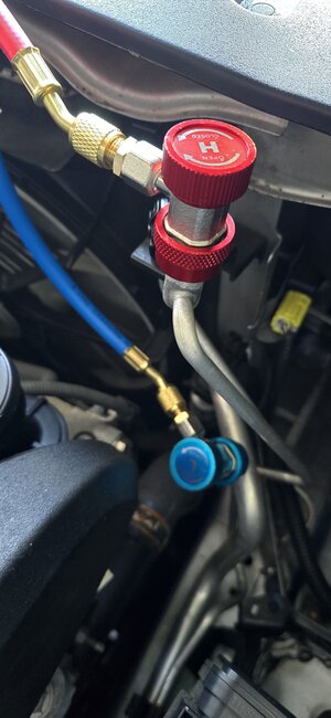

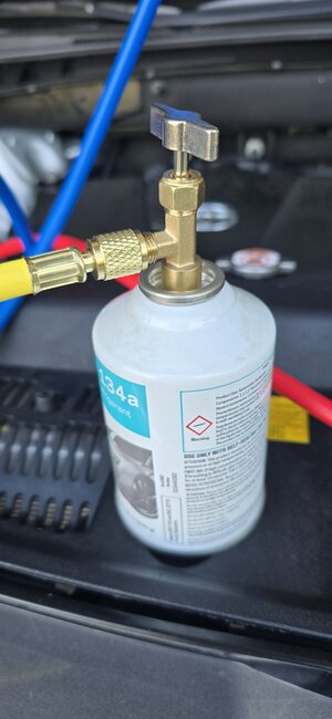

OK, You connect the line to the can, pierced the can, then opened only the LOW side valve on the manifold. The low side valve on the car is open as well? If yes but you are seeing no flow, close the low valve and the port valves, now try purging the manifold by opening the can valve and the manifold low side, do you get 134 at the end of the hose? If yes then reconnect the manifold. Now with the engine OFF open the high side manifold valve and port on the vehicle. Flip the can upside down. Do you see any change on the low side gauge? If yes, let it empty the can. Then close the high side, connect the next can and start the engine, see if the compressor now pulls in the gas you put in. If it does, continue charging on the low side. That system takes about 28 ounces normally so 12 oz should at least get it to kick on.

Thanks Steve. Yes, the low side port was open and I clearly saw some r134a move through the viewing chamber. I will try this in the morning. First verifying r134a traveling through the low side hose before following your instructions for high side introduction for the first 12 oz.

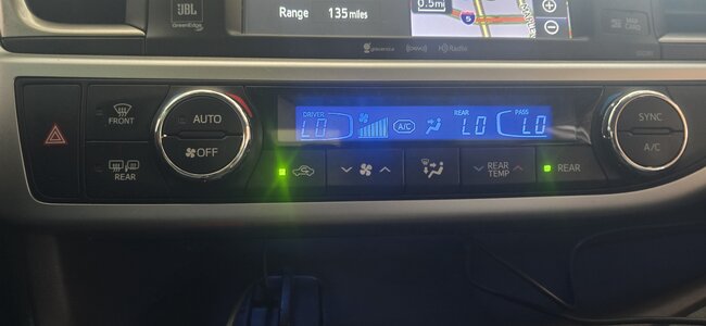

Car is running. cold a/c flowing. But it does not seem to be taking refrigerant through the low side with the new can. My guess is a bad valve connected to the car port. Can I add all the refrigerant through the high side with the car off?

99% sure compressor kicked in but system only has ~12oz and current connected can is not getting lighter or colder. The can is opened and distributing.

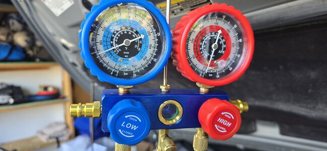

Try this, remove the low side connection from the car, then with the recharge can on the manifold set, open the low side valve to see what the pressure inside the can is, this will tell us if the can is connected correctly and if there is refrigerant present.
Aug 3, 2026 at 1:24 PM
MCSWANSON11
  • 31 POSTS
This is the pressure rating. It is equal to the can pressure.
Aug 3, 2026 at 1:30 PM
  • 55,758 POSTS
Yep, you are good. So when you open the valve with the system on and running with the low side connected what happens?

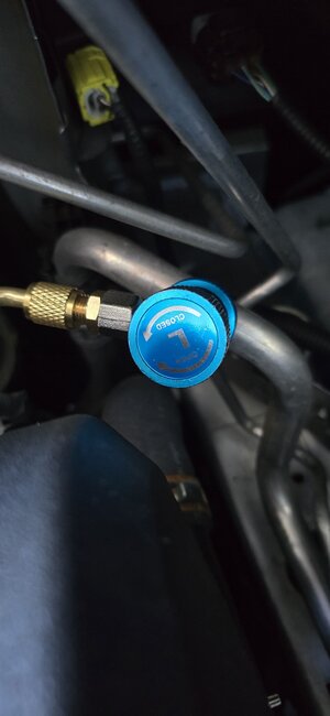

It is like the valve on the manifold set is not opening the low side AC system valve so refrigerant can flow into the system, double check that the low side manifold valve is fulling tightened onto the service valve. No worries on the frustration, we all have been there done that. Please check out this video as well.

Haha funny that is one of the videos I watched a couple times. Thanks for the grace too. Everything is securely fashioned.

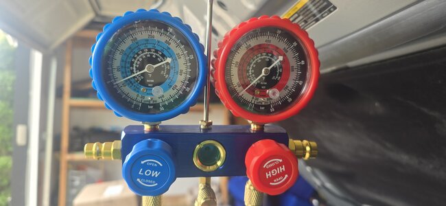

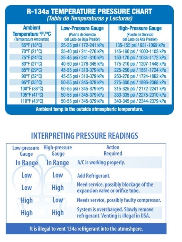

The problem with using the high side is that it's VERY easy to overcharge the system. If you run it as it currently is, what are the high and low side pressures? I'm just looking to see if the system is functional. Then you could add a second can on the high side BUT only once the system stabilizes. That would put you at about 23 oz (you lose some in the hoses) that should at least get you cold air. Normally what you need to see on the gauges to be able to add is for the compressor to pull the system down to 20-30 psi with the compressor on. Then it comes down to the temperature you are working in. If you look at the attached chart for the normal pressures at given temperatures you can see what a good system would run at.

Thank you. I will use that chart and cross reference what my current setup is to confirm proper function before adding more refrigerant. The system has to be working since I am getting cold air with only 12 oz of refrigerant.

And to answer your question.
That image is what it ws consistently running at. And it was between 70 and 75F today.

Just want to close this out. I believe I have a fully charged and working a/c system again. Thanks everyone for the help!
