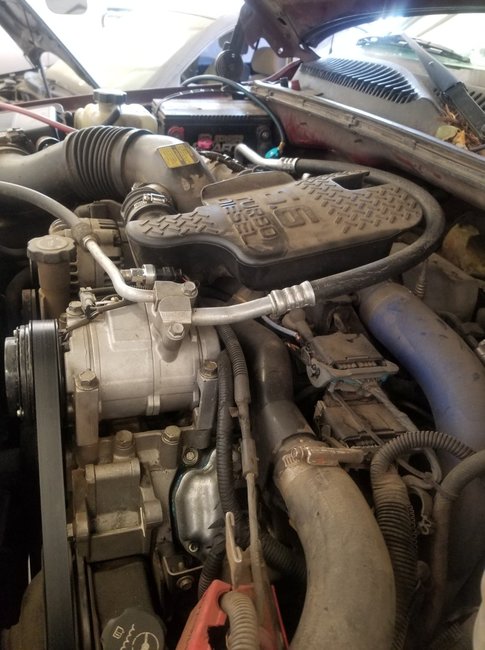

Very odd situation, I own a shop and have a new A/C machine. System holds vacuum and has no leaks. When properly charged, system blows nice and cold. This vehicle has a brand new compressor, accumulator, O-tube, fan clutch, and the condenser has been flushed and blown out. Also has a new high pressure switch, which apparently does not actually shut off the compressor when the pressure gets too high...
What it does is randomly blow off the Freon. usually if I catch it quick enough it will only lose about a half pound of the 1.7 this system holds. but I even drove it with gauges on it and watched the pressures, which were perfect while driving, and most of the time even while stopped. but occasionally would climb to 450 psi plus and I would shut it off so it wouldn't blow and as soon as I started moving it seemed to drop the pressures. Also, while in the shop I had it start increasing pressures, like there was not enough air flow, but then the fan started pulling a bit more, still at idle, but the pressures dropped, and it was blowing cold...
Everything is in a stock configuration, all original components are in place...
More oddly, my brother has a 2003 Chevrolet Duramax, his is manual, mine is automatic system, that just recently did the same thing.. blew off most of the Freon at idle.
Of note, the High and Low ports are only about a foot apart, with the O-tube separating them and the pressure issue shows on the gauges, so it is not a blockage in the condenser or elsewhere. it appears to be an air flow issue.. but should cut itself off I expect that it was doing that previously, because it would go into swamp cooler mode at idle? warmer humid air, but now, instead it blows off the pressure .
Thoughts of ideas are appreciated. I am going to look at the electrical to try to see why the over pressure does not cut off the compressor clutch...

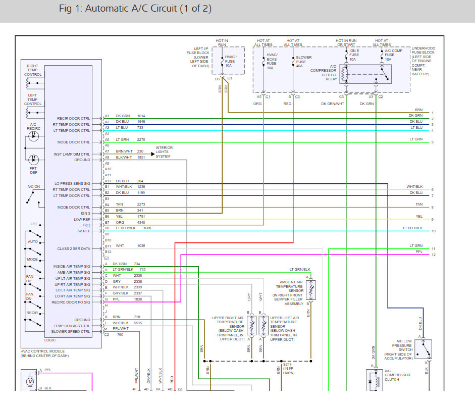

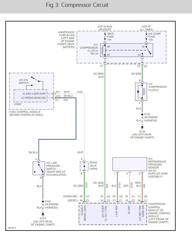

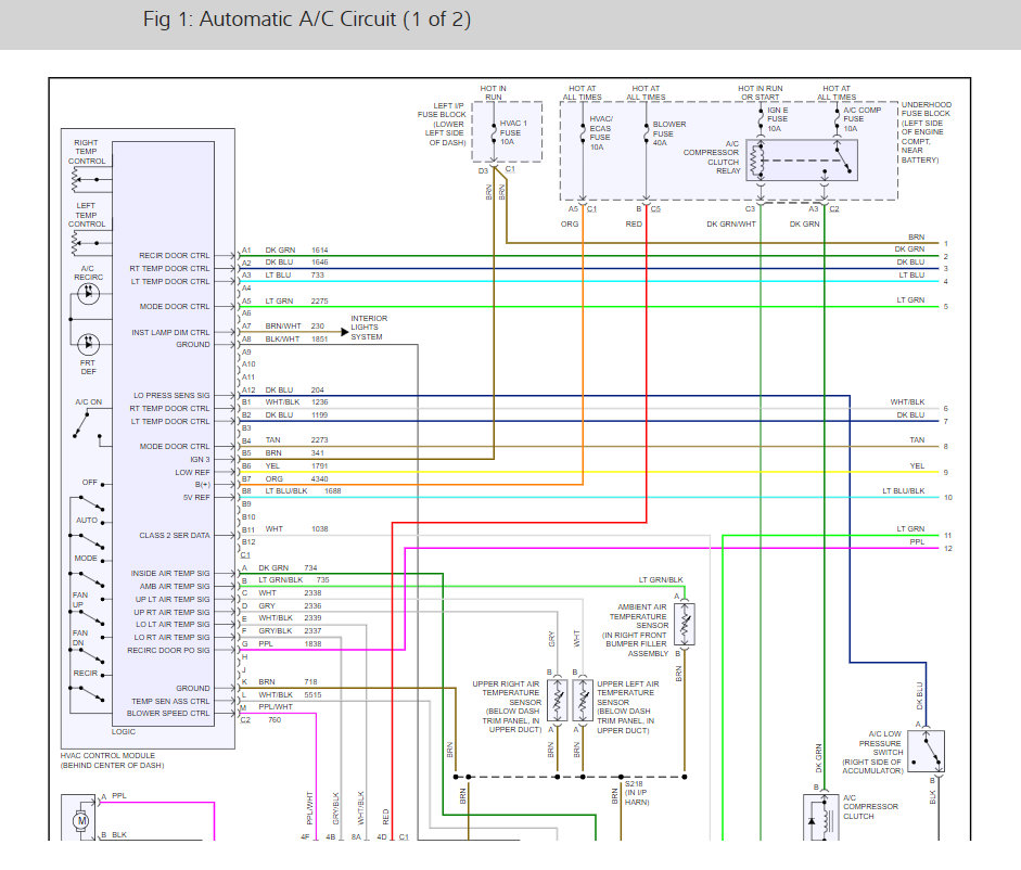

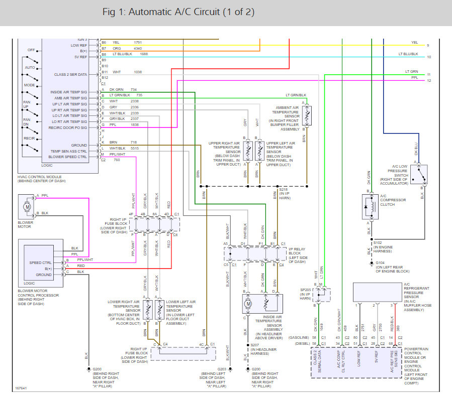

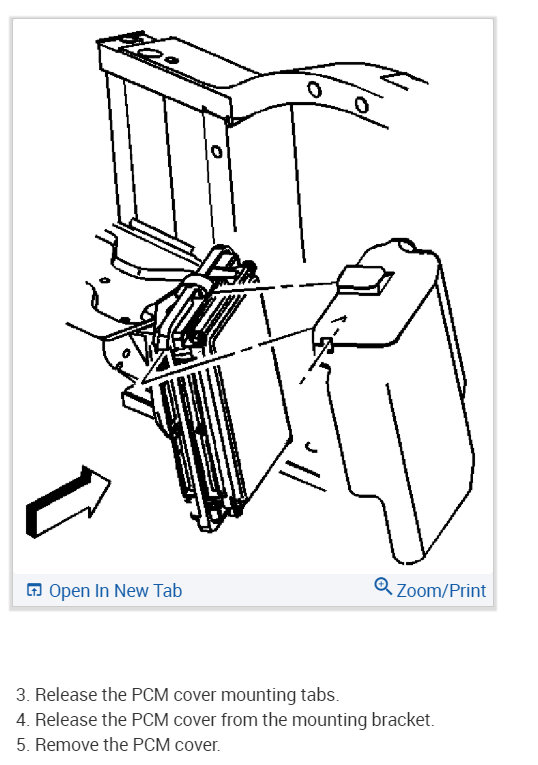

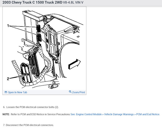

Lets check the connection between the pressure sensor and the PCM. here is a guide to help and the air conditioner wiring diagrams to help (below). It could be a bad PCM.

I have already checked values, but my MODIS only tells me A/C "granted" yes or no.. I would like it if it had a voltage reading also, but it does not. I already had looked through the wiring diagrams, 3 wires straight to the PCM.. but it seems nearly unfathomable that the PCM would fail in that manner, when it will turn it off by unplugging it. I think I will feed it 5v by jumpering the sensor connector and see if it says not granted.. that would tell me most quickly if it keeps it off, or allows it to turn on.. I will keep you posted.

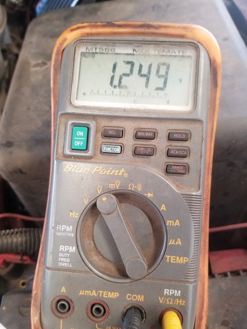

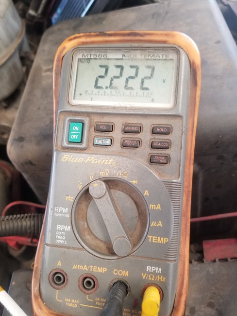

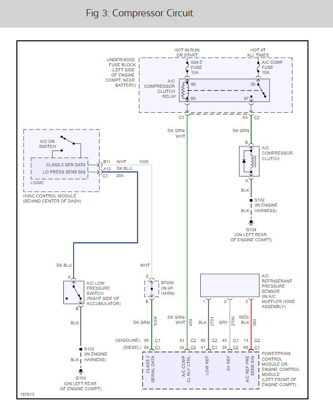

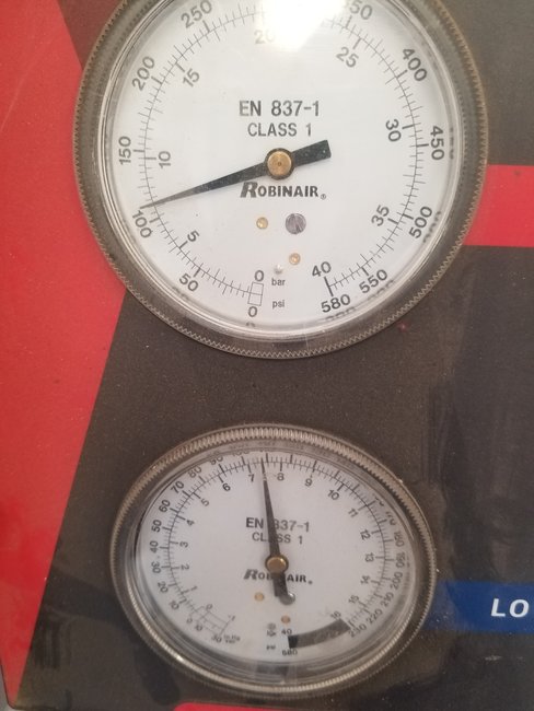

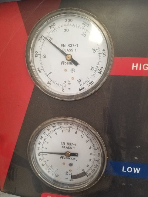

So I just confirmed that it has 5v reference, ground, and signal return. Also that the system will deny the A/C when fed 5v from the reference to the signal return.. so I will get a factory sensor (transducer) and see what that does. although it still won't answer why it randomly goes high in the first place. It makes no difference if it is completely cold, fully hot. .but always at idle while stopped. Sitting at a stop light, sitting in traffic, waiting for a train.. where it used to just randomly cut off the compressor until you began moving again.
Attached are the values.. static, system off and running at Idle.
Again, I'll keep you posted.
If anyone has a voltage to pressure value, that could be useful, but I have not found one yet. (although it appears to be about 1v to 100 psi)

To clarify that last test, it was done while the engine was running and A/C on, working normally. then fed the 5v to the sig ret. as though it got there suddenly on its own. while there was a several second delay, it did deny the A/C while fed, then after about 15 seconds after removing the 5v it granted and began running the compressor again.
Sep 5, 2019 at 7:57 AM
  • 55,746 POSTS

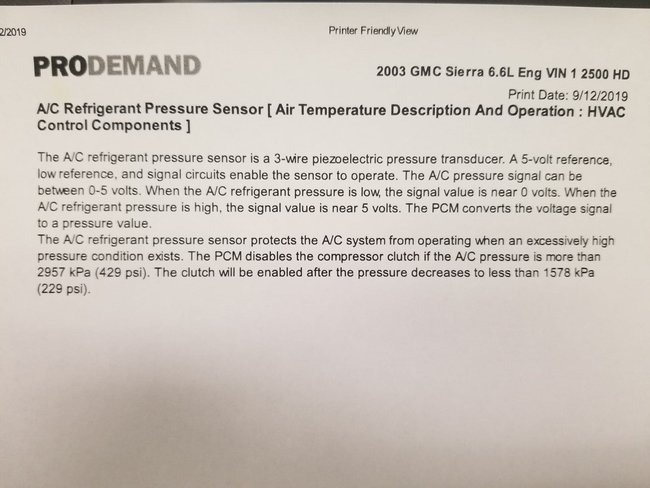

The pressure looks a little low. so you say it goes to over 350 and blows the pressure valve? sounds like too much oil. Have you checked that? Also, once the pressure valve blows you need to replaced it because it becomes weak after the first event. lastly I have seen PCM's go out in every way possible so this would not surprise me FYI. Here is how you would replace the PCM. Here are the air conditioner wiring diagrams as well:

So, the over pressure valve does not appear weak (and holds), and the aftermarket compressor does not come prefilled with oil (per warnings on the box, and installation instructions), so it is unlikely that it is overfilled with oil. Beyond that, that should be a consistent issue, and not random. The new AC Delco high pressure transducer has corrected the blow off issue, apparently the aftermarket does not meet specs (or was simply defective), and the original one had failed as I suspected...so the PCM is not the issue.
Currently, it still randomly goes into the "swamp cooler mode". where the compressor cuts out due to high pressure, and you get very humid air, and no A/C...but this is not predictable as to when, and works normally as soon as the vehicle starts moving again. It may do it right out of the driveway, at the first signal, or go several days before doing it and when it began doing it in the shop, it seemed to be headed towards blow off. achieving over 450psi, when the fan started pulling a little more air, and the pressures dropped back to normal. The pressures in the pictures were a little low, as I had not realized it had blown off about 5 ounces of Freon.
So currently I have not found an explanation for the random high pressure, as it seems to simply be an air flow issue...but has a new fan clutch and all (radiator, inter-cooler, condenser)components were blown out, and do not appear to have any restriction.
I am considering putting an auxiliary fan in front of the condenser to "fix" the issue, but that should not be needed.
(Also, the pressure does not blow until about 550 PSI, and is supposed to cut the compressor at 426 PSI).

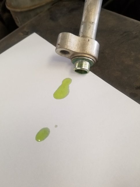

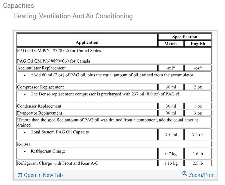

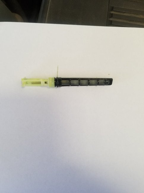

Yep, sounds like too much oil in the system the oil being forced through the orifice causing the high pressure. I would vacuum the system to take oil out then remove the low side hose to look inside to see how oily the system is. Can you please shoot a quick video with your phone so we can see what's going on? that would be great. You can upload it here with your response.

It appears to call for 7.1 ounces...and I have not added much back to the system since all the blow off, and loss at the compressor...during the recovery process, it had only removed a few ounces, and I have not been adding it back, concerned about too much oil. Last time I recharged it I added back 3 ounces...after not doing so previously.
I have never experienced a random issue like this, where all it takes is air flow to correct the issue...and searching for symptoms of being over charged with oil, I do not find anything like this, as it blows completely cold, with no symptoms except the random high pressure issue. (Note:I have been working on A/C systems since I was 17 years old, so the last 36 years)
As stated, this only happens at Idle, when stopped, so I'm wondering if there is a symptom chart that suggests it is over charged with oil? Perhaps something unique to Duramax systems, even though they are just a standard GM configuration.
(SYMPTOMS of too much oil

Also, if that were the case, it seems the O-tube would be saturated each time I removed it to inspect, and while it has oil on it, there has never been oil coming out of the line when opened up.
Also, to make sure I cleared any blockages...last time I opened up the system, I pulled the orifice tube and activated the compressor. then put my thumb over the line to build pressure, then released it several times to make sure there was nothing plugging the system...which should have also gotten extra oil out of the system.
Just trying to understand what suggests to you that oil is the issue.

I noticed the Denso replacement comes with 8 ounces of oil in it. did you add oil when doing the job? Check out the diagrams (below). Please run this test and get back to us.

Not sure which test you are referring to? Apparently the Murray compressor I installed comes pre-charged with 3 ounces of oil (not 8 as you said the Denso does), and after flushing the condenser, and replacing the accumulator, and having blown pressure off at the compressor several times.. I have added approximately 6 ounces total.. which means that (if anything) the system would be low on oil.

You cannot get the oil out of the system it sits in all the low spots, I would judge the systems oil by inspection. Open the low side hose and look inside if it is super oily you have too much. Please undo the low side and upload a video or picture of the inside of the tube for me please. It is the only thing that can cause this issue.
Sep 11, 2019 at 3:04 AM
KEITH WARKENTIN
  • 23 POSTS
So to answer all the questions, I got about 3 drops of oil from the compressor end of the low side hose, as shown, there was about a drop on the orifice tube...the video is of me putting 150 pounds of shop air through the condenser to see if any oil would come out, which it did not...as noted on the white paper...the only oil was from the orifice tube sitting on it prior to blowing out the condenser.
If there were too much oil, I should have gotten some from the condenser...as that is one of the places oil will puddle.
Your suggestion that oil going through the orifice tube would cause the random high pressure should require there to be significant oil running through the system...yet that is not what I find.
I cannot find any other suggestion that oil will cause this...usually it causes a performance issue.
Sep 11, 2019 at 5:39 AM
  • 55,746 POSTS
Thanks for the pictures and video, the oil looks good, I will put this one out to the community to see what comes back but, does the clutch fan kick in can you hear it come on? The only other thing that can cause this is high temperatures. Only can you not fill the system all the way to see how it performs? Just a little to much Freon can cause this as well.

What is the low pressure?

to me it sounds as if the screen at orfice which on older models was replaceable. partially blocked or getting that way.
Sep 12, 2019 at 4:28 AM
WRENCHTECH
  • 20,760 POSTS
A plugged orifice will not cause high discharge pressure. It's on the suction side of the system.

It's also possible to have the dessicant come out of the receiver drier and clog part of the system, and also the rubber lines can come apart from the inside. Just a thought.

Currently, with the new AC Delco high pressure transducer, it has cut the compressor instead of blowing off the pressure, but the last time was 2 days ago...currently the system seems to be working normally most of the time, yet still occasionally has this failure. It seems to be an airflow issue...like the fan clutch (which is new, attempting to fix this issue) just doesn't pull enough on occasion, but the truck itself never gets hot, and I can hear it kick in hard when the temp gets barely above the normal mark. This is just a drive you up the wall issue...but at least it's my truck instead of a customers...lol...this has been going on quite awhile, but I previously didn't know the cause...since it would only tell my on the MODIS scanner that under that PID that the a/c was "not granted" but did not tell me why. After it blew off the pressure, I finally saw what was happening, and have a better understanding of the system...but still have no answer as to why,

Orifice tube can cause high pressures..as it it the dividing point between high and low sides, and is actually what gives you a pressure difference. On an expansion block system, that is what does it...
If you have a plugged O-tube the pressure will definitely be high...but all the time...not random.
