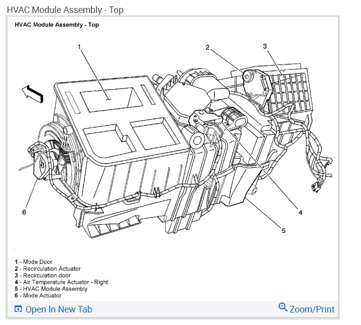

The second problem is that the system randomly stops blowing air out the vents. When this happens I cycle through all the vent positions and hear air switching and changing internally. You can hear the air blowing and can also hear the blower motor running, but no air comes out the vents. I suspect the controller but was hoping to get a second opinion here before dropping money on a controller. they are not cheap! Thanks.

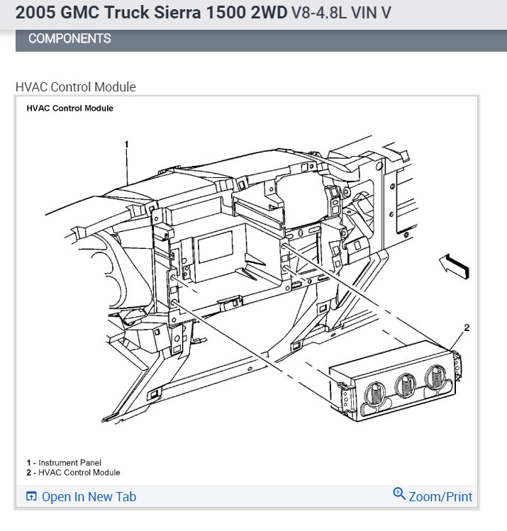

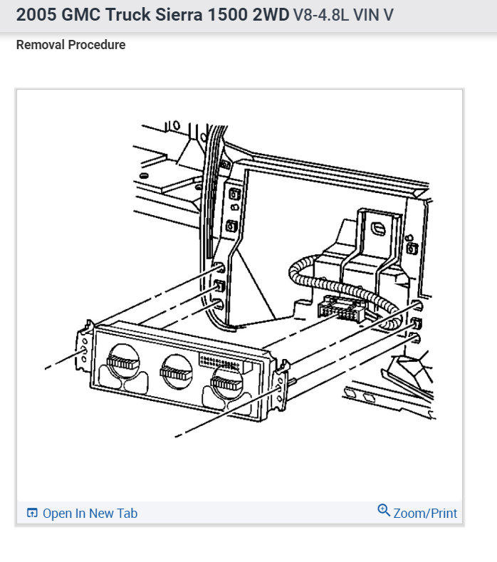

Yep it does sounds like the controller is loosing its calibration but lets reset the system to see if it holds one last time before replacing the control module. If it doesn't hold here are the replacement instructions and diagrams to help.
Remove the HVAC fuse and turn the key on for 1 minute then turn the key off and replace the fuse, then turn the key back one and let site for 1 minute. It should reset.

1. Connect the electrical connectors to the HVAC control module.
2. Install the HVAC control module into the instrument panel, ensuring that the HVAC control module retaining tabs lock into place.

Check out the diagrams (Below). Please let us know what you find. We are interested to see what it is.

The air stop blowing part sounds like the evaporator core could be icing up due to lack of charge. Also the drivers side actuator can be out good call on that. here is a guide to help:
Let em know how to goes once you have replaced the control head and actuator while checking the refrigerant level.
