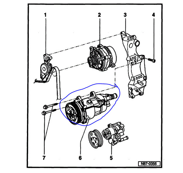

With gauges hooked on ,engine running, A/C clutch will engage but there is no pressure change occurring on either side of the system. Static pressure is around 95 lbs. Clutch will activate when A/C switch is pressed and when fan is turned on and off.

Is that the high and low side readings? Are you using a gauge set?
If the pressure does not change and the pressures are equal, the compressor is the failure.

Thanks. I was pretty sure that was it.

Pressure was equal on high and low sides with gauge set.

Okay, thanks. I would replace the compressor, dryer and evacuate and recharge the system.
