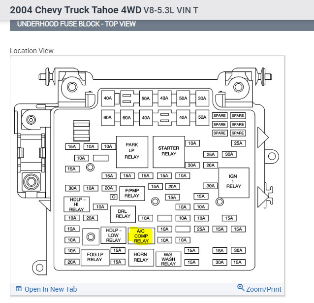

When I first started up the vehicle the A/C compressor was clicking on and off and now it sounds like it is on all the time.
The vehicle listed above is an LT model.
Apr 3, 2023 at 3:38 PM
  • 110,194 POSTS
Based on your description, it sounds like the compressor clutch relay went bad. At least, that is where I would start.
The relay is in the under-hood fuse box. I attached a pic below showing its location. Remove it and switch it with a different relay in the box having the same part number. See if makes a difference. Also, when you remove the present one, check to make sure the connectors in the box are in good condition and free of corrosion, as well as give the relay a shake to see if anything sounds loose in it.
See pic below.
