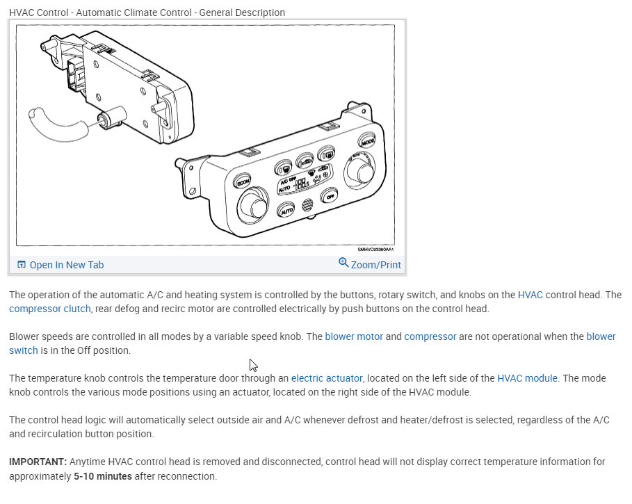

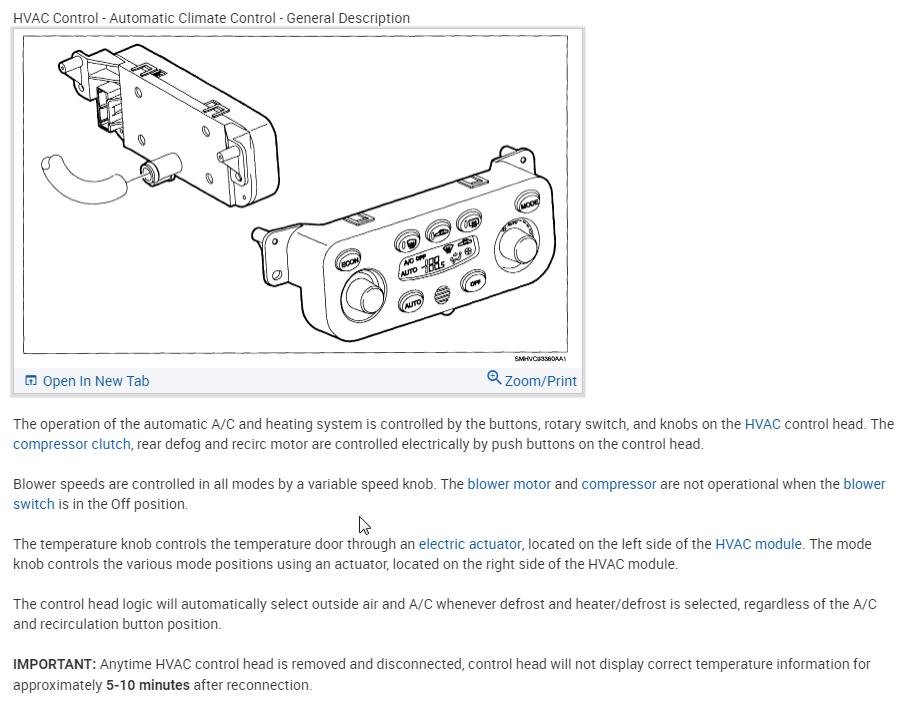

My display for the A/C doesn’t come on anymore! Why?
Jul 16, 2019 at 4:35 AM
Hi Livewithit,
I just want to make sure we are on the same page. The display unit where you see the temperature doesn't work anymore? If so, this control unit is contained as one unit. If just the display is not working then more than likely you need a new control unit.
Here is some information about it. Let me know if you need anything else. Thanks
