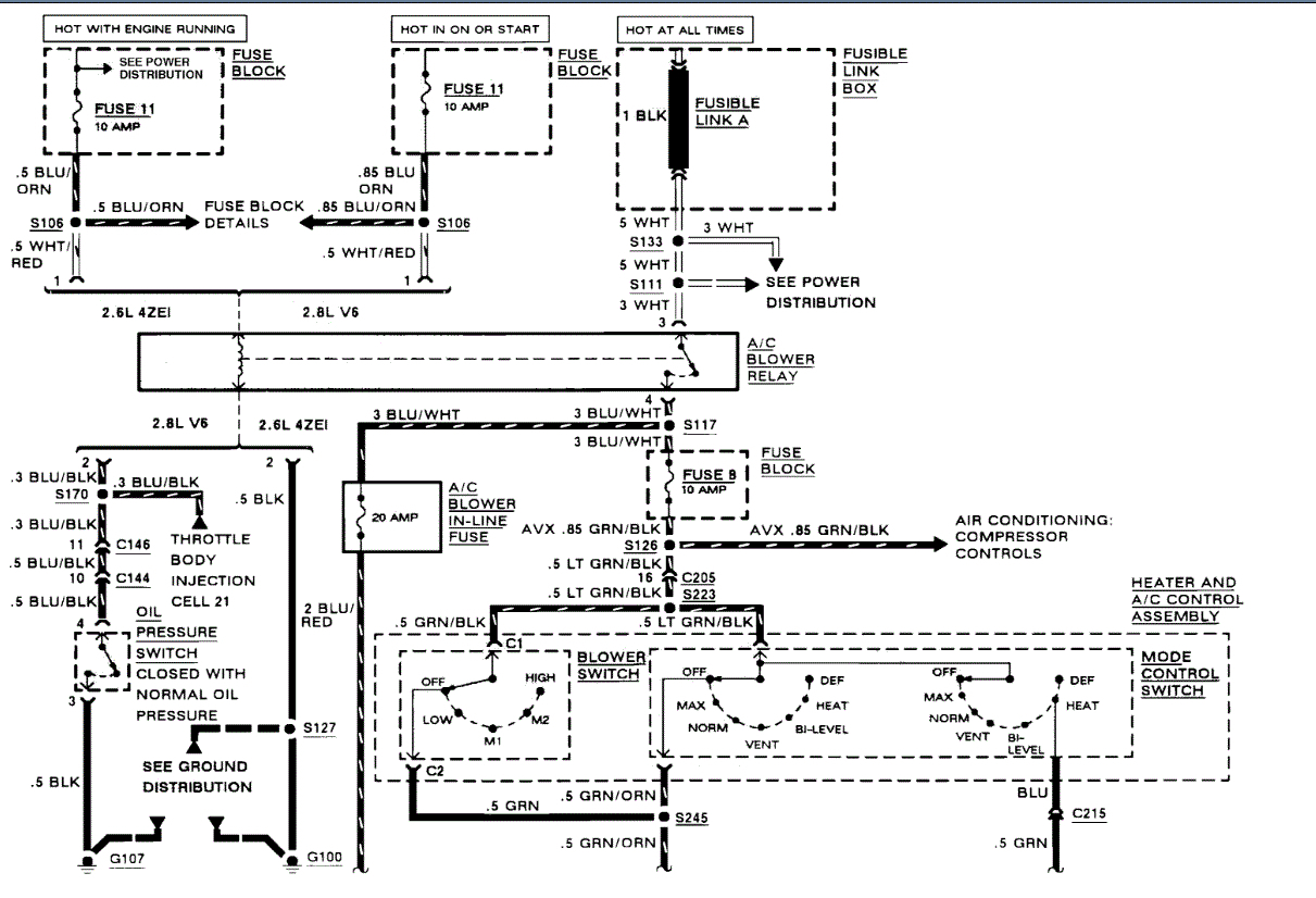

The pickup listed above A/C blower motor will not work. I’ve tested the motor by straight wiring and it works. I have no power at the blower fuse. When straight wire the blower fuse it works. Does some one have the wiring schematics for this system? I know something in the ignition should give power to that fuse. What ideas do you have?

The Adventure isn't offered in the US. However, I believe it is the same vehicle as the Trooper II.
I attached a pic of the wiring schematic related to the blower motor for the Trooper. Let me know if it helps.
