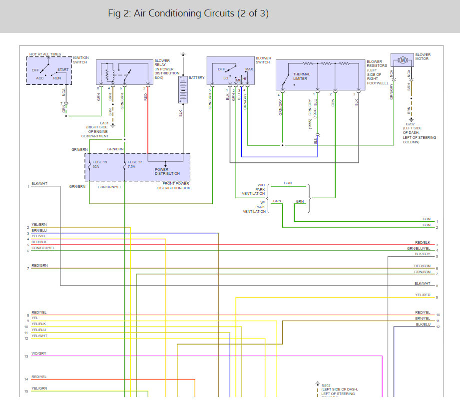

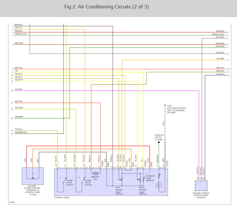

Thanks Danny, My hopes were up prematurely. Problem still exists but, with a new twist. At Lowe's the other day, just about to go inside, my A/C blower is on speed 4, everything stops and blower goes dead. Originally, A/C goes in and out, then doesn't work for awhile, then goes back to intermittent in and out again, now blower goes out.
Checked it before going to work today. Number 19 on the main fuse box(30 amp) is burned up and slightly melted. Put backup 30 amp fuse in and blower works again for now. It's a ten minute drive to work, five minutes in and a/c stops cold and warms up.
What i know is,...when a.c. blows cold,.. Defroster light will work,.. I'm assuming (pretty sure) defroster will run also. When A/C blows warm I press defroster and defroster light does not come on. All the while, A/C light and recirculating light come on when i turn knob to speed 1,2,3 or 4.
Not sure what's going on but I'm thinking your suggestions will be to open this baby up and look for shorts?
Thanks in advance.
Jun 21, 2019 at 11:55 AM
  • 55,711 POSTS

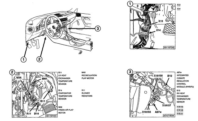

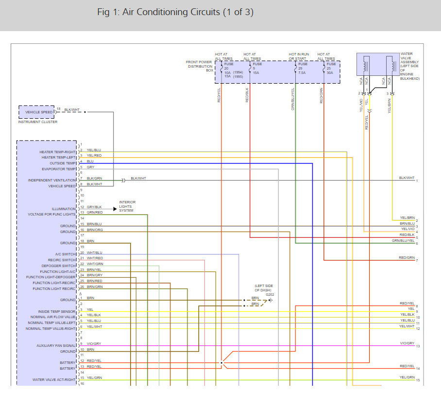

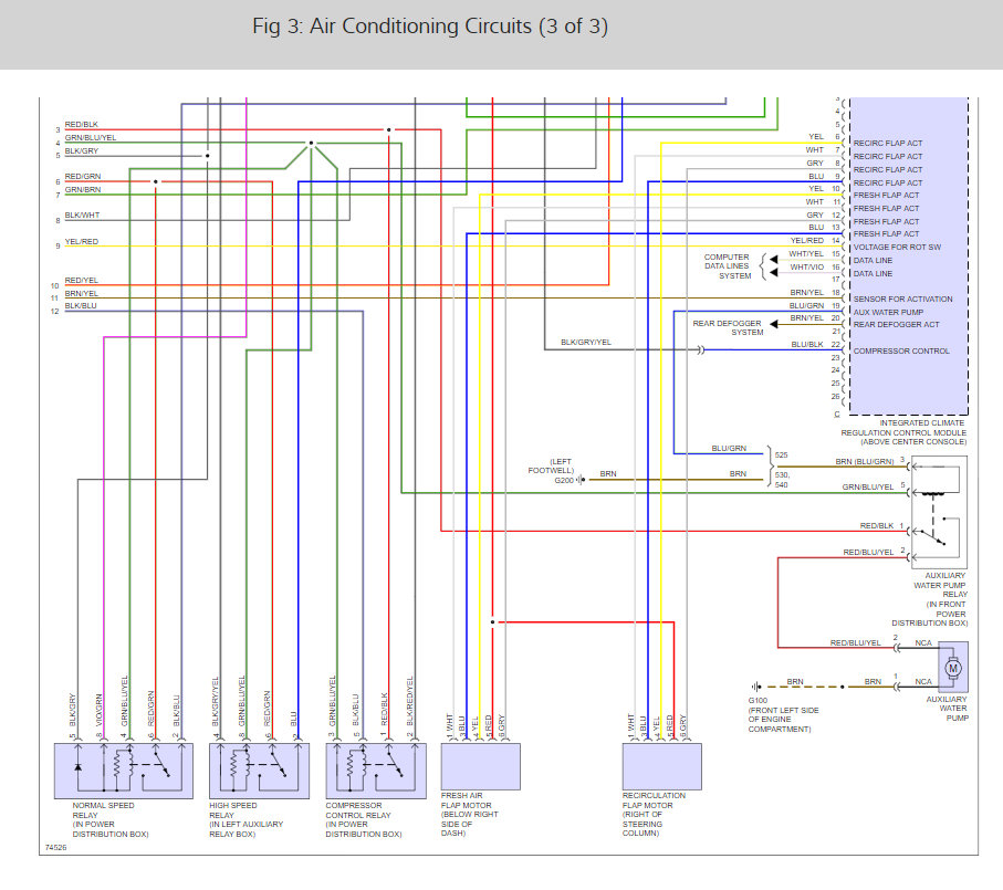

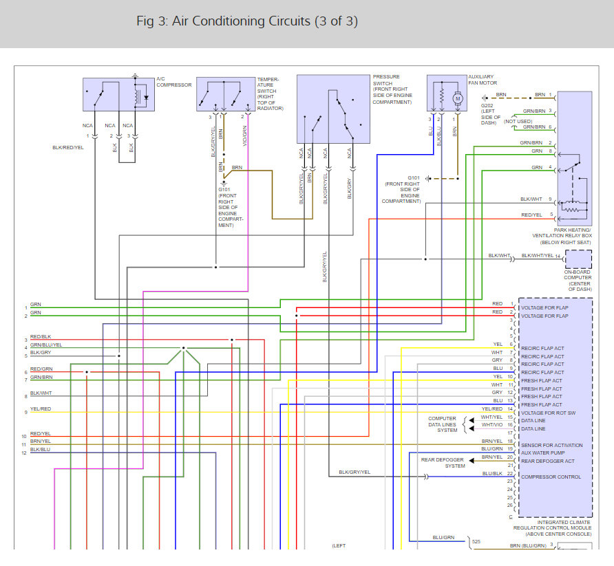

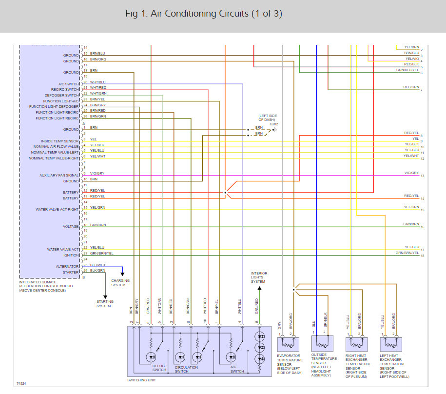

It sounds like the climate control module is going out. To confirm here is a guide to test the power and grounds to confirm the failure with the wiring diagrams for the AC and locations below:
