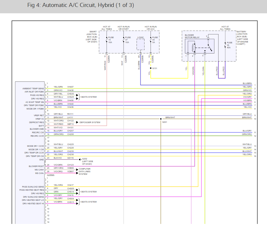

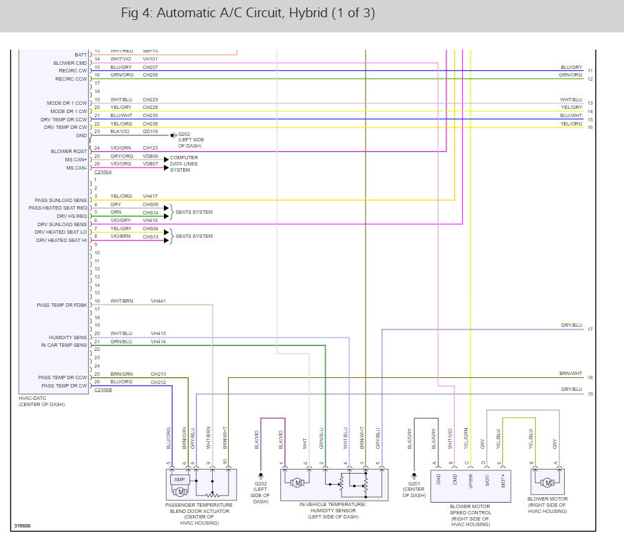

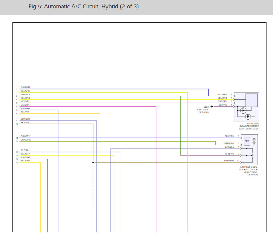

The trouble codes need to be retrieved from the HVAC module, this will give us a direction to go because this system is pulse width modulated in relation to blower motor speed.
Sep 24, 2019 at 2:24 AM
  • 55,402 POSTS

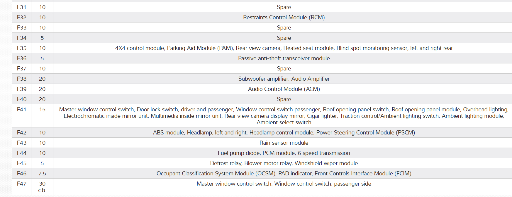

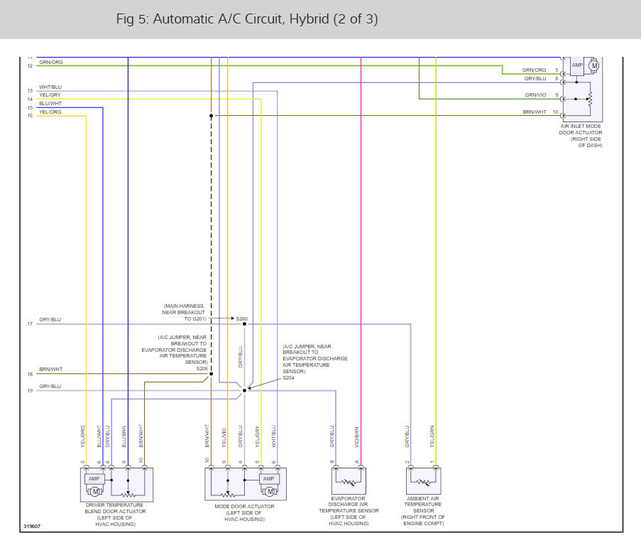

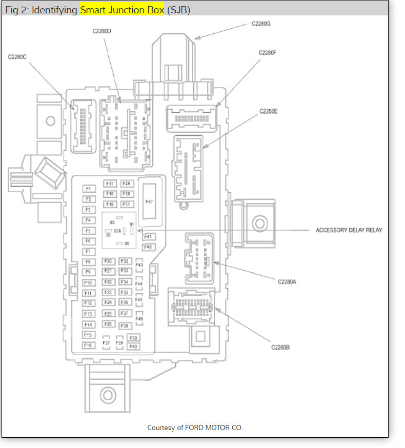

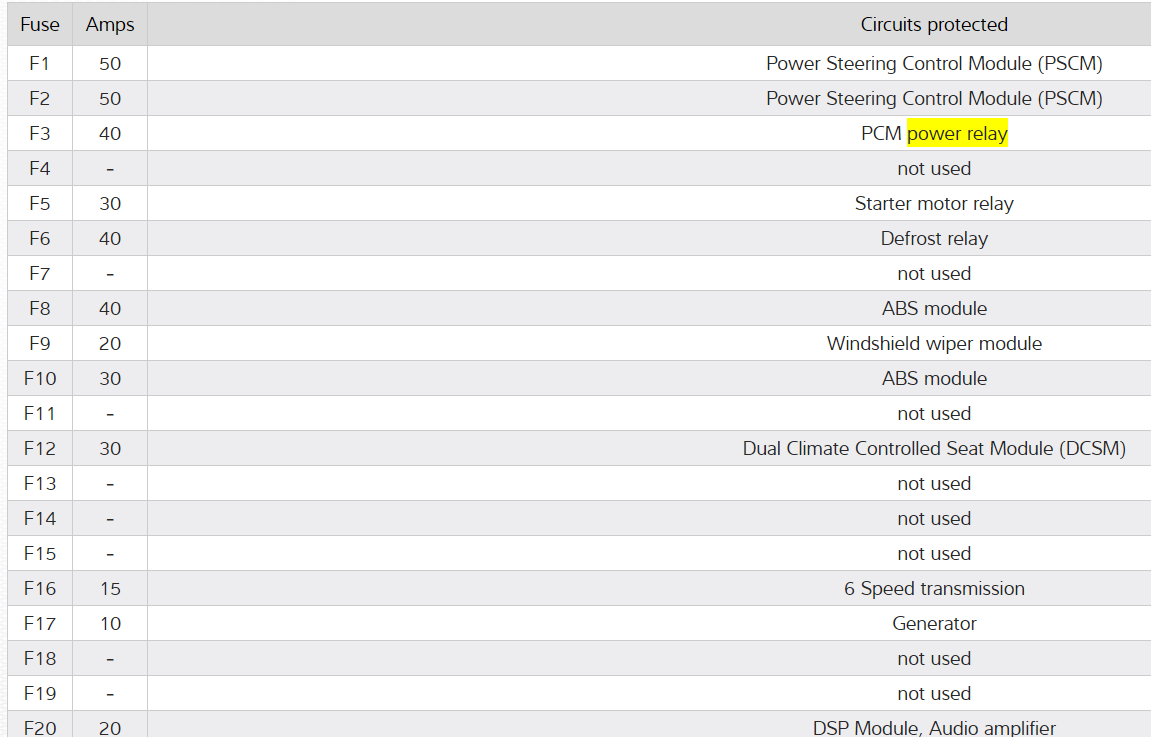

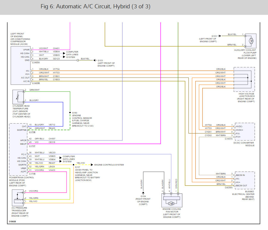

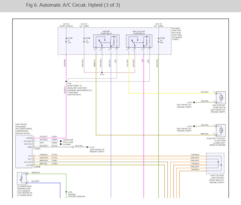

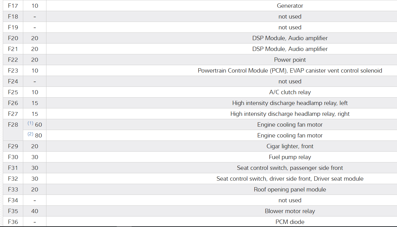

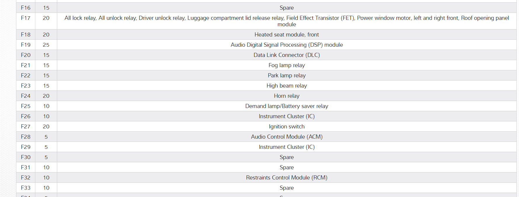

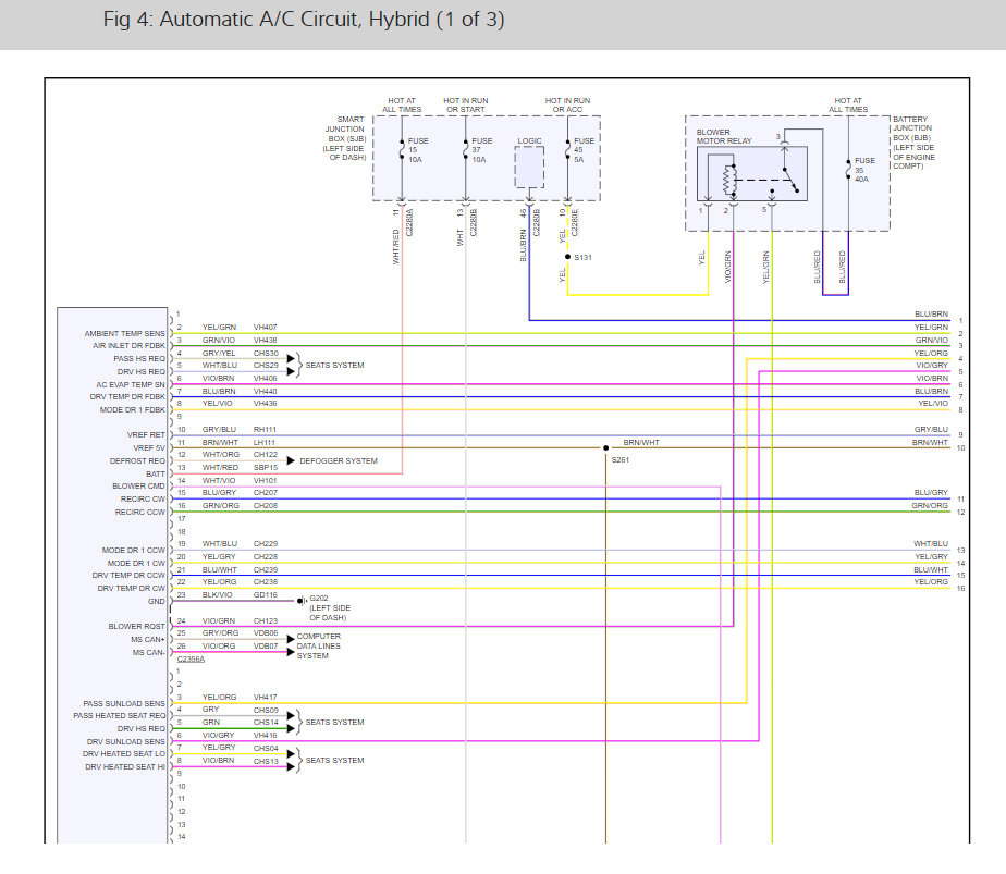

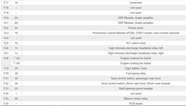

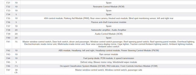

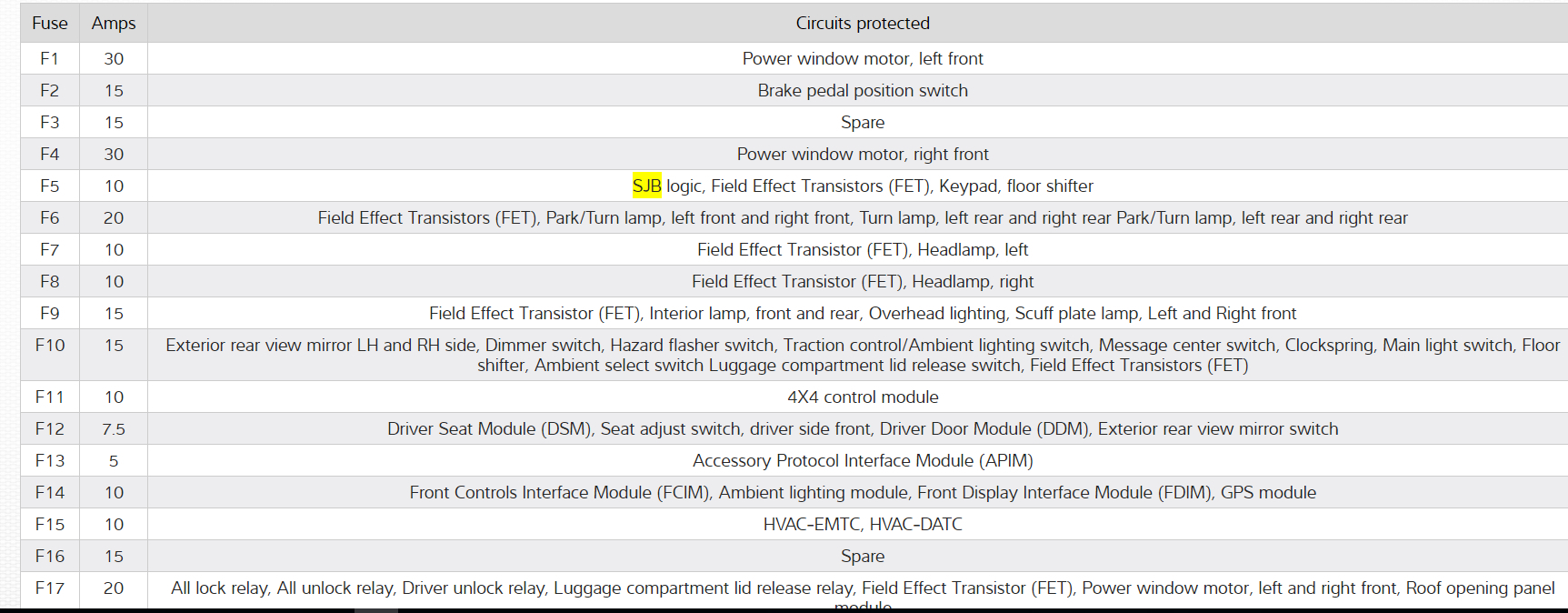

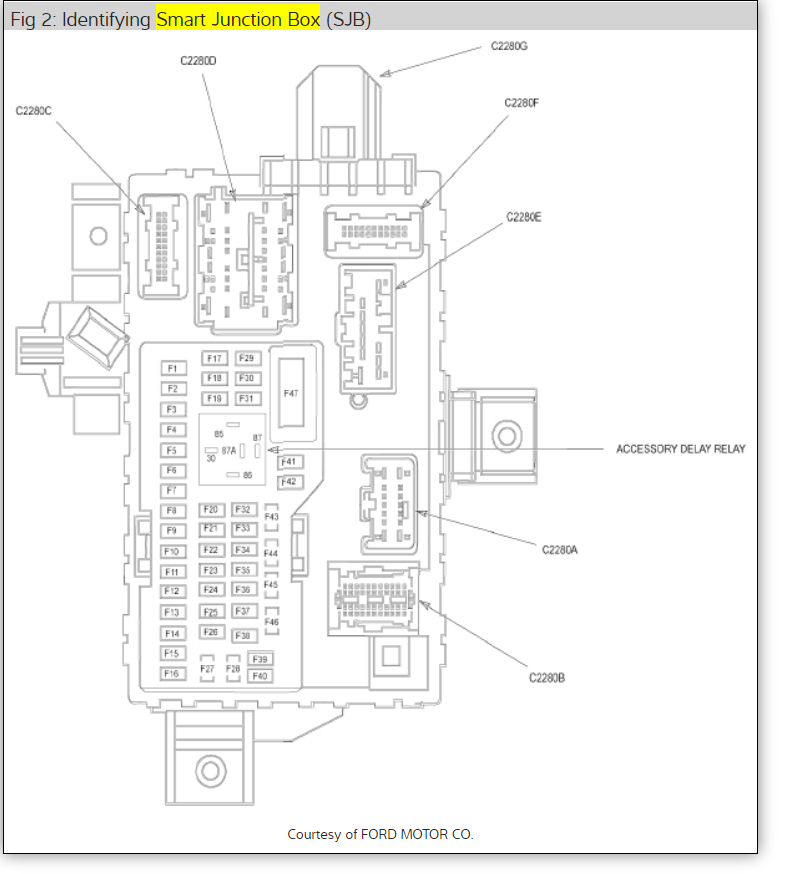

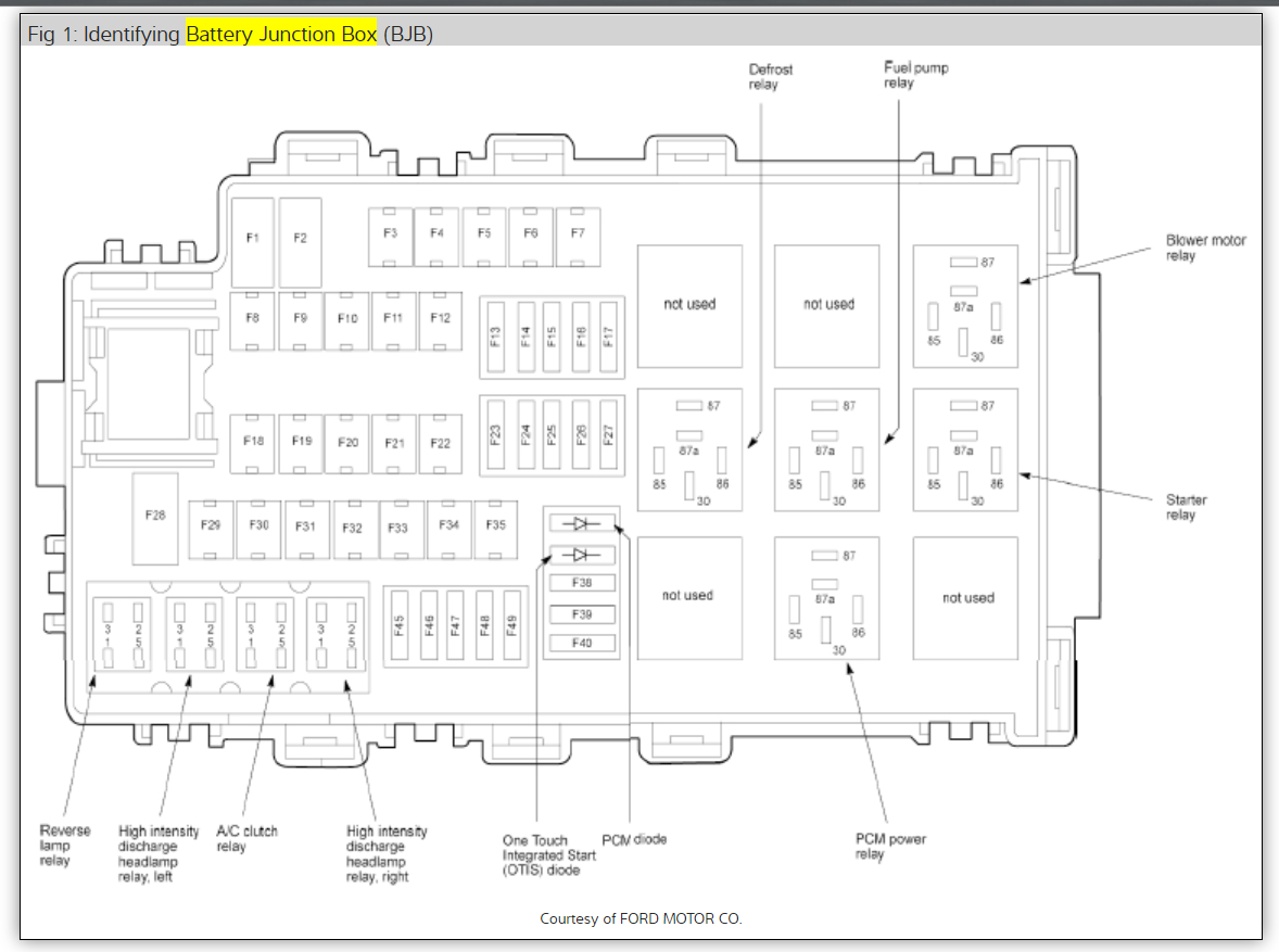

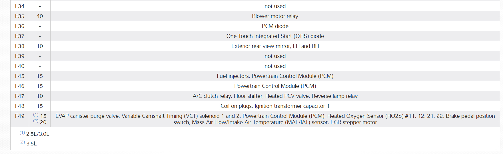

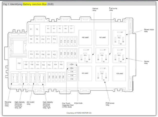

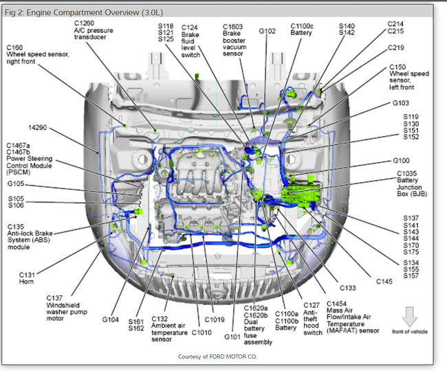

There are 7 fuses that run the system we need to start there here is the HVAC system wiring diagrams so you can see how the system works and which fuses to check. This guide will help with the fuse locations below:
