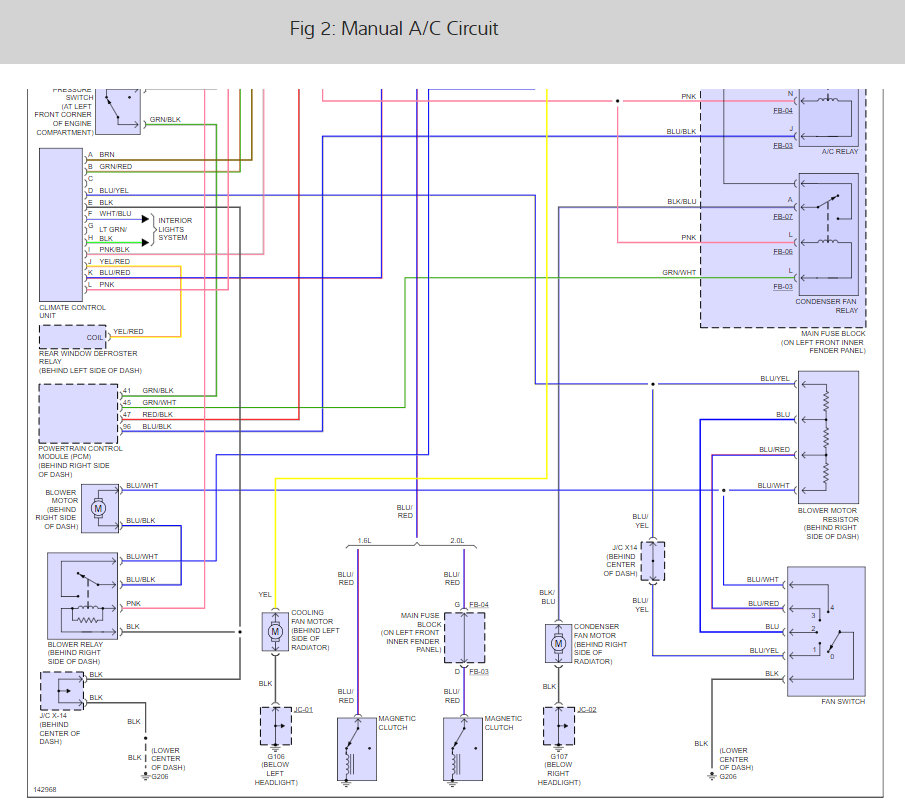

A/C only works on setting 1
200,000 MILES • 1.6L • 4 CYL • AUTOMATIC
JROSARIO08
The A/C only works on 1, neither of the 2, 3 or 4 works, not even the fan turns on. I already changed the blower motor, the blower switch and the motor resistor. What can it be?
Sep 8, 2018 at 10:24 AM
  • 55,748 POSTS

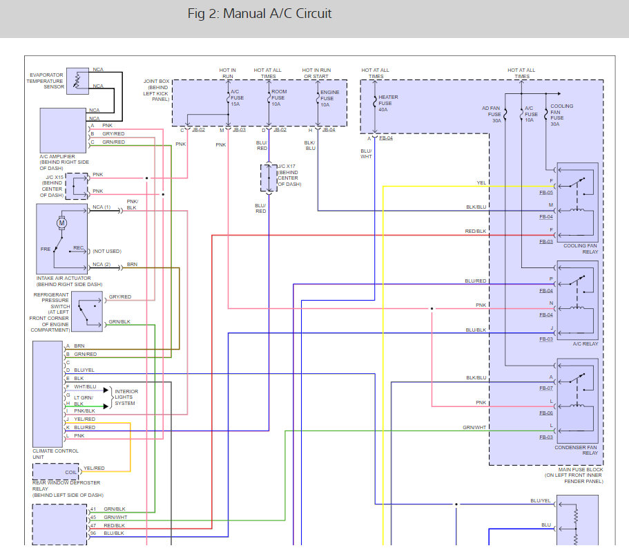

It sounds like you lost the switch ground. Here is a guide to help you test it with the blower motor wiring diagrams so you can see how the system works:
Connect the test light to power to test the ground.
Check out the diagrams (below). Please let us know what you find.
