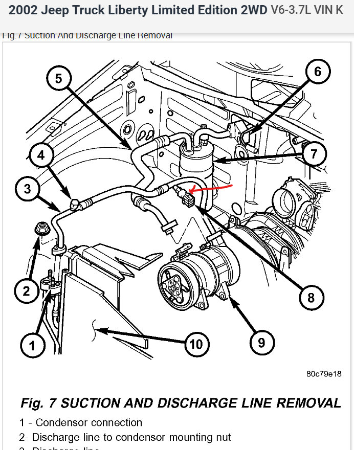

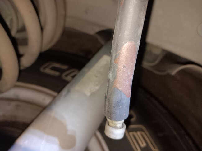

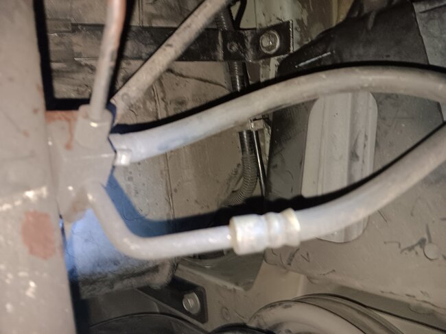

code P1598, which part needs to be replaced? Also, a hose under driver side near canister is just attached on one end. Where does the other end go? pic attached.

The P1598 code for a 2002 Jeep Liberty indicates a A/C Pressure Sensor Voltage Out of Range fault.
This is because the AC pressure sensor has gone out or the AC system is having an issue like low on charge, we should replace the sensor first. Here is the location, it should have a pressure valve under the sensor, so you don't have to vacuum down and recharge the system. If the system does need a charge, this video will help:

I've already done the recharge. Is the sensor to replace item 1,2 or 3 in the diagram? Isn't there a picture of the actual item I need? And why are there 3 names for the same item? Is it a switch, a sensor or transducer?

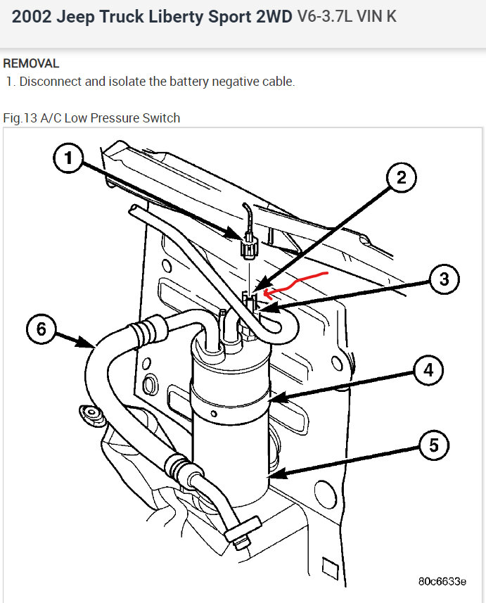

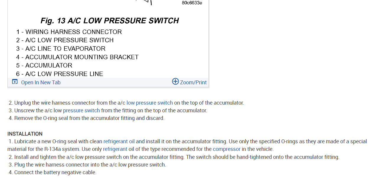

It is 2/3 I don't know why they have two arrows there it is just one part; you should be able to replace the sensor without discharging the system. Once the sensor is replaced, clear the codes. The problem is the code is for a pressure switch, but there are two, one high pressure and one low pressure and the code does not say which one it is. But since you said the system gets cold, I would think it is the high-pressure switch. Check out the images (below). Please let us know what happens.

how do i know which sensor to replace? are they the same to purchase?

Correct they are the same procedure, I would start with the high side pressure sensor since the low side seems to be working.
