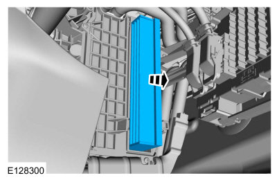

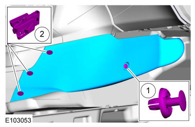

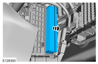

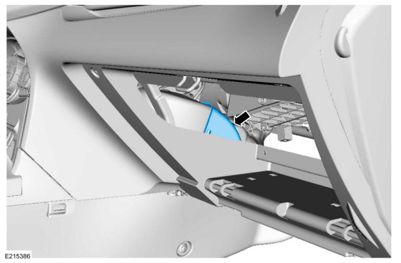

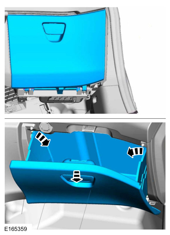

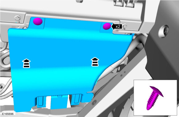

I have to ask a crazy question. Are you using the system on Max AC all the time? If so, that recirculates the air in the cabin and can cause the evaporator to do what you are saying. Also, if the evaporator is dirty, that can cause it also. A plugged cabin air filter will limit air flow and can do it too. Here are directions for replacement. If you never changed it, you may want to at least inspect it. The attached pictures correlate with the directions.
Cabin Air Filter
Base Part Number: 19N619
Removal
NOTE: Removal steps in this procedure may contain installation details.
Remove the push pin, release the clips and remove the RH floor console trim panel.
Release the retaining tabs and remove the glove compartment.
Pic 1
Remove the push pins and the RH insulation panel.
Pic 2
Remove the HVAC duct.
pic 3
Disconnect the electrical connector, detach the wiring harness retainer and position aside the wiring harness. Remove the retainers and cabin air filter cover.
pic 4
Remove the cabin air filter.
pic 5
Installation
To install, reverse the removal procedure.

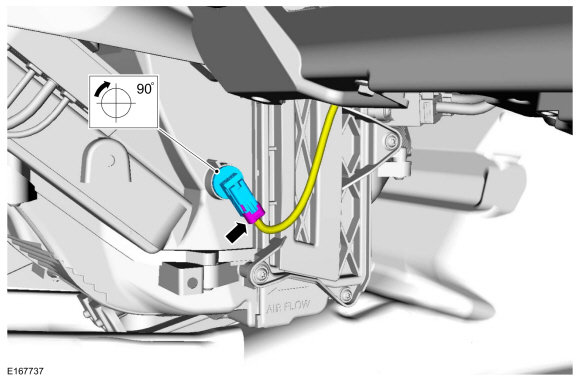

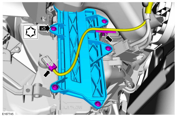

If those aren't an issue, then I suspect the evaporator temperature sensor is faulty and allowing the system to freeze up on you. This is really easy to replace. Here are the directions:
412-00 Climate Control System - General Information 2016 Fiesta
Removal and Installation
Evaporator Temperature Sensor
Removal
Remove the push pin, release the clips and remove the RH floor console side trim panel.
Picture 1
Disconnect the electrical connector and remove the evaporator temperature sensor.
Picture 2
Installation
