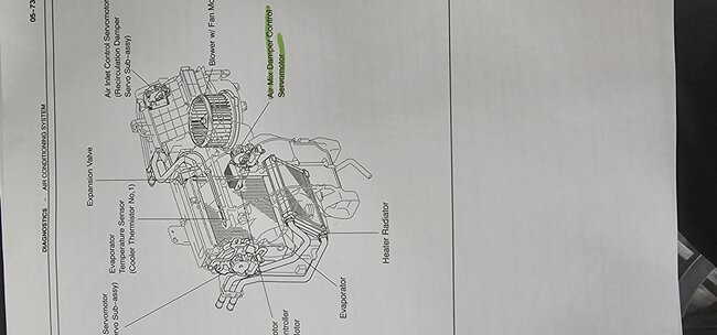

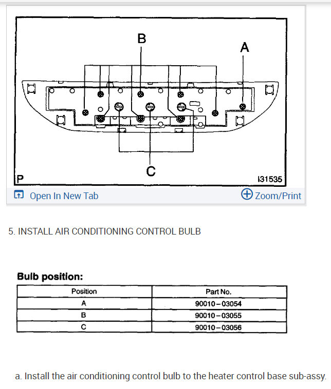

I have the car listed above LE model. The A/C only works on the passenger side. On the driver's side it just blows hot air. In the winter the heater only blows out of the driver's side and the passenger side blows fresh, almost cold air. I’ve pulled off and manually checked 3 blend door actuators. They all work fine. I am unsure if I am missing an actuator that I do not know of or if I’m looking at a different problem.

I looked at the diagrams and only see 3 servos. See image below. When you removed the servos did you manually check the blend doors to make sure the move to both directions? Also if you are able to retrieve the codes post then so we can review them.

I replaced all 3 actuators now. My friend has the same body style and engine as my Camry his A/C works. We noticed that the A/C line going into the firewall on my car isn’t even getting cold and his is sweating from how cold it is. So, I’m assuming I’m looking at A/C compressor problem.

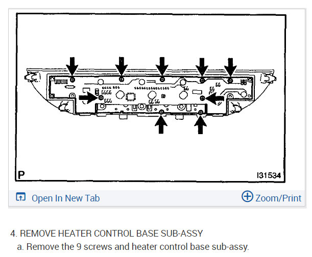

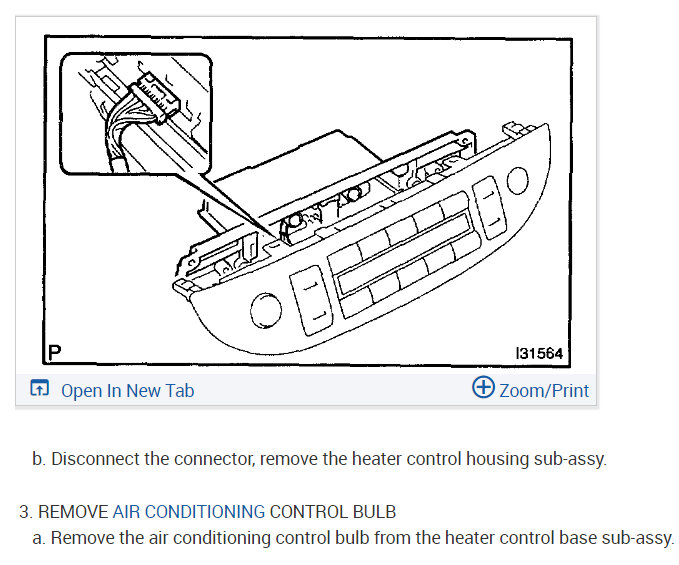

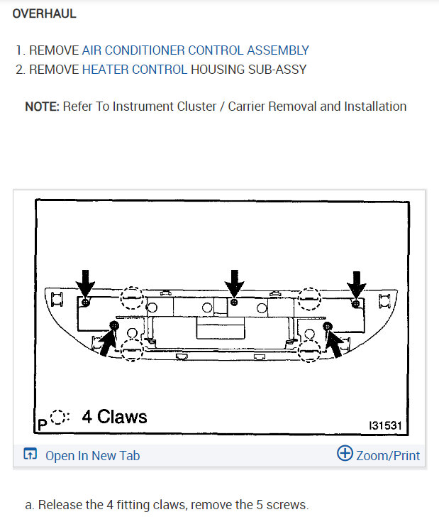

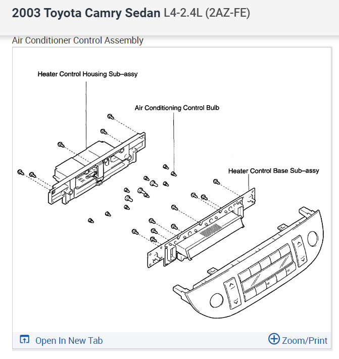

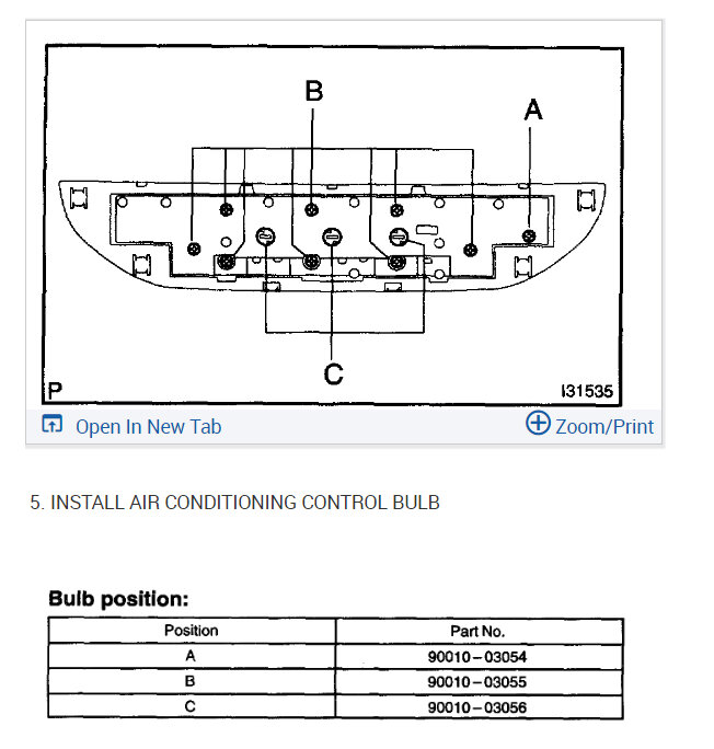

  • 55,691 POSTS
To me it sounds like the controller has gone bad, you should run the codes using a CAN scanner to confirm. You can get a CAN scanner (Controller Area Network) which will work on most cars from Amazon.
https://youtu.be/u-4syLc-ifQ
Here is how to change the controller out in case a code is stored for it. Check out the images (below). Please upload pictures or videos in your response to the problem so we can see what's going on.
