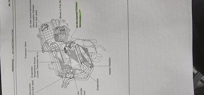

I looked at the diagrams and only see 3 servos. See image below. When you removed the servos did you manually check the blend doors to make sure the move to both directions? Also if you are able to retrieve the codes post then so we can review them.

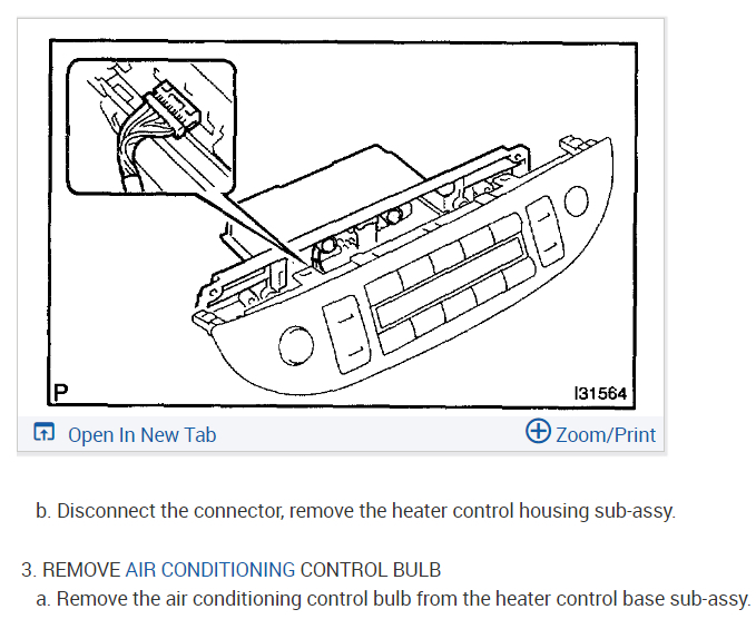

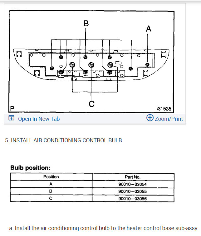

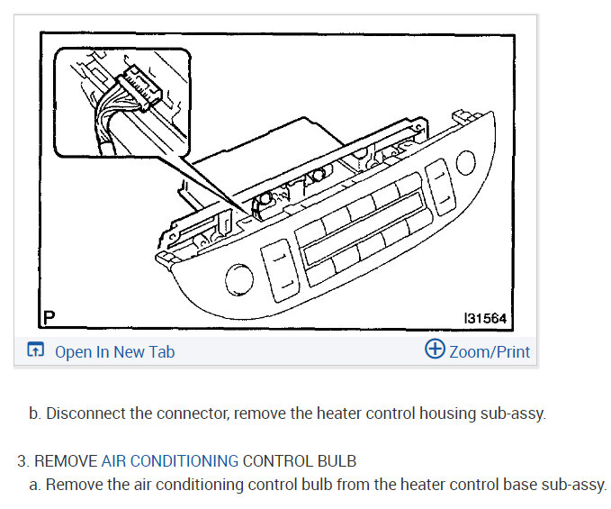

  • 55,398 POSTS

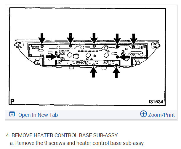

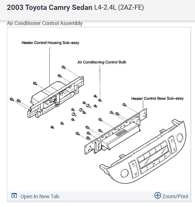

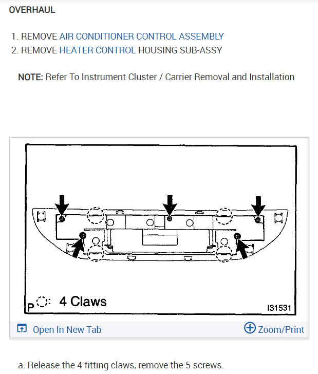

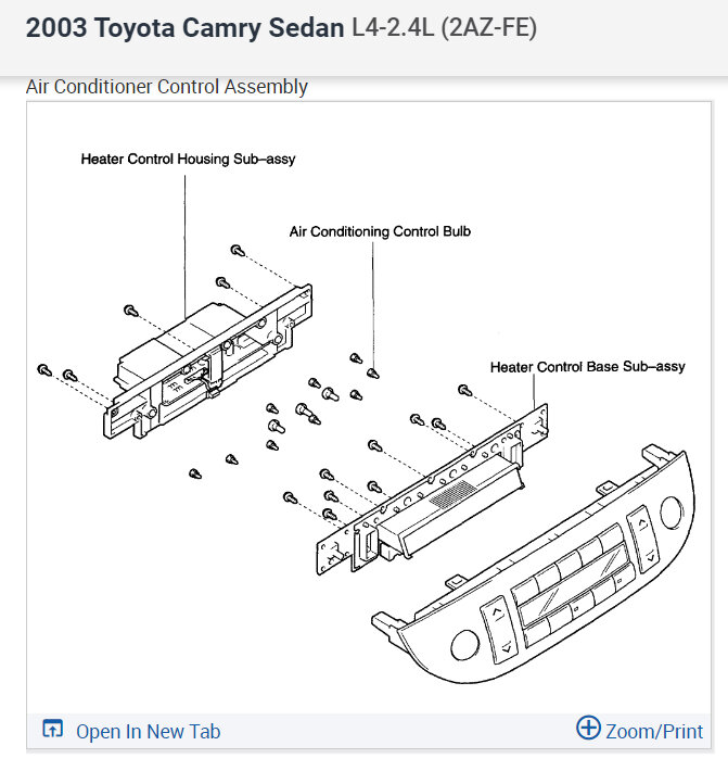

To me it sounds like the controller has gone bad, you should run the codes using a CAN scanner to confirm. You can get a CAN scanner (Controller Area Network) which will work on most cars from Amazon.
https://youtu.be/u-4syLc-ifQ
Here is how to change the controller out in case a code is stored for it. Check out the images (below). Please upload pictures or videos in your response to the problem so we can see what's going on.
