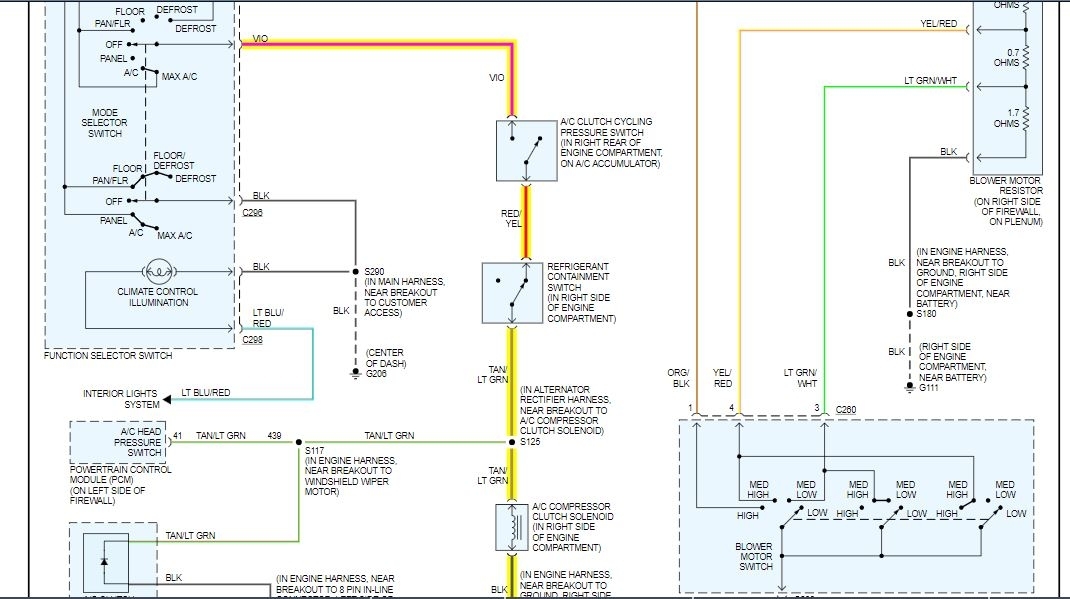

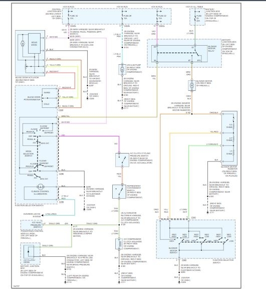

A/C not working. vacuum was replaced. system pressure is good, no leaks. so with clutch not engaging. what could it be a switch or relay?
Jun 7, 2019 at 8:35 AM
Good evening,
Can you give me the pressures on both the high and low side? I need those readings.
I will attach a wiring diagram for you to view.
