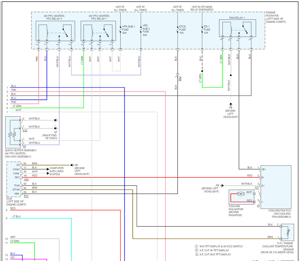

A/C works while driving fine when you're at an idle the A/C compressor turns off and the radiator fan does not work, only with the A/C at idle. My car does not overheat. The only thing i noticed is the A/C pressure goes up and the compressor turns off because the fan does not come on the cool the cond. down.
Jun 28, 2023 at 12:27 PM
  • 55,433 POSTS

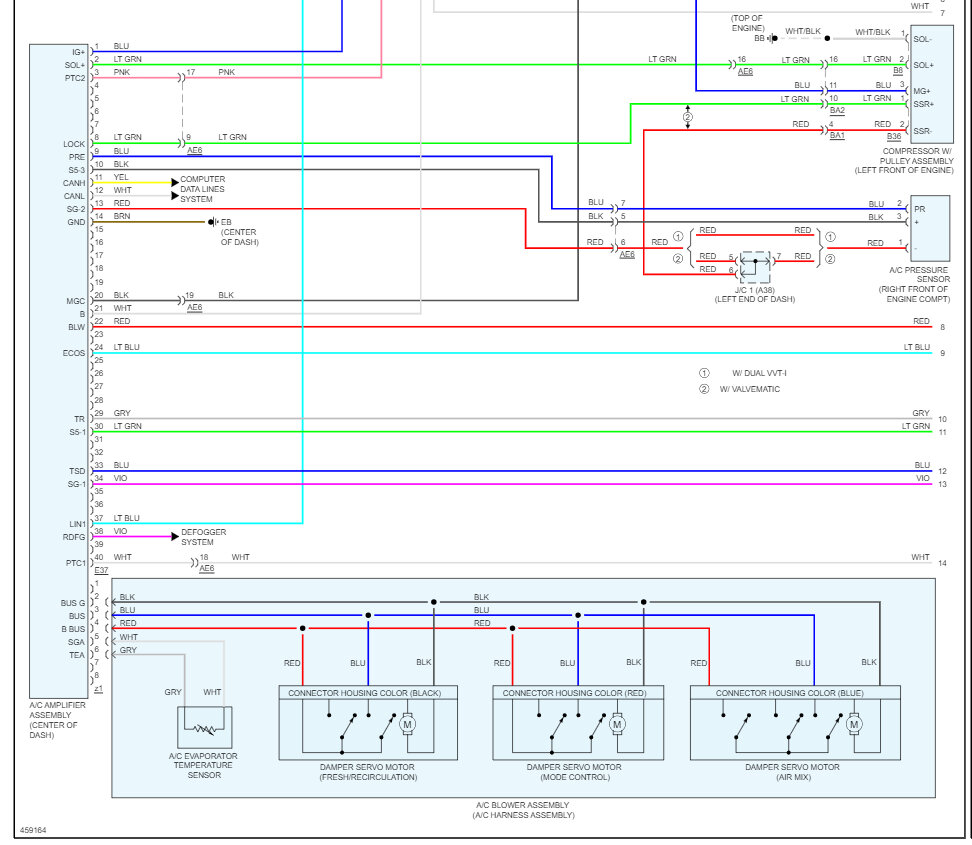

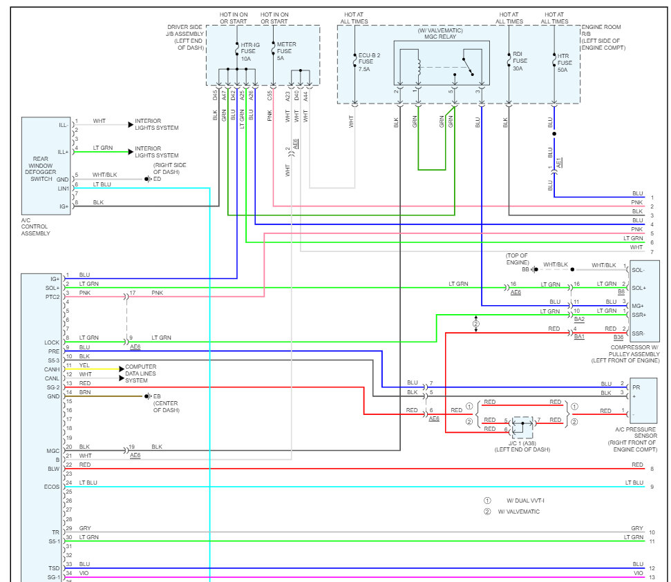

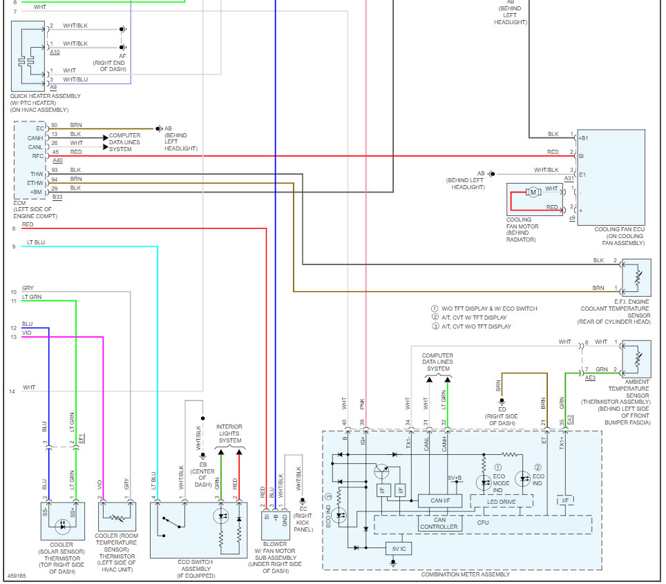

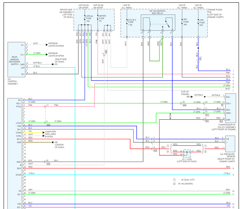

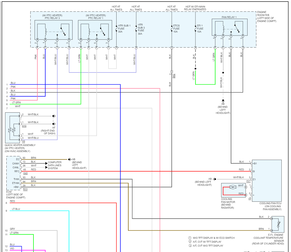

Yes, the condenser fan must run with the A/C system on so this is the problem. Here is the A/C fan wiring diagram so you can see how the system works. There are 7 fuses that run the system that we should check for power first, here is a guide to help and use the wiring diagrams to see which fuses they are.
If the fuses are okay, I would swap out the Fan Relay1 also, does the fan come on at all Check out the images (below). Please let us know how it goes.

What should the red wire on the coolant module on the radiator, because when I apply 12v to the fan motor wiring everything works okay. My radiator fan does not work but the car never overheated. Thanks
Jun 29, 2023 at 11:42 AM
SUDESH HARINARINE
what should the voltage be on the red wire?
Jun 29, 2023 at 11:54 AM
  • 55,433 POSTS
That looks like a sensing wire between the cooling fan ECU and the PCM. Did you check the fuses and relays?
We should do a CAN scan as well; you can get a CAN scanner (Controller Area Network) which will work on most cars from Amazon.
https://youtu.be/u-4syLc-ifQ
Please go over this guide and get back to us.
