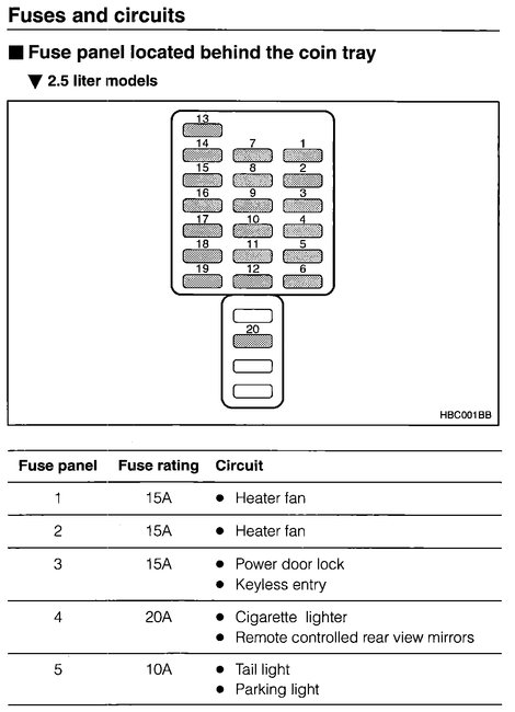

Hi there, my air conditioning stopped working. there’s no power so my fan in my motor has stopped. There’s no over heating problems yet. what could be the issue?
Dec 19, 2018 at 9:05 PM
  • 110,194 POSTS
If you are referring to the blower motor fan, I have to first ask if you checked fuses. When you say no power, can you explain what has no power?
Lets start with a possible fuse. Here are a couple links that explain how to check a fuse as well as replacement:
In the directions, it shows a multi meter and test lamp being used. Here are links that show how to use them:
____________________

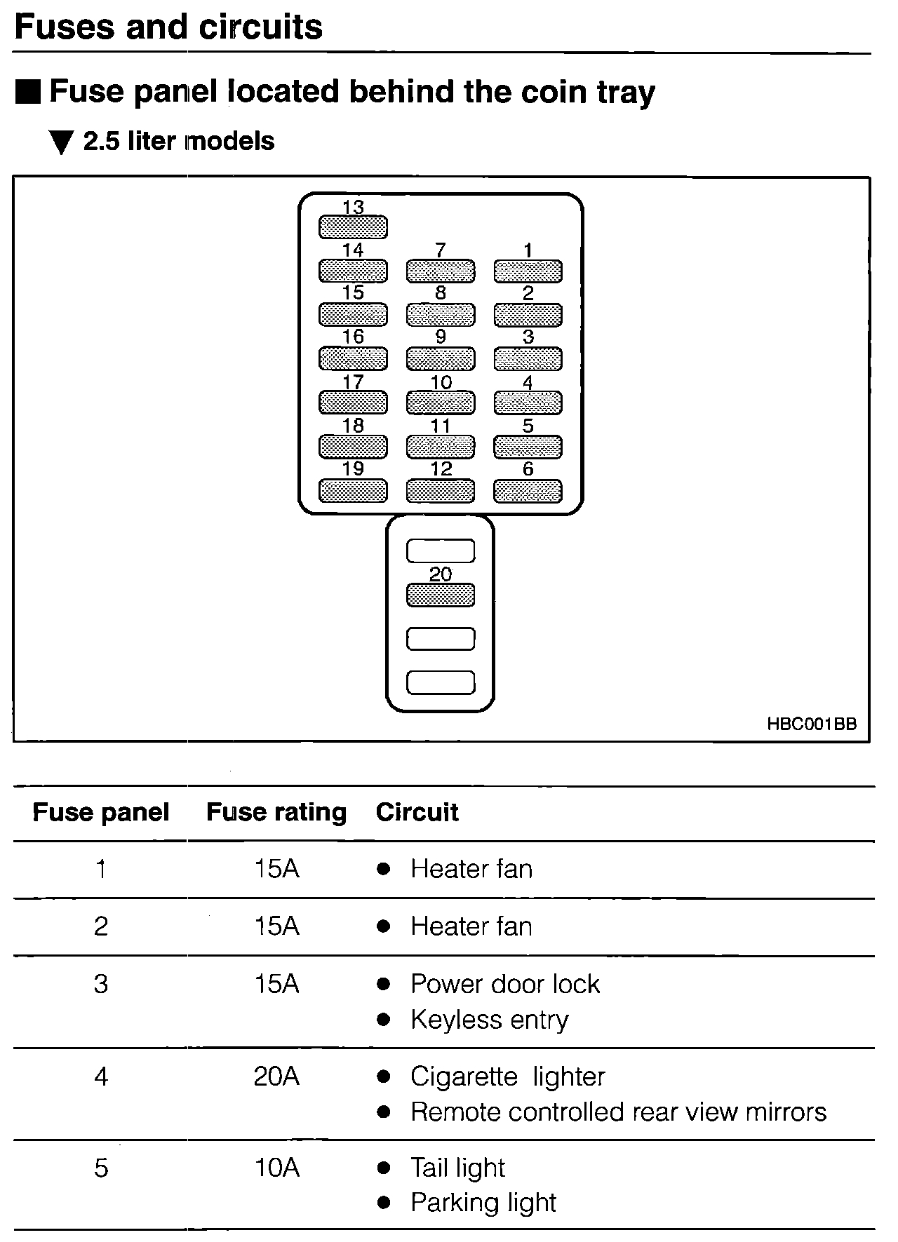

There two fuses indicated for the blower motor fan on your vehicle. They are located in the vehicle behind the coin tray. See the attached picture.
Check both fuse one and two and let me know what you find.
I hope this helps.
