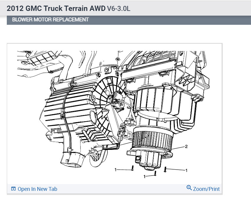

A/C and heater aren't working when i turn it on but as long as it is on and circulating from the outside and I'm driving i have a small amount of airflow. when i stop i have nothing. Before it started this i was experiencing a knocking like sound when i would turn it on, and the pressure of air coming out of the vents would fluctuate even when it was on high.
Oct 6, 2022 at 1:34 AM
  • 55,721 POSTS

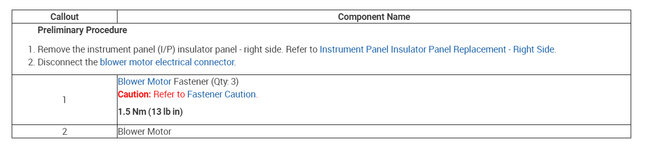

This sounds like the blower motor needs to be replaced. here is the location of the blower motor and a generic guide to help you test for power and check the ground. Check the images below.
https://www.2carpros.com/articles/blower-fan-motor-works-on-high-speed-only
