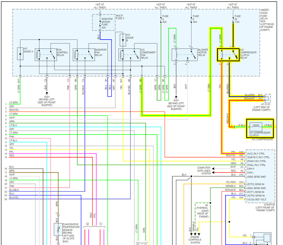

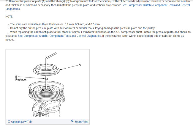

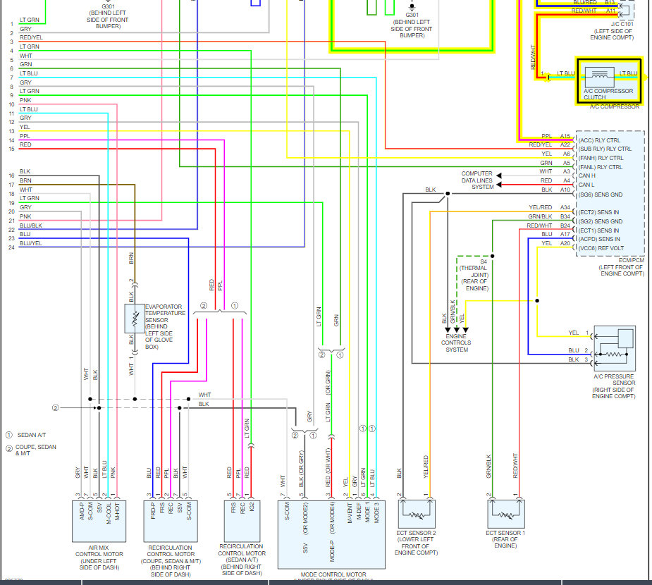

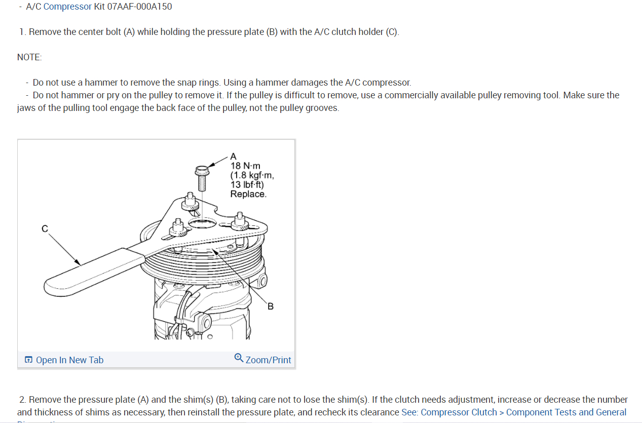

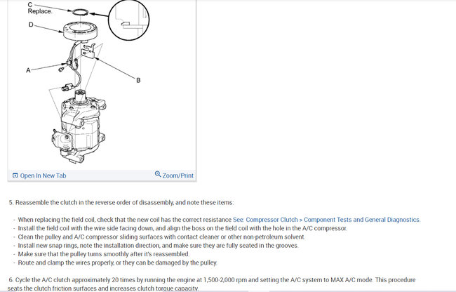

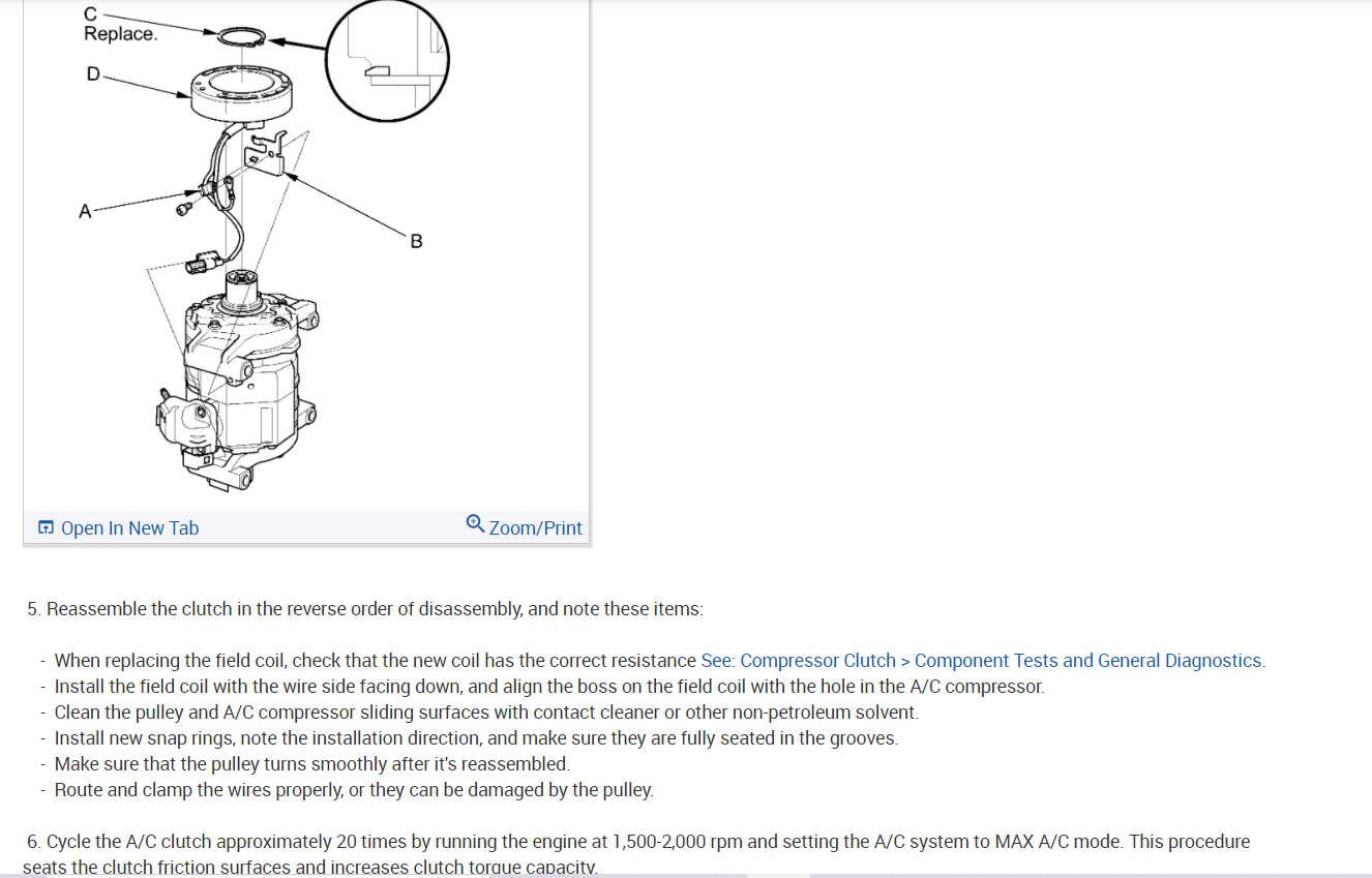

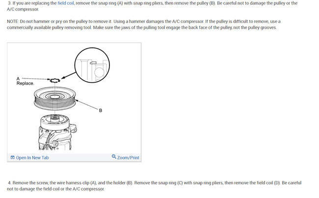

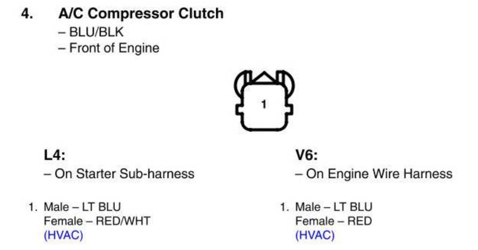

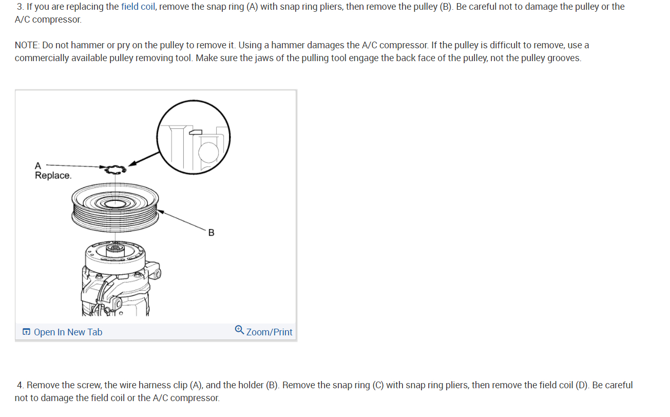

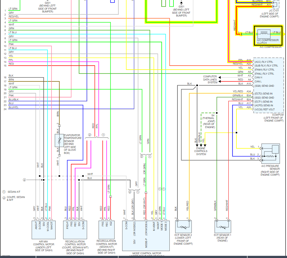

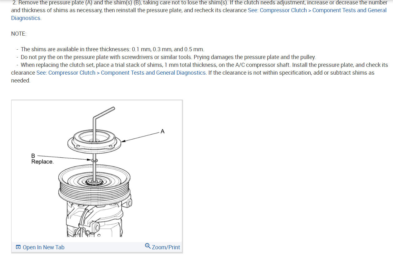

Replaced Stator assembly on the clutch, next day it was open circuit. Anybody have electrical drawing around that component, and ideas of where to look for a problem?
Apr 12, 2021 at 9:26 AM
Good evening,
I attached the procedure for the clutch replacement and a wiring diagram for you.
Check and see if you have voltage to the clutch for it to work.
Apr 12, 2021 at 9:41 AM
RYAN.TIM.J
  • 57 POSTS
Thanks for the help. Appears to be a compressor issue, selling the car.
