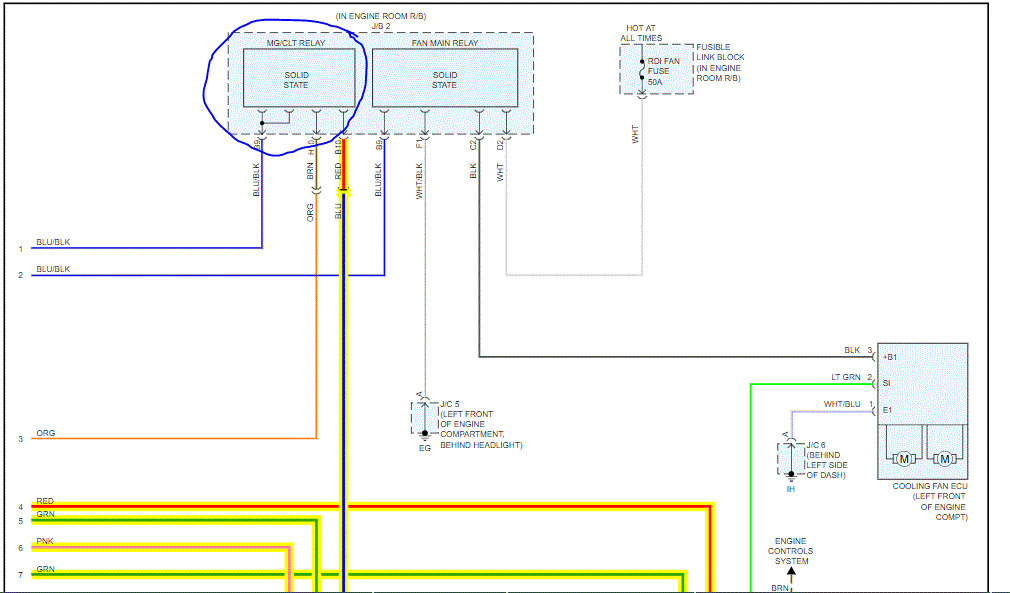

A/C started failing recently (sometime it works, other times it does not).
Now it just blows warm air out, not cooling any more.

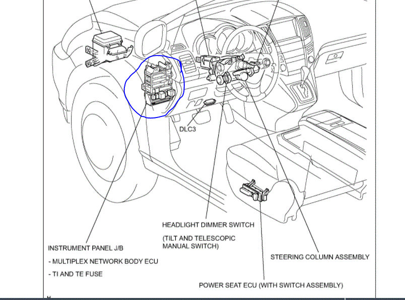

I heard there was a problem related to the A/C relay. But I can't locate the relay (it is not in the fuse box).
Do you know where the A/C relay is located for this particular model ?

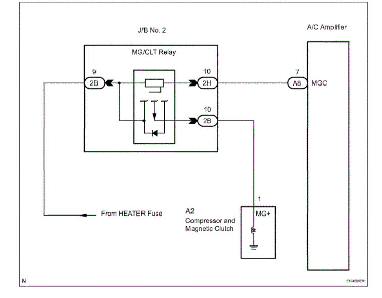

The relay is part of the junction box under the dash on the left side. The controls are multiplex which means serial data. That is not something you measure with a voltmeter.
You need a full scan tool to monitor the system and see if you can activate the clutch from the scan tool.

I started with the relay for the following reasons,
1) In the lexus owner online community there are talks that the relay was an issue early (causing similar problems I have) and lexus even issued an notice. It is a relatively quick fix (if that is the reason).
2) The A/C was fine before and there is no "white fog" as described in the link which indicates a lower Freon pressure.
I located that fuse box you indicated in the diagram. But it is behind the cover under the dashboard. Is there video showing how to remove the cover to get access to the relay ?

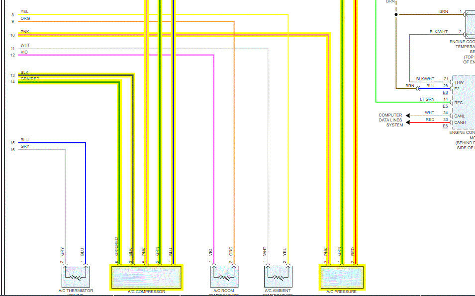

Okay, that relay is not something you replace. It is a solid state relay built into the fuse block.
You would need an advanced scan tool to see if the commands are being sent and the compressor is engaging.
Anyway, the first thing to do is the pressure testing of Freon. My bet is there is no Freon in the system from a leak.
