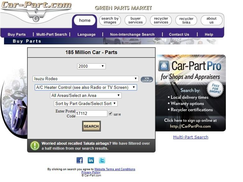

The part is called a control head or just control with AC.
I found tons of them on the web site I use all the time.
http://www.car-part.com/cgi-bin/search.cgi
May 12, 2018 at 8:13 PM
RODEOOWNER
  • 11 POSTS
Roy, I could not see the part in your link as it told me to search again but is it just the visible part on the dash with all the controls? LOL! I was making it too hard! :)
May 13, 2018 at 2:55 AM
Sorry, it is the AC control as it is listed.
Start at the beginning with year make model and part number. Then add your zip code and it will show parts in your area.
