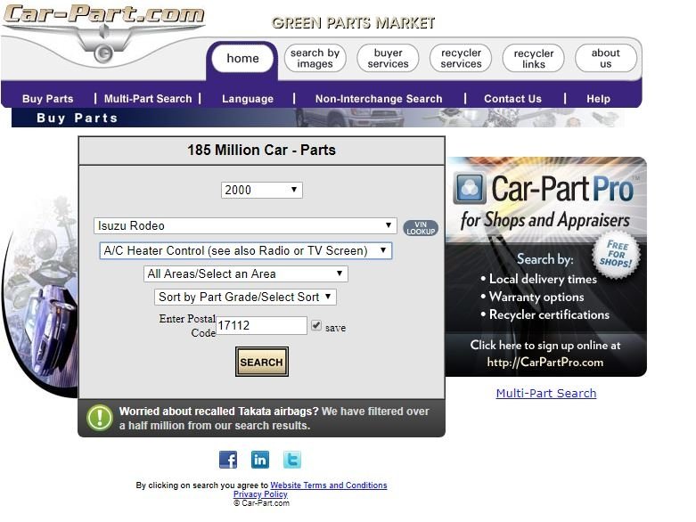

Okay, I took the Isuzu to another air conditioning place. He said he believes it is the head unit for the controls for the climate control and to buy it on eBay which would cost around $40.00 to $50.00. I can find nothing that is called "head unit". Does anyone know what he is talking about?
Under the hood is fine but the control to make the compressor kick in is defective.
Saturday, May 12th, 2018 AT 8:37 PM
  • 52,797 POSTS
The part is called a control head or just control with AC.
I found tons of them on the web site I use all the time.
http://www.car-part.com/cgi-bin/search.cgi
Sunday, May 13th, 2018 AT 3:13 AM
RODEOOWNER
  • 11 POSTS
Roy, I could not see the part in your link as it told me to search again but is it just the visible part on the dash with all the controls? LOL! I was making it too hard! :)
Sunday, May 13th, 2018 AT 9:55 AM
  • 52,797 POSTS
Sorry, it is the AC control as it is listed.
Start at the beginning with year make model and part number. Then add your zip code and it will show parts in your area.
Sunday, May 13th, 2018 AT 12:21 PM
