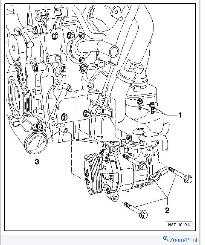

This usually happens because the compressor seal are going out and only pump enough Freon at higher engine speeds. Here is a guide to help you see what you are in for when doing the job with diagrams on how to do the job on your car:
https://www.2carpros.com/articles/replace-air-conditioner-compressor
and
