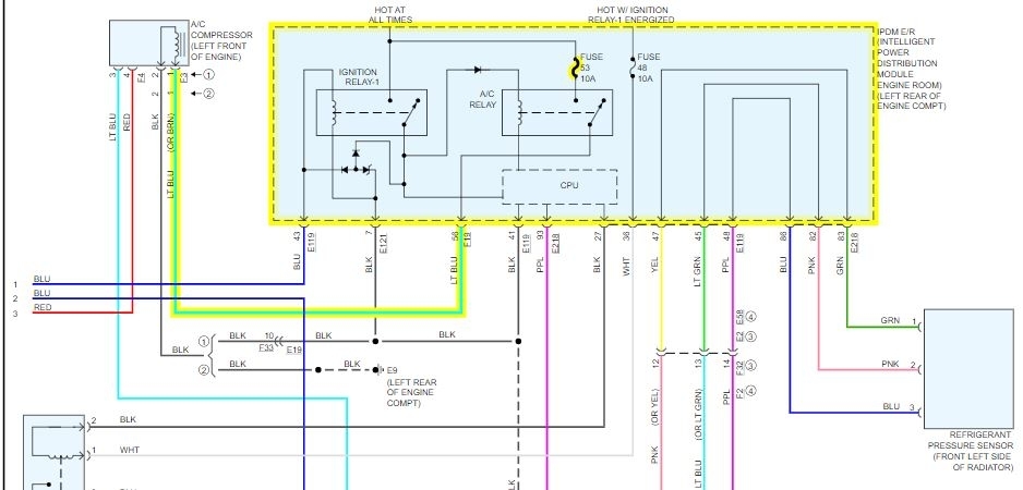

A/C Stopped blowing cold air, Freon is full. We cannot find the AC relay. Where is this located?
Aug 8, 2019 at 7:10 AM
Good afternoon.
What are the high and low side pressures?
Is the compressor engaged?
Any previous work done?
The relay is built into the fuse block which is a module.
Aug 8, 2019 at 7:42 AM
VSILVA525
No previous work done. The compressor is not engaged. The belt is good it's turning the compressor but it's not engaging.
Aug 8, 2019 at 8:28 AM

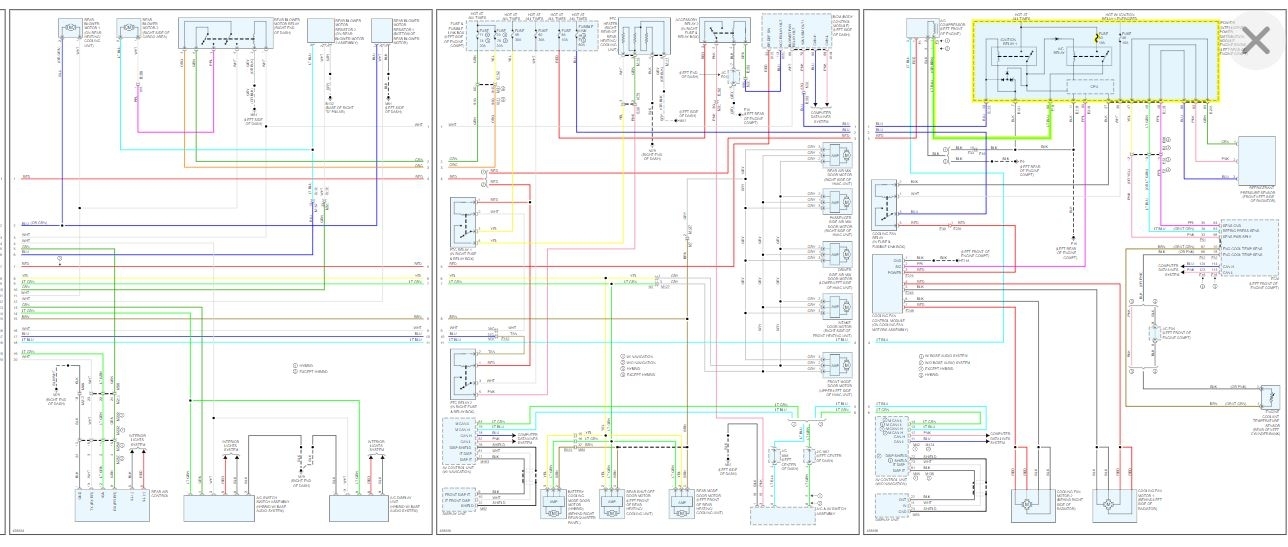

Okay, check the fuse listed for power.
I attached a wiring diagram for you to view.
check for power to the compressor when you command AC.
I still need the pressures from my previous question.
Aug 8, 2019 at 8:48 AM
VSILVA525
Okay, I'm working on getting the pressures. But in which fuse boxes the relay? It is not showing any fuse or relay on the 3 fuse panels that the truck has.
Aug 8, 2019 at 9:33 AM
Again there is no relay for you to find. It is part of the module. In the diagram, it shows it but it is part of that unit and not serviceable.
Let me know the pressures.
