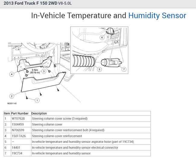

When outside temperatures get above 75 degrees my A/C will only blow luke warm air. If it is under 75 degrees it will start blowing cold again.

It sounds like the system is a little low on refrigerant or you have a programming issue. I would check the low side pressure by following this video.
https://youtu.be/4EqdrBVb0sY
and
If the pressures seem okay, I would try resetting the HVAC system by following this guide:
https://www.2carpros.com/articles/step-by-step-guide-to-reset-your-cars-hvac-system-an-essential-for-every
If that doesn't work, we need to do a CAN scan which will go over the HVAC system, you can get a CAN scanner (Controller Area Network) which will work on most cars from Amazon.
https://youtu.be/u-4syLc-ifQ

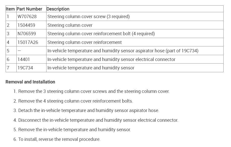

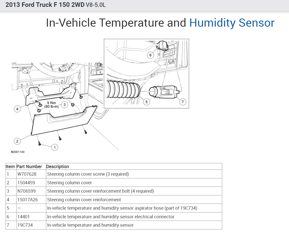

Please go over these guides and get back to us because it might be the temperature sensor. Check out the images (below). Please let us know how it goes.
