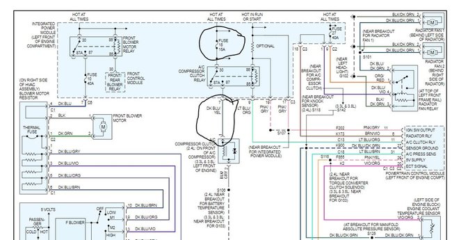

No fault codes. No blinking lights or indication of a fault. I ran calibration test. No blinking lights or fault codes after. I ran cool down test. Also no blinking lights or fault codes. At the end of cool down test the compressor light was turned off.

Do you have a set of gauges to test the high and low side pressures? I want to see the pressures.
Also, does the compressor come on when turning the AC on?
Check the fuse listed in the diagram I attached for power on both sides.

Thank you for your reply.
I took the car to A/C service. They did not find faults or leaks.
Recovery got 150g refridgerant and 16g of oil out. ( 5,2911oz and 0,56oz )
Vacuum took 22 minutes to 0 bar, and 4 minutes to 10 mbar ( 0,145038 psi)
27 g oil was put in ( 0,95 oz)
5 g of dye ( 0,8 oz )
960 g of refridgerant ( 33,863 oz)
P.HP 12.0 bar (174,045 psi )
P.LP 1,8 bar ( 26,1 psi )
T.s. 5.0 C ( 41 F )
T.u 22.0 C (71,6 F )
I fear the same could happen again. And would like to know how could I spot the fault as it happens. Or if there is nothing I can do to help diagnose possible recurring fault.
Thank you :)
Jul 29, 2019 at 12:28 AM
OK, since you added the dye, keep an eye out for any leaks by using a good bright LED flashlight. It will glow green or yellow depending on the dye you are using.
