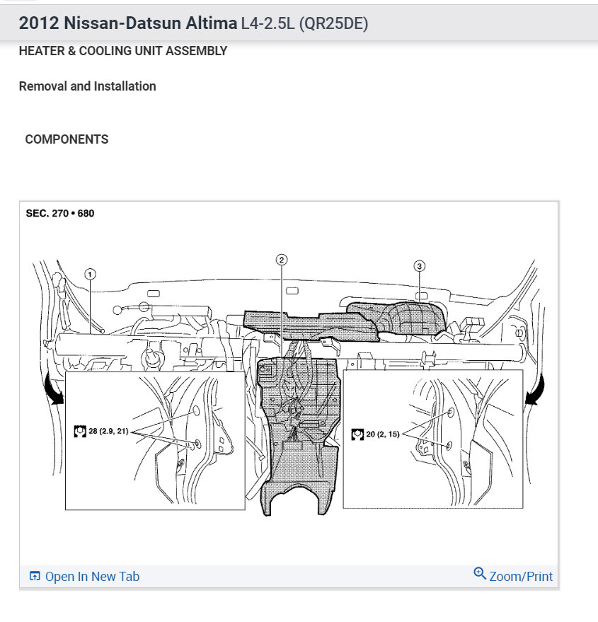

Where is the A/C Mode Actuator Motor located and how to remove it?
2012 NISSAN ALTIMA
120,000 MILES • 2.5L • 4 CYL • 2WD • AUTOMATIC
RGLOSTER
Also, what is the correct part number?
Dec 5, 2022 at 7:59 PM
  • 55,433 POSTS

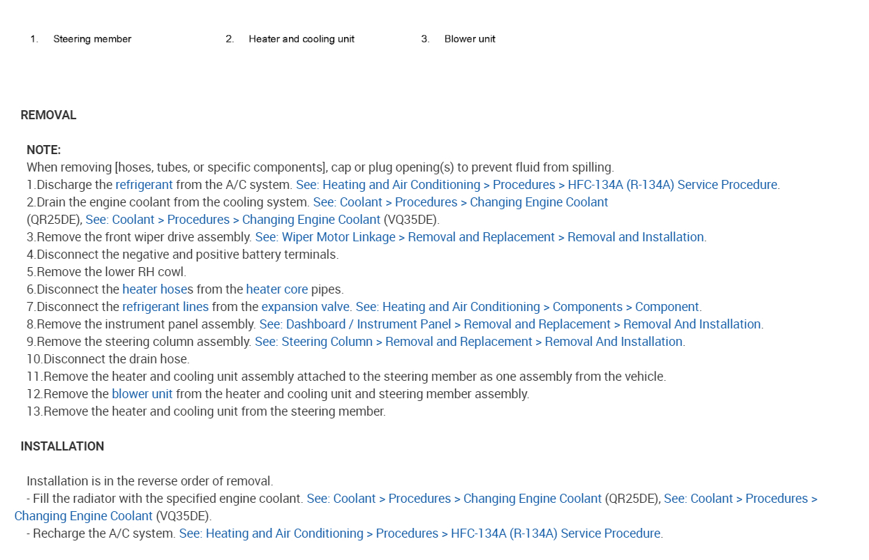

It looks like the mode actuator is part of the HVAC plenum so that's no fun. Here is how they say to change it.
Mode Door Actuator
Removal and Installation
The mode door motor is part of the heater and cooling unit assembly and is replaced as an assembly. Refer to
See: Housing Assembly HVAC > Removal and Replacement > Removal and Installation.
VTL
Check out the images (below). Please let us know what you find.
