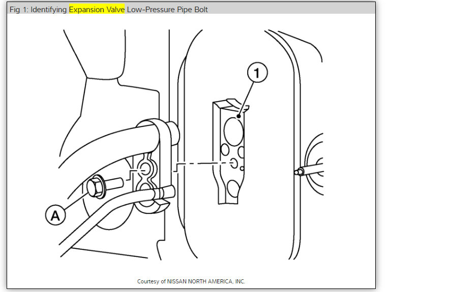

A/C takes fifteen minutes to blow cold air on and off. Manifold shows Low: "Retard" - High: 145. Already replaced condenser and compressor.
What could be the issue and how can I test it?

The low side should be 25-30 rock solid, no variation.

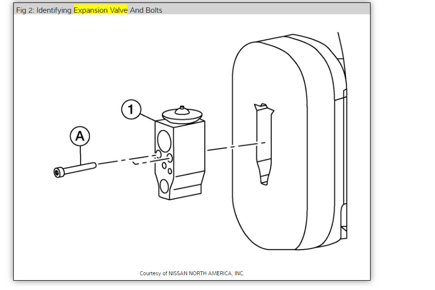

It looks like you need the expansion valve. That is what controls the low side pressure. When it fails, it will put the low side into a vacuum.
You need to recover the Freon, remove the low side manifold nut at the firewall and then the two bolts securing the valve to the evaporator.
You will need to replace the receiver/dryer as well since you did not at the prior repair.
