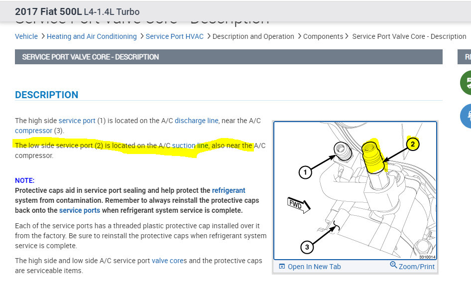

Hello, I am trying to find the low-pressure recharge port on the vehicle listed above pop, but I cannot find it. I only found 2 ports, one that's a mystery port right on the compressor or something close to it and the other that's the high-pressure port. I have tried googling it but nothing of use has shown up. I posted this earlier, but it put it in engine oil (for some reason), so I am trying this again and praying it's in the right category this time.

I thought I recognized this vehicle. LOL As far as the low-pressure port is concerned, it is also near the compressor on the suction line. The suction line is physically larger in diameter than the high pressure.
If you look at the pic below, I highlighted the one you need.

It's all okay now, I ended up finding it myself behind the engine cover pretty much on the compressor or such.
