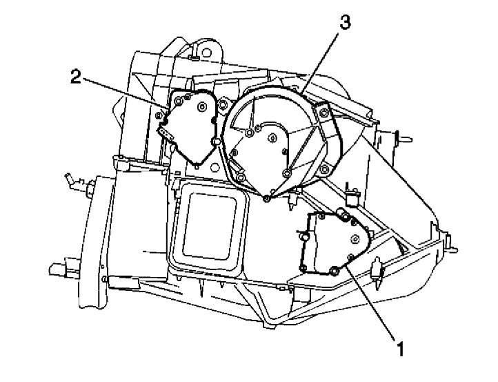

Okay, so I was going to record a video but it wasn't doing it anymore, but now the compressor runs just fine but still blow hot air. When you turn it on the RPM gauge goes down then goes back up. Like it lost a little power.
Sep 9, 2019 at 2:36 AM
Okay, I still need the pressure to make sure the system is working correctly.
It could also be the blend door actuator if the A/C is working correctly.
